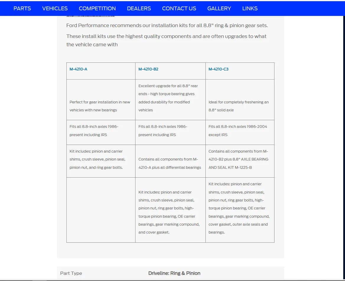

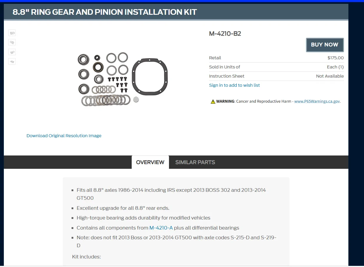

Looks like American Muscle has 4.09 and 4.11 kits listed for the 15-26 Super 8.8 IRS; odd Brenspeed has no listing. The FRPP info below is conflicting. Yes not having the cats on an easily swappable midpipe is annoying. TY
S650 Mustang Anyone running 4.09/4.11 with the MT82? Screenshot (402)
S650 Mustang Anyone running 4.09/4.11 with the MT82? Screenshot (404)
