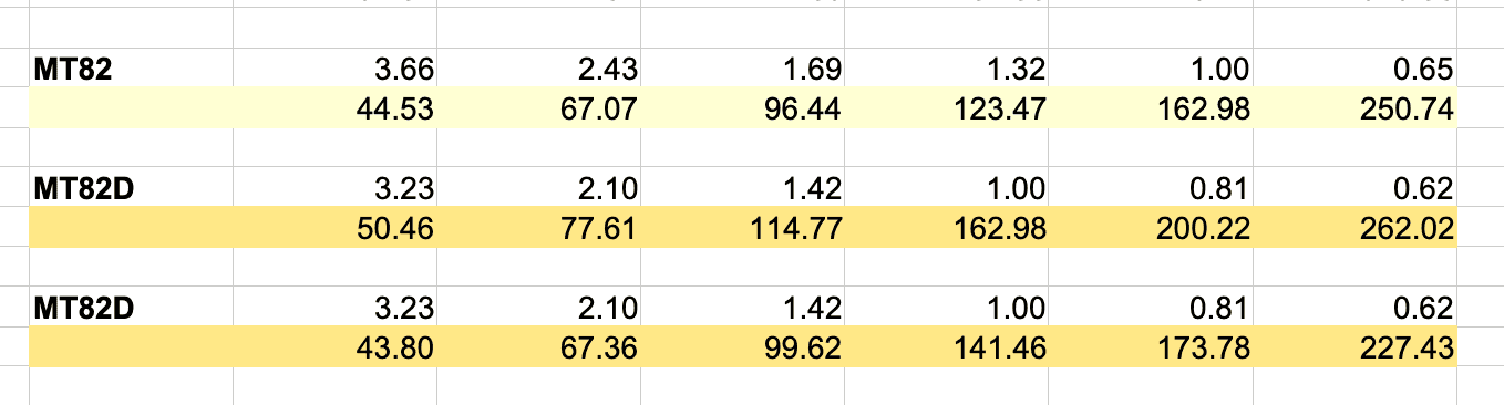

3,031
3,022
Pretty much brings things back down to the old MT-82 ratios
First two are 3.55, last one is 4.09
It does lower your 4th (1:1) gear top speed from 160 to 140 though. the 3-4 is going to kind of suck like it did with the old wide ratio t56
Would like to hear from supercharged S550 owners if moving to 4.09's is worth it or not
(chart shows gear ratio and mph @ 7200rpm so add a couple mph to get say, mph @ 7500rpm)
I see how that would be beneficial. Didn't realize the ratios were so different across years.
