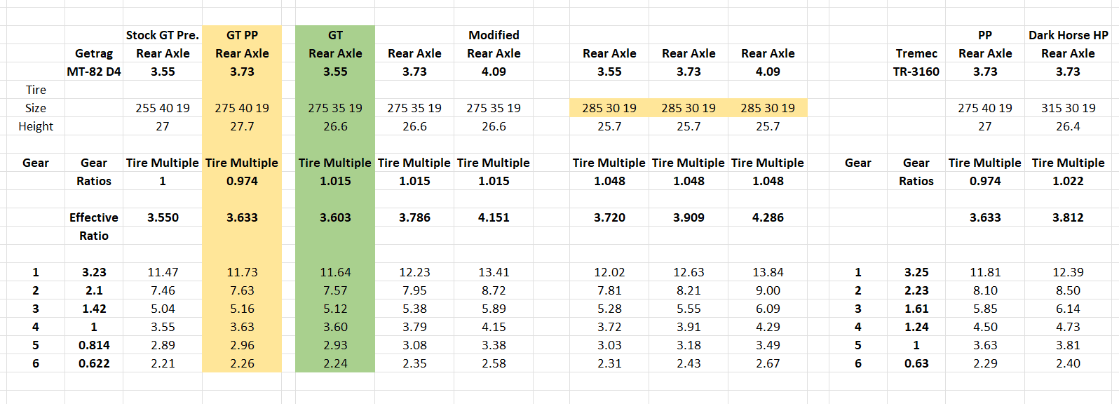

With 275/35s, ratio is 3.62

Agreed, 3.55 to 3.73 is minimal. Thats a 5% bump.
You could get close to that with slightly shorter tires.
4.09 gives you 15% extra.
THats 40 to 45lbs at 2500rpm
60lbs at peak 400 rpm
Old S550 procal would allow 4.09 gears.
I'm guessing once the S650 procal is out, 4.09 will be offered as well.
