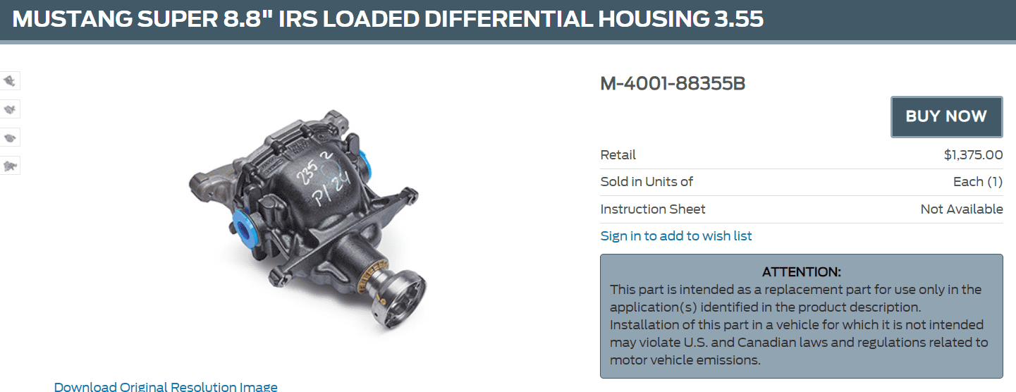

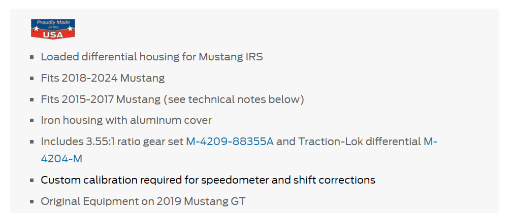

Sweet! I thought we would have to wait for tuning for that. I'm switching to a taller tire which is going to make my 3.55s worse than they already are. I'm hoping I can find someone near St.Louis that could build me a 4.09 setup if I could provide a donor or a brand new unit. I think Ford sells the 3.55 unit I already have below. I know I don't have the Torsen anyways.
