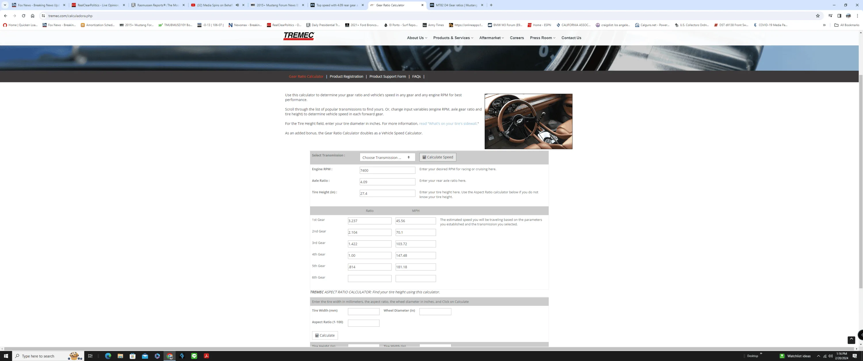

i did some quick simulation tests
4.09 diff with the 10R80 runs out of steam at ~211mph, 10th @ 7100rpm
4.09 diff with the MT-82 runs out of steam at ~209mph, 6th @ 6900rpm
4.09 diff with the TR-3160 runs out of steam at ~210mph, 6th @7000rpm
4.09 diff with the TR-3160 maxes out at 170mph, 6th @ 7500rpm
That can't be right. All three transmission have a final gear between .62 and .64 so you would expect the top speed to be nearly the same. Either the rev limiter is in place for the tr-3160 or you are using 5th gear instead of 6th gear. As a double check 2,000 RPM is about 70 miles per hour in my car. There isn't that much difference in the rear end.

i just checked and you are right, somehow i had the TR-3160's 6th gear in the simulator set to 0.829:1. the corrected test shows it runs out of steam at ~210mph, 6th @7000rpm
