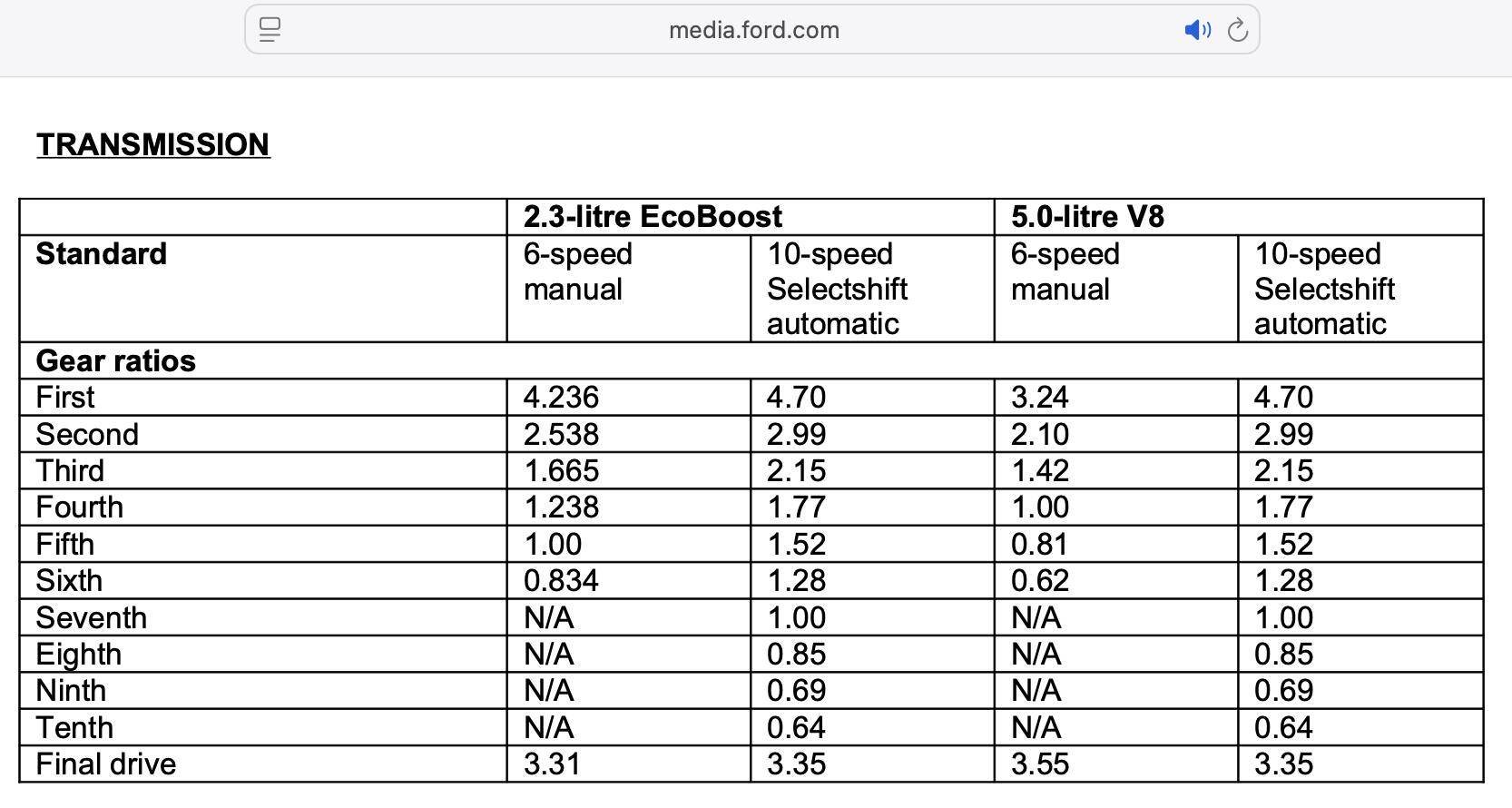

The previous Ecoboost did not get the same transmission as the Coyote, different ratios
The ratios for the V8 manual on that chart are wrong for the MT82D4. Fourth gear is 1:1, that chart is not correct.

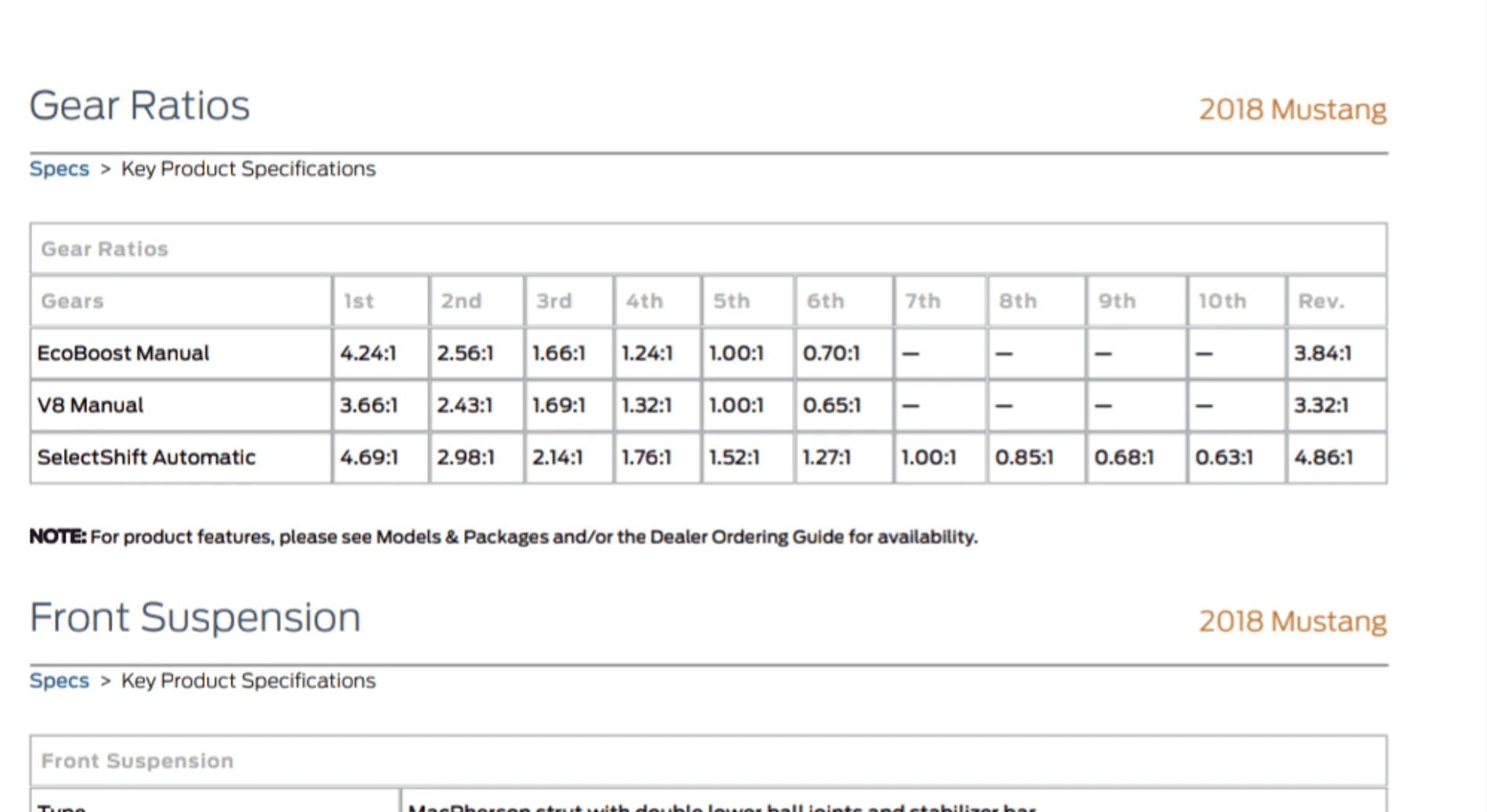

It's some random Ford document that was on the internet for the 2018 model year. The point is they aren't the same ratios between the GT and the Eco.
This one is probably more accurate.
This one is correct. I have said this once and I will say it again. The MT82D4 with a set of 4.09 gears is about perfect.
