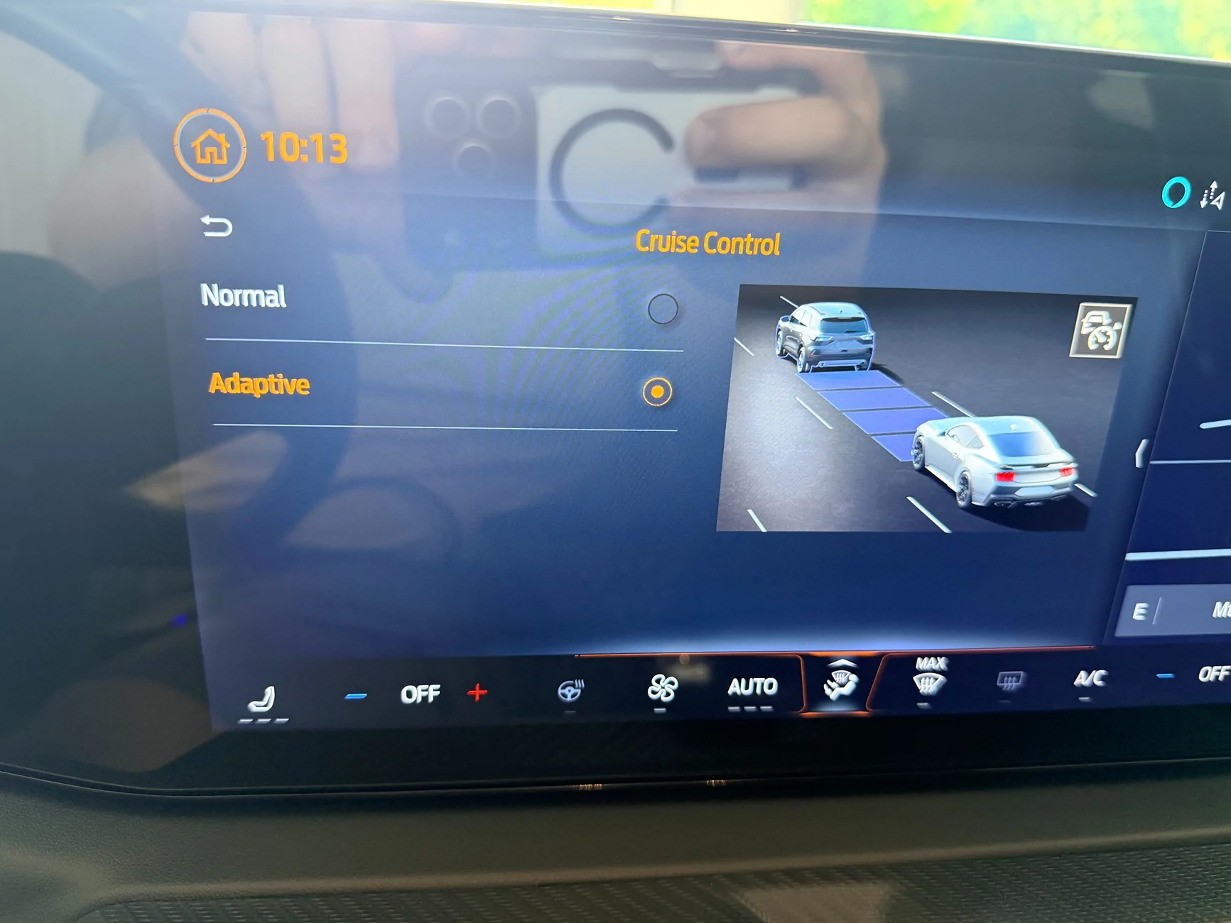

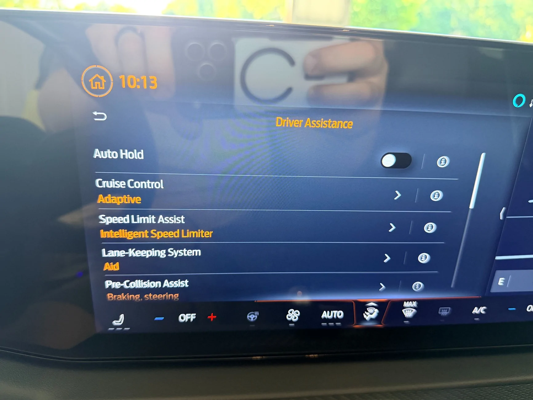

After applying all of these changes, I'm able to get the menu options to appear and toggle on and off. Cruise Control will turn on, but will not actually set and regardless of the speed I am traveling at, it only shows the posted speed limit as the speed at which the cruise would engage but with a line through it.
Despite the cruise control failing to set, lane keep assist still works; which seems a tad bit odd, but ok.

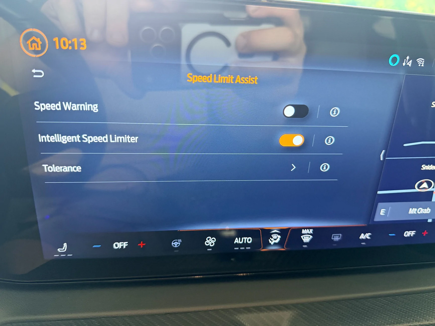

those are the exact results I had. No DTCs, everything appears to work, but cruise will not engage at any speed. I also found out if you switch to regular cruise it still would not engage. That leads me to believe it could be firmware difference we can’t change as the culprit.
however the speed limit function worked throughout.

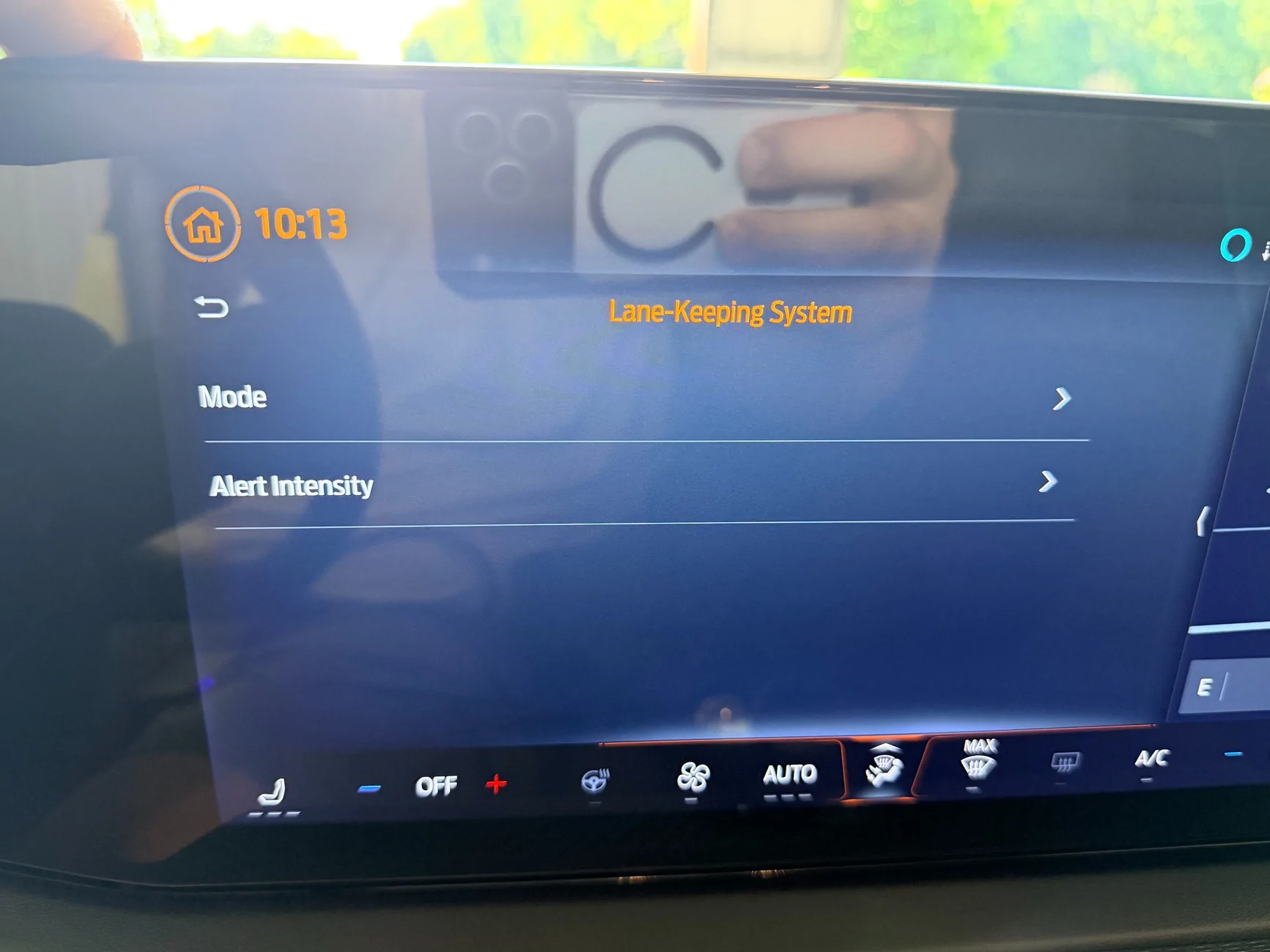

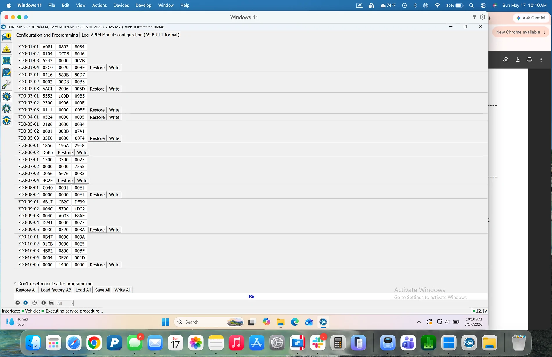

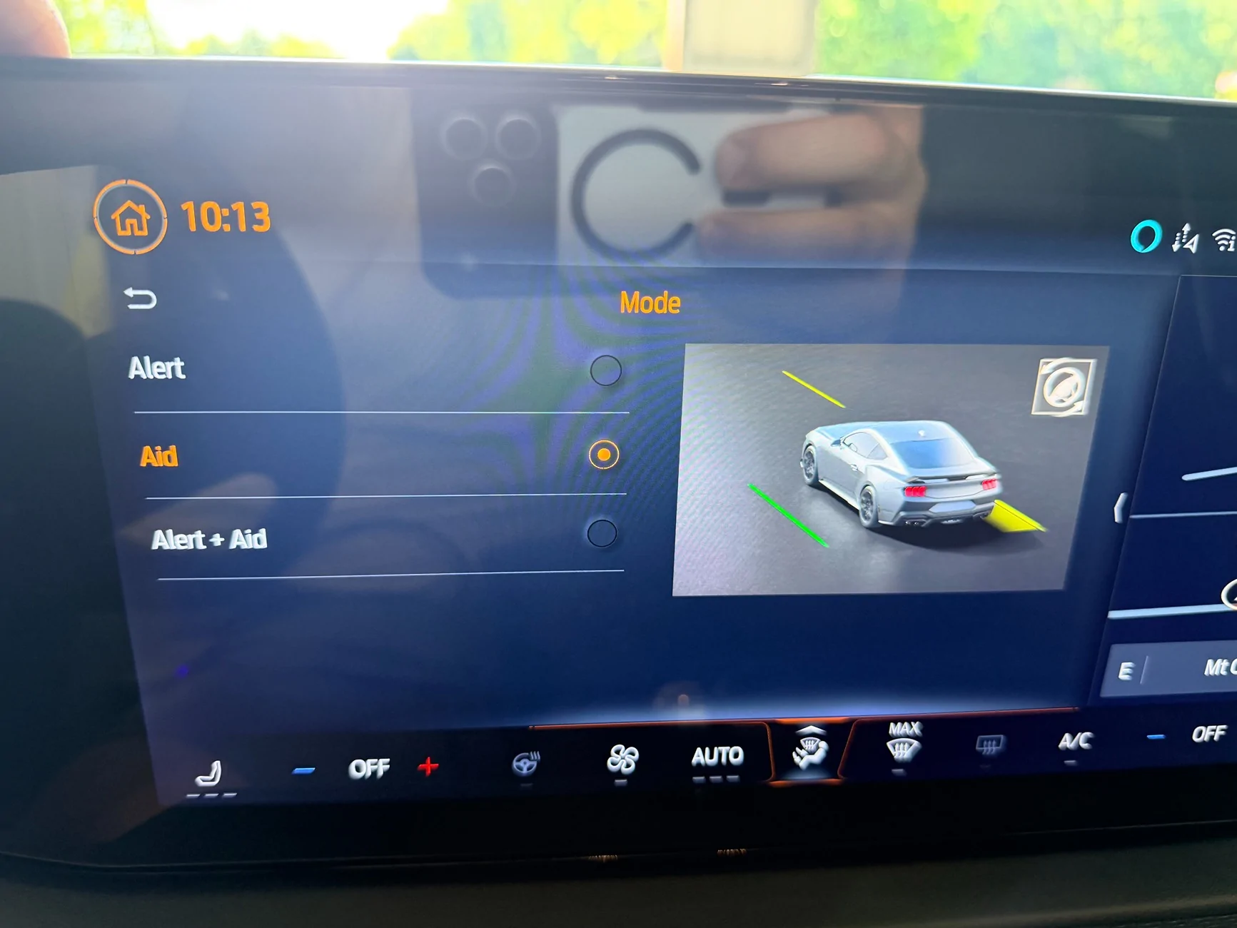

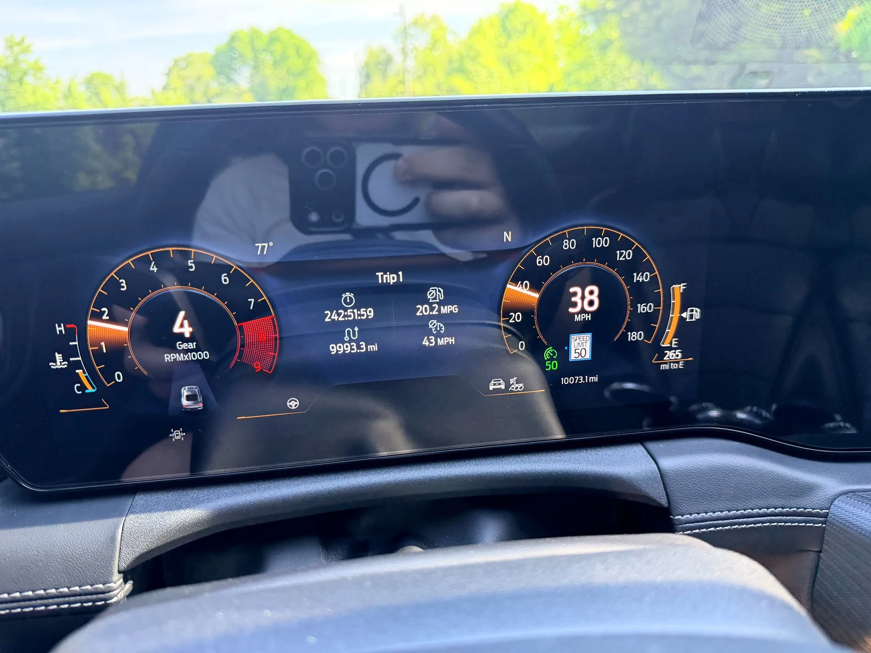

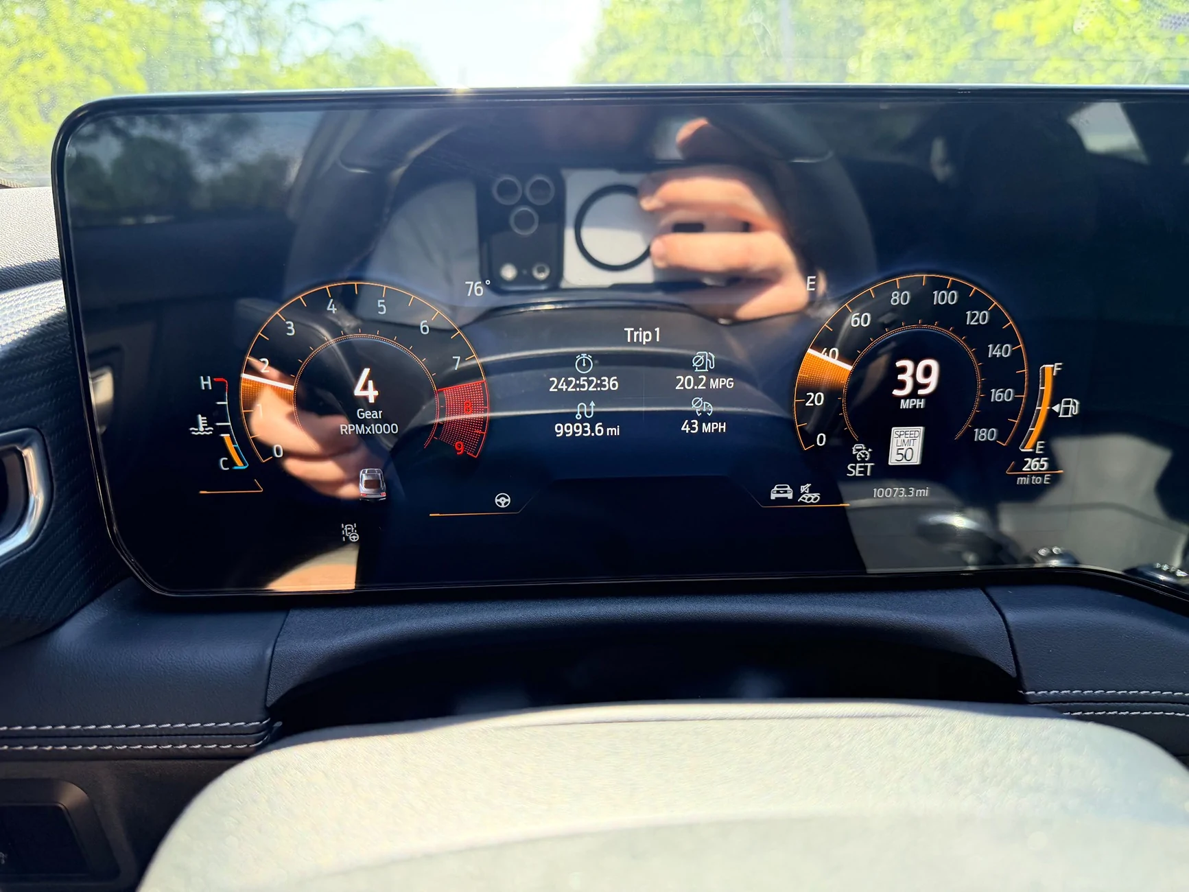

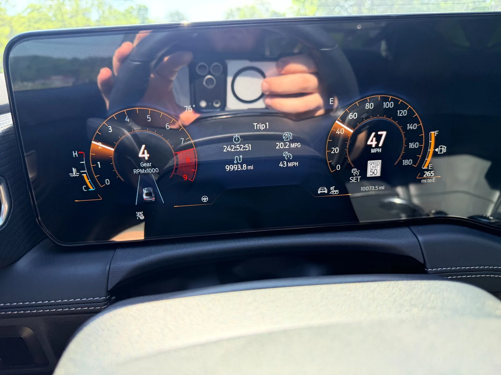

I finally got some time to play with this. Couple interesting notes on my end.
First: @Yamazuki I followed your last change list guide... as far as I could. I did not change the APIM values you listed. My APIM is certainly running on a different software version because my 3rd column of values is not 2 digits as yours was, mine is 4 digits. See attached picture. Also several of my factory values were not the same as the ones you listed. Some of them were numbers not letters or vice versa. Hindsight I should have notated which ones while I was doing it but I didn't. When I get some more time I will re-load the factory data and go through it again if anybody is curious about that part.
Second: @robotninjasrule I did not get the option in the center screen you got, in fact, my menus look totally different than yours, see attached pictures.
Even though I did not get the option in the center screen to enable lane centering, I believe it did enable it as much as it did on both of your cars. My cruise control would not set a speed, but the intelligent/speed limited cruise does work but only to limit my speed to the speed limit via the gas pedal. The car would not hold the speed limit on its own. I got the little steering wheel icon on the lane display, lane KEEP still works, but I did not get the little blue brackets in the lane. Next thing I am going to try is the APIM values from the sheet @rugedraw posted on page 5 post #65 because that is a 2025 401a car like mine and it has the 4 digit values in the 3rd column like mine. Will update once I've tried that.
Some will only post the first two digits in the third column... the last two digits in the third column are not any settings, they are checksums and will be different depending on the digits in that line, and will change on their own... so basically unimportant to the changes you are making.

Update: I tried making all three of the lines listed for the APIM the same as the 2025 401a automatic data. I now have the option to enable or disable lane centering on the center screen, however it made no other notable changes. The slider is still in a different location than in robot ninjas pictures. My menus still look like my pictures, not like his which I find interesting.
Also, @Sofa King I understand what you are saying, however it seems strange that two guys would post all 4 digits for every other module except that one, and both of them have non-premium cars. I could be wrong but between that and my center screen menus looking different, I’m inclined to believe I have a different module version or firmware
