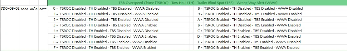

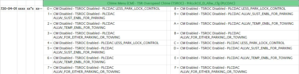

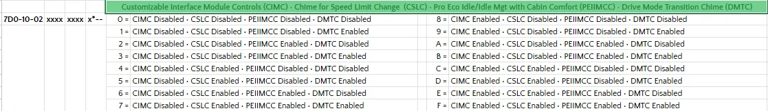

in default config it starts dinging the moment you are +1 too fast. when you continue to drive too fast it starts beeping. really loud. and at some time it stops until the next time you hit the limit.
I would check these two things in the IPC:
TSR Overspeed also needs to be disabled in the APIM:
In the APIM, there is also a setting for a chime when there is a speed limit change that can be disabled.
I would just turn all that crap off, but that's just me.
