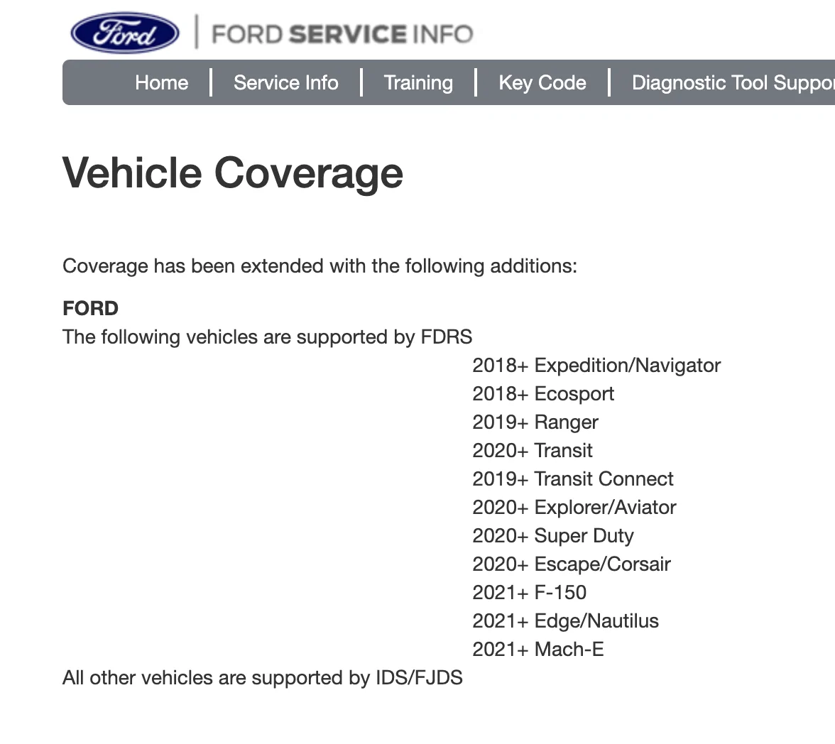

@rugedraw I was looking into FDRS in case I need it for this, and according to the motorcraft service website, the mustang is not covered by FDRS, it is covered by IDS/FJDS. Is that easier to work with than FDRS as far as the things you mentioned?
FJDS and FDRS is the same thing. FDRS will 100% work on your car.
