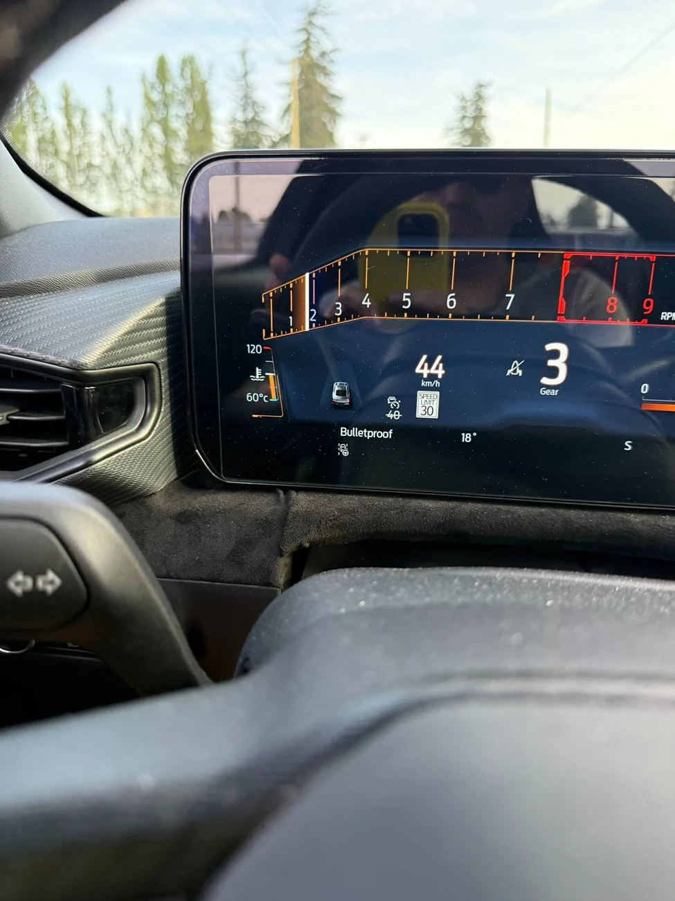

Background: 301A GT PP manual with Adaptive Cruise I retrofitted no DTC’s been working for over a year without problems.

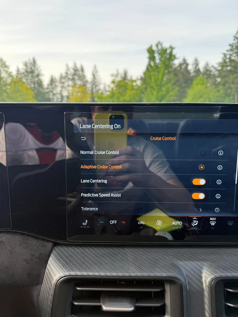

Ok guys, going to try to articulate where I am at with this the best I can.

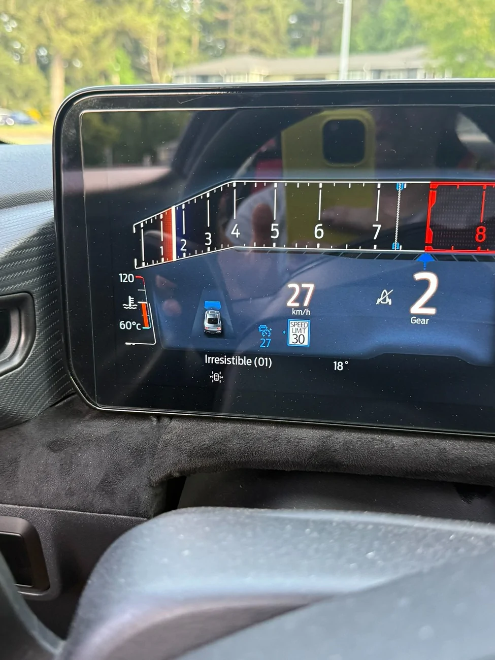

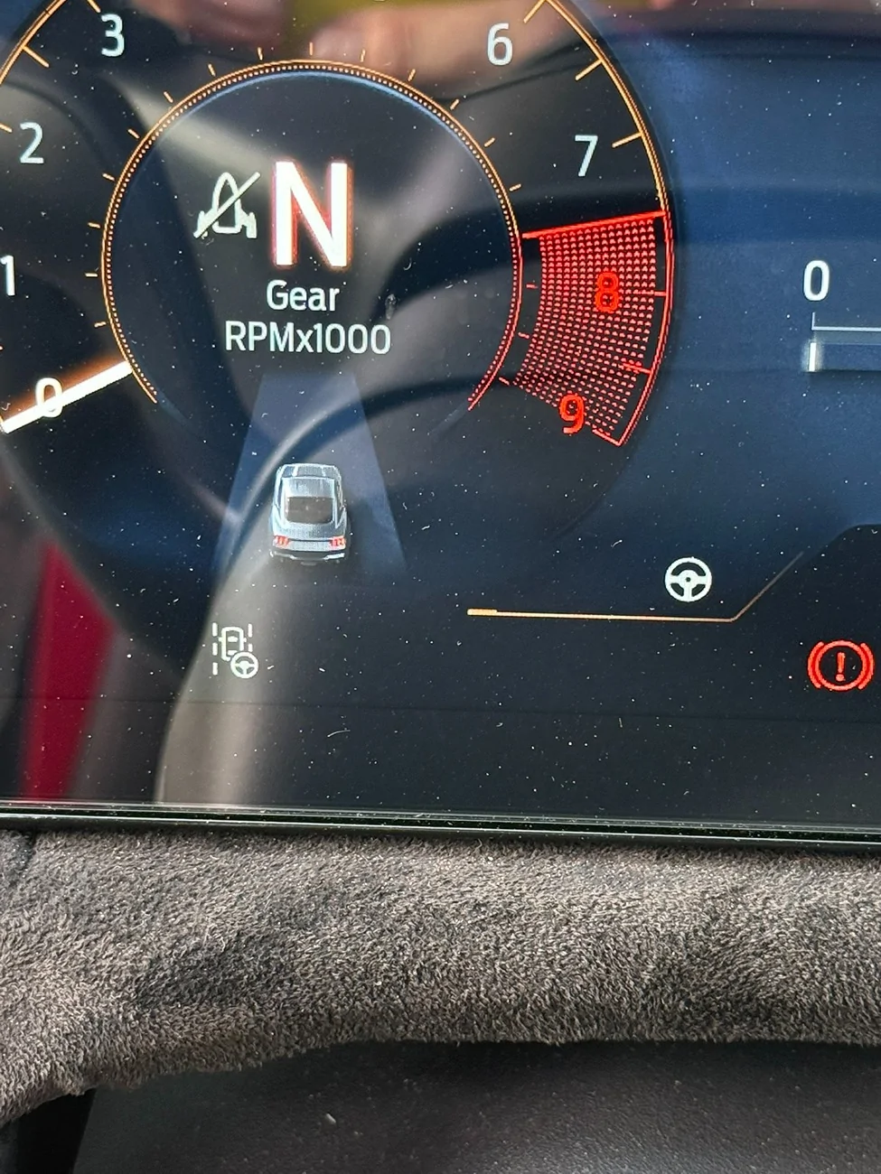

Good news I have no DTC’s and I have the proper Lane Keep Assist (LKA) Lane centering icon on the Instrument cluster Pic 1, Center screen shows lane centering enabled.

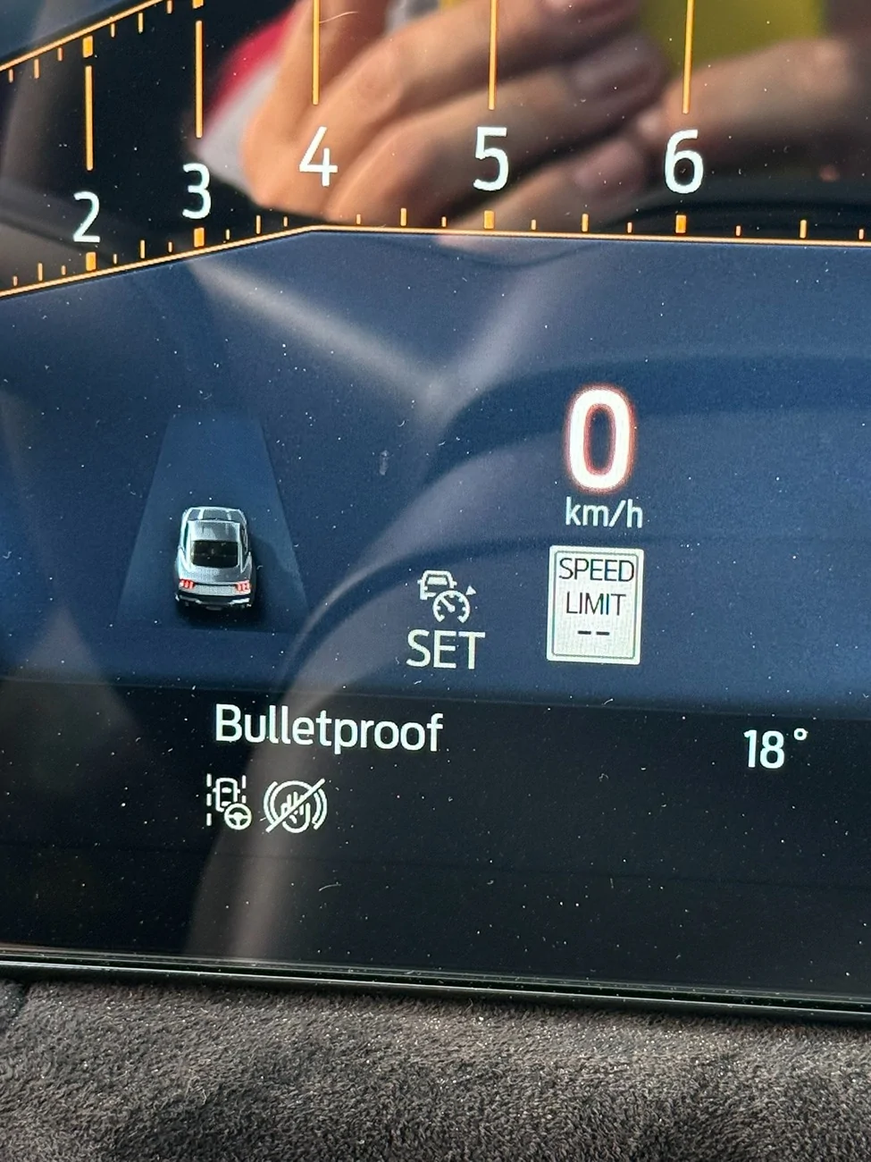

Bad news is when I go to engage Cruise it just shows the greyed out line as if I was not moving, unless it picks up a speed based on the tolerance I have set in the intelligent cruise control example if a tolerance of 10KPH in a 30KPH zone it will set the cruise at 40KPH. However it does not actually set it, it just stays grey. Similar situation if you ever try to engage cruise control in track or drag mode, it just wont let you. When I don’t have a speed sign on the instrument cluster, I get the same as if I was parked, which is "tac" or "dash" next to little cruise icon.
The last pic is what it looks like when cruise is working.
This leads me to believe that the car with the settings I changed does not “know” if the car is moving because I have not put into drive? (Can’t do that in a manual!)
All the changes i made are based off the Asbuilt data posted above compared to mine in the fields i thought were relevent, anything to do with stop and go, traffic jam, cruise etc. I cross refrenced each line to the data base and changed based on what the automatic data had, less stuff like country, PP options, transmisson options etc.
That’s kind of where I am at right right now. I listed the settings I changed, if you want to do this just save your original settings in each module and switch back and forth. I have gone back and forth now a handful of times.

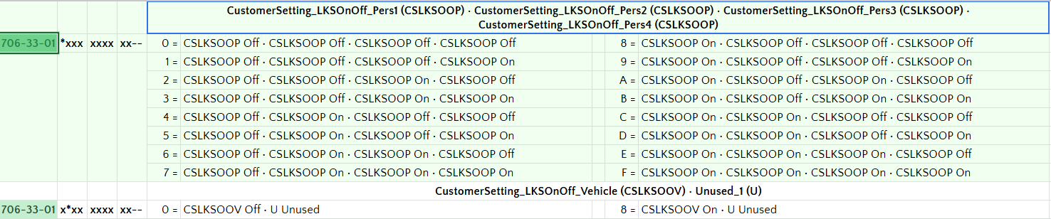

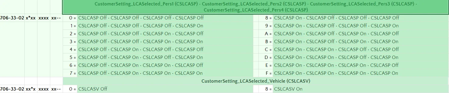

Found something else in the IPMA. Below is from a 2025 Mustang GT 401A automatic:
Here is that same line on a 2025 401A manual:
Assuming the LCA is lane centering assist and LKA is lane keep assist, I think it is worth a try at this point.
There is also something about lane keeping aid in the SCCM, but both the auto and manual have it enabled. I have looked through everything else I can think of and I am out of ideas after this.
