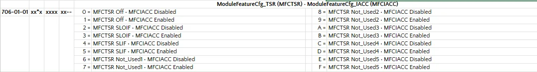

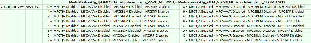

This is the first line of the IPMA config for a 2025 GT Premium manual:
This is the first line of config for a 2025 GT Premium Auto:
They both show an E in the second bit of the first block, which means both vehicles have lane keep alert, lane keep aid and lane centering with assist enabled in the IPMA:
Where they differ is in the 3rd and 4th bits of the first block. The manual shows a 4 in the 3rd bit which means Intelligent Adaptive Cruise Control is off and the auto shows a 5 which means it is enbaled. This has nothing to do with the topic at hand.
The forth bit shows a 0 for the manual so TJA is off and an 8 on the auto so TJA is on. TJA is Traffic Jam Assist which also has nothing to do with lane centeting/keeping.

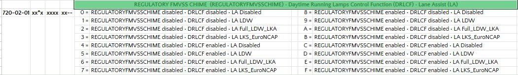

Now let's explore the PSCM. The manual Mustang shows this:
The auto Stang shows this:
This means both the manual and auto have Lane Keep Aid enabled, but only the auto has Lane Centering Asssit enabled:
In the IPC, the manual shows this:
The auto shows this:
The first bit has to do with with the gear select which is irrelavant. The important thing here is the third bit which has to do with the lane assist animations in the IPC is an A in both cars, which means the IPC is set up for both vehicles the same way.

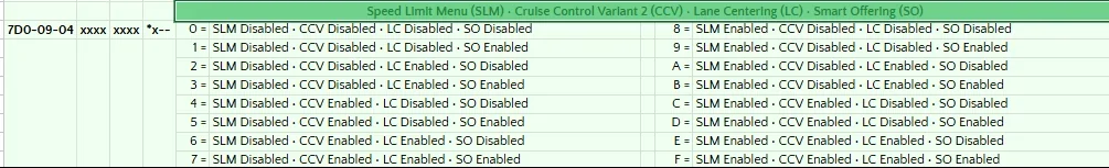

Also, lane centering needs to be enabled here in the APIM:
So, if I wanted to try and enable this, I would do the following:
PSCM:
730-02-02
xxxx xxFF xxxx
This SHOULD enable lane centering assist in the PSCM on manual Mustangs. Only one way to find out.

The change at 730-02-02 alone was not enough to turn lane centering assist on. I still have the ping pong effect going on.
A quick search through the spreadsheet is showing quite a few addresses, across multiple modules, pertaining to lane assist, lane centering, etc. so it looks like its going to be a bit more involved.
Since my car is a Dark Horse, and I dont really have anything to compare it to, would it be possible to get a copy of the asbuilt data for the auto and manual transmission cars you were looking at? I'm pigheaded enough that I can see myself wasting a lot of time trying to figure this out; especially since I know just enough about this shit to be dangerous.

I didn't get too far into this today, but I'm beginning to think there are a couple of different features involved with making lane centering work on the manual transmission cars.
Based on @rugedraw's earlier post and asbuilt data I pulled for a DH Premium with the A10, both cars have 'Intelligent Adaptive Cruise Control' and 'Traffic Jam Assist' features enabled. Mine with a manual transmission does not; although I do have 'Adaptive Cruise Control'. Enabling/disabling these features often seems to be grouped with something related to lane assist.
Adding to my assumption is an earlier post in this thread by @DT-GT outlining what is required to activate lane centering, which states that 'Adaptive cruise control with lane centering' must be turned on, as well as 'stop and go'. I could be wrong, but stop and go sounds a lot like an user friendly term for traffic jam assist.
At this point, I'm still not sure what the difference between 'Adaptive' and 'Intelligent Adaptive' cruise control is. Stop and go probably isn't going to work very well with a manual transmission (if it does anything close to what it sounds like), and that is if it can even be activated on a manual transmission vehicle. In the past we've seen issues where certain features could not be enabled due to the car having the wrong country code, so it's possible the same goes for transmission codes as well.
