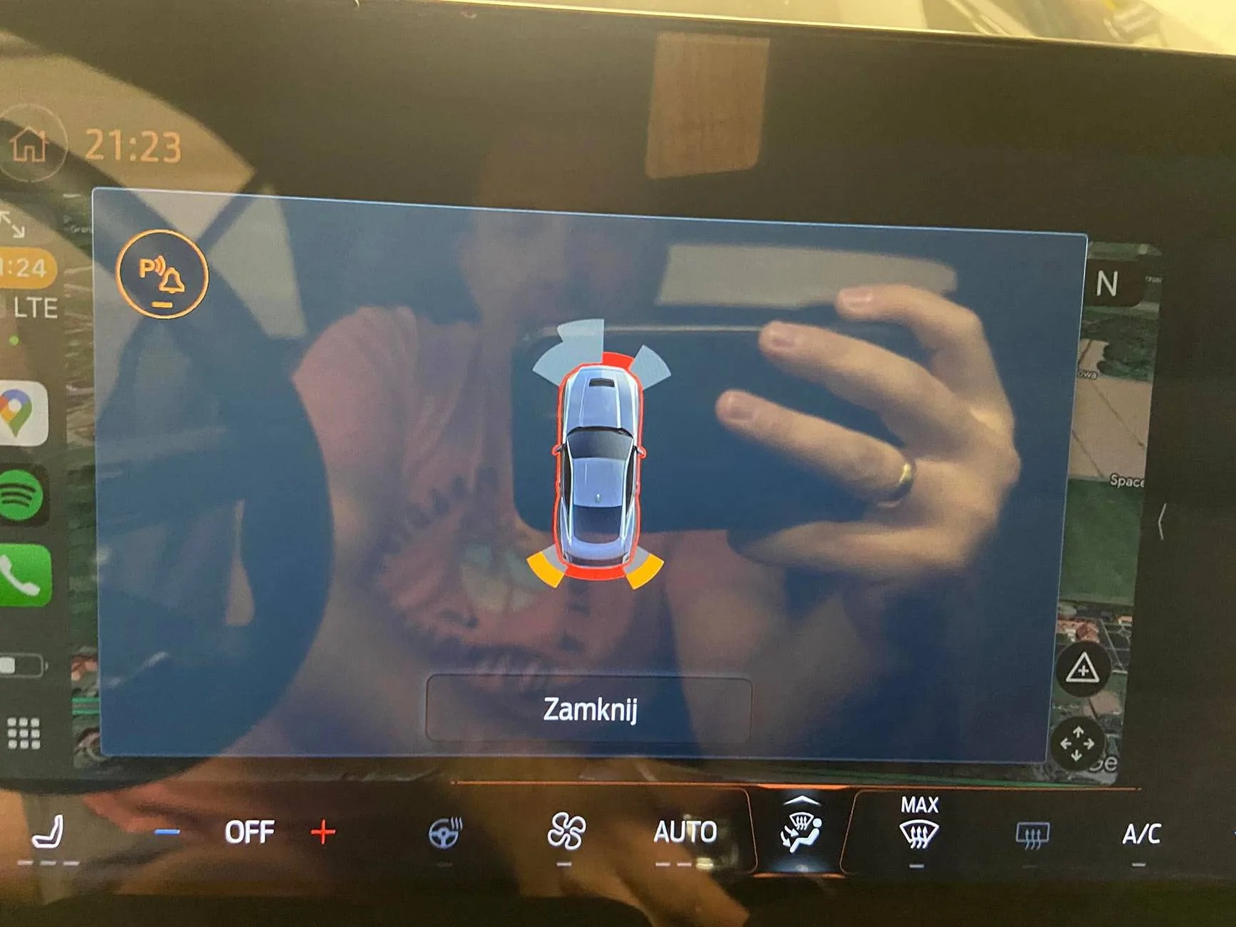

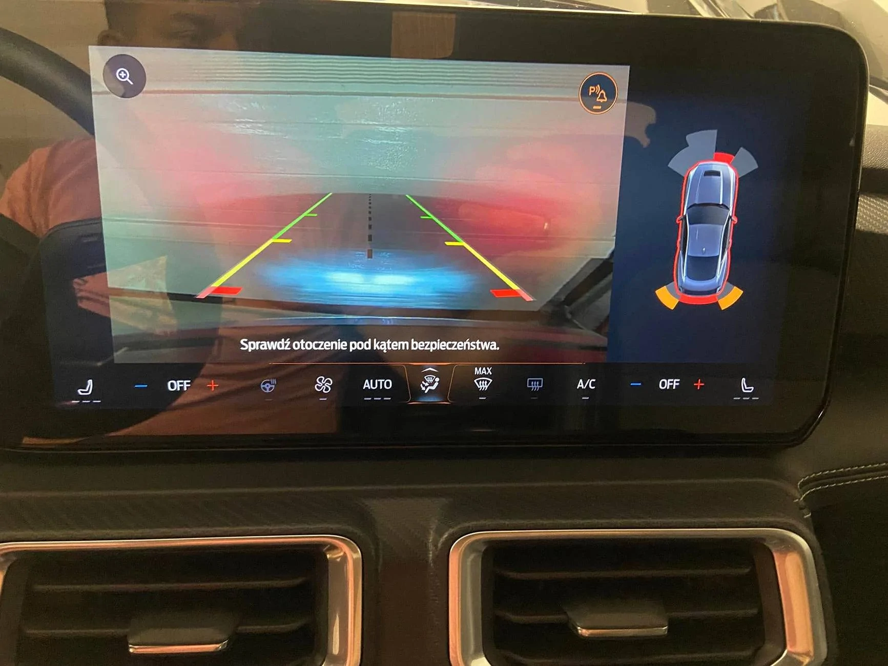

I have already add it. I am struggling that I have no sound from Front Sensors but Visualize works fine.

So, I use genuine ipma + hw mod for lin.
I did make tests and....
1. Updated IPMA to Mustang 2025 FW - no sound
2. Changed IPMA to 2024/2025 Transit - no sound - this FW was from transit which had 4+4 PA - NO 360 Camera - it means it suppose to work !
I did even copy(1:1) as builds from IPMA / APIM from such transit - still NO sound.
It looks like it is not about IPMA, I will try digging more - in ACM that time and ECG.

Well, I did not succeeded to get working sound from front sensors. It looks like it is related with IPC, as I checked ACM, IPMA - from other cars which got it working ( e.x Escape 2024 ) and it behave same.
I did not have a chance to check FW from Mustang MY26' if maybe something changed or not.
