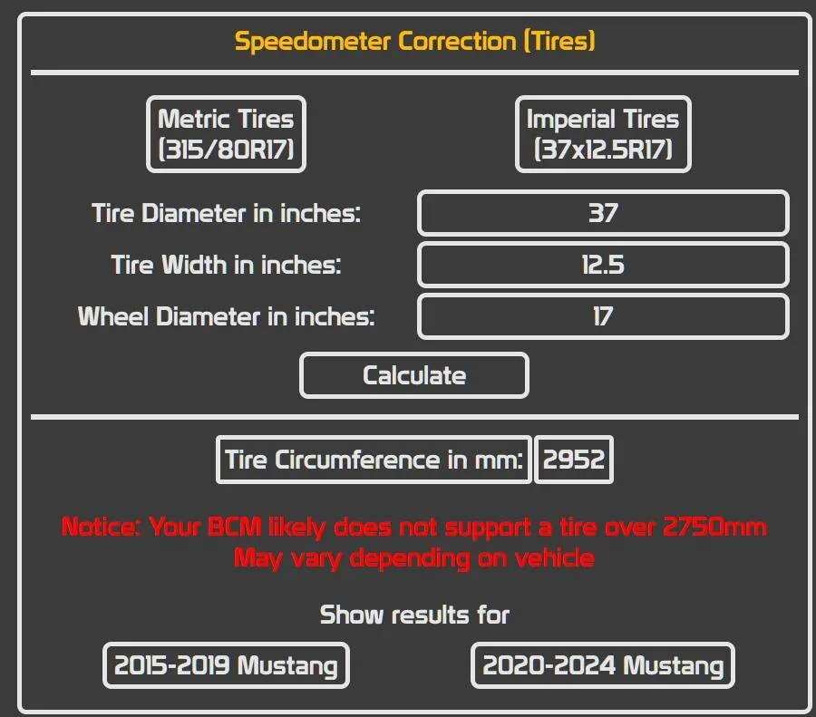

in the interest of transparency, here's the code used for the calculator
JavaScript:
function tirecalc() {
    //calculate the tire circumference, multiply it by 0.967, then convert it to hex
    var tirewidth = document.getElementById("tiresize_width").value;
    var tireaspect = document.getElementById("tiresize_aspect").value / 100; //convert the aspect ratio into a tenths
    var wheeldiam = document.getElementById("tiresize_wdiam").value;
    var tireheight = (tirewidth * tireaspect) * 2 + (wheeldiam * 25.4); //multiply the width by the aspect ratio then add that to the wheel diameter converted to mm
    var tirecirc = Math.floor(tireheight * Math.PI); //mutliply the total height by pi to get the circumference
    //console.log(tirecirc);
    var finalcirc = Math.ceil(tirecirc * 0.967).toString().padStart(4,0); //multiply the circumference by 0.967 because Ford does that for some reason, then round that up, convert it to a string, and pad the start
    //console.log(finalcirc);
    var hexcirc = parseInt(finalcirc).toString(16).padStart(4,0).toUpperCase(); //convert the new circumference to an int, then convert it to base16, pad it, and make it uppercase
    document.getElementById("tiresize_result").innerHTML = hexcirc;
    document.getElementById("tiresize_result_mm1").innerHTML = tirecirc;
    document.getElementById("tiresize_result_mm2").innerHTML = tirecirc;
    document.getElementById("tiresize_result_n1").innerHTML = hexcirc.slice(0,2) + "XX";
    document.getElementById("tiresize_result_n2").innerHTML = hexcirc.slice(2,4) + "XX";
what it does is it gets a bunch of stuff from the HTML that was in the inputs, then does the following:
calculates the full height of the tire in mm
calculates the circumference in mm, rounded down
finds the circumference used for the hexadecimal by multiplying the circumference just found by 0.967, then converts it to a string so that i could add leading zeros if it was less than 4 characters in length
finally, it assumes the variable we just did was a whole number, and converts it to a base-16 string, then pads it with leading zeros again if needed, and finally makes the whole thing uppercase
the thing is, this is based on some stuff i found at the time (August 2023) which i interpreted to mean Ford for some reason uses the circumference times 0.967. thanks to this thread, sometime very soon i will be updating the calculator. it remains to be seen if the hexadecimal part stays or it just calculates circumference, but i will also work on adding support for non-metric tires

Thanks Rocket, I appreciate you creating the calculator in the first place! Your posts have been really helpful in me learning to use Forscan. I wasn't trying to be critical at all, was more like me trying to make sure I was understanding the tool and inputing the right values LOL.
77
2,676
4,053
i really needed to update it anyways. it looks like the consensus has changed from the right value from "0.967" to "0.968". i also really needed to add an imperial tire size feature. so i did, it should be going up soon-ish. i also went ahead and added a notice for certain tire sizes based on what i saw online people were hitting limits at. so really, thank you. without your comments, i might have just kept putting off the update
