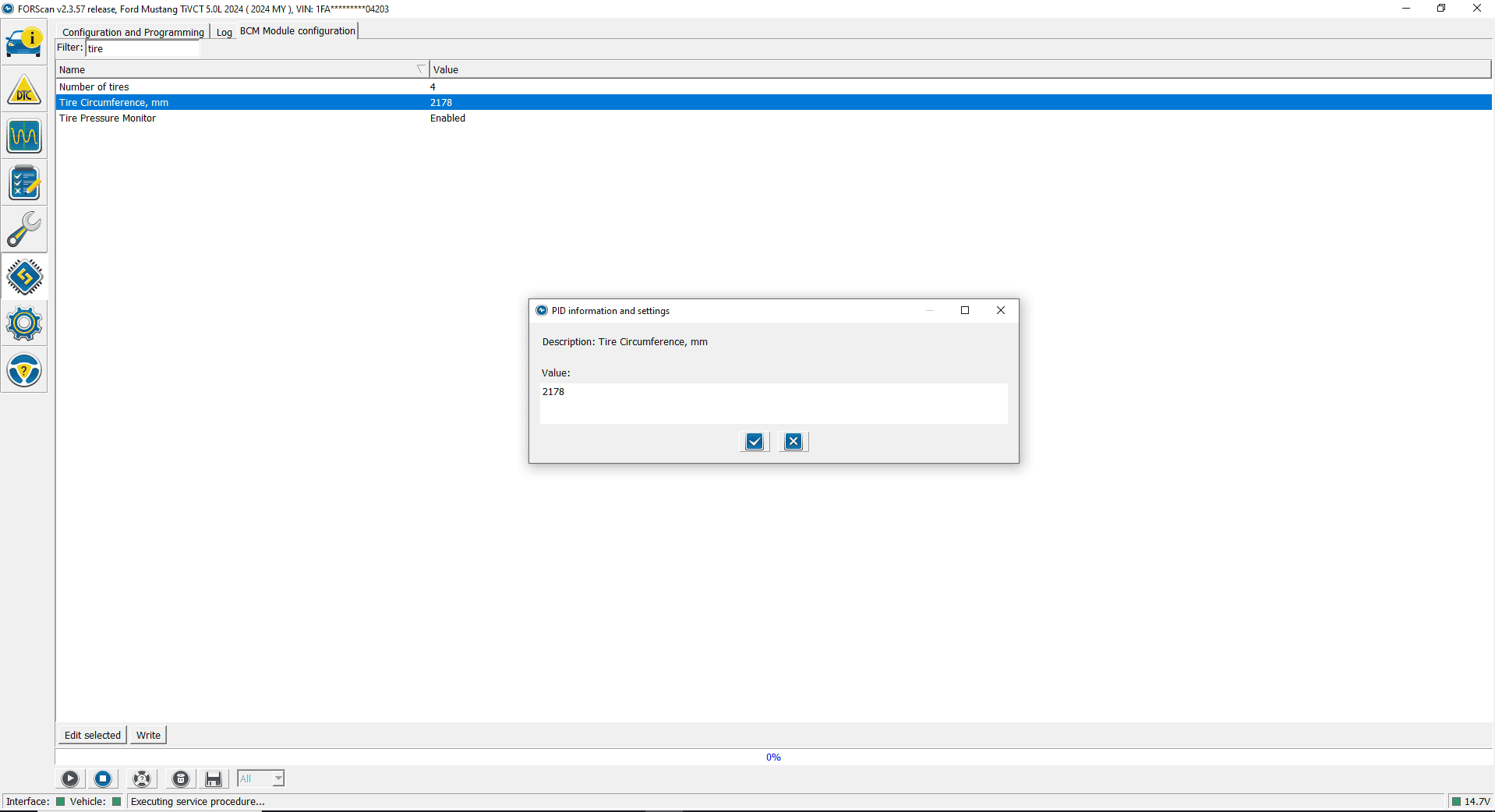

Ok, I had a few minutes and my curiosity got the best of me. Version 2.3.57 connects. It reads the BCM module. Will let you edit the tire circumference in mm. I didn't change anything. I haven't bought new tires for my new rims yet.

I'm not sure I understand what you mean by "diameter"?
You only have to change the Forscan if the overall tire diameter is larger or smaller than OEM. If its less than .3" I wouldn't bother.

What @Dave2013M3 said!
As an example the OAD of my OEM Goodyear 265/35/20" all seasons is 27.3 ins.
The OAD of my Nitto 305/35/19" summer tires is 27/4 ins.
No change necessary.
