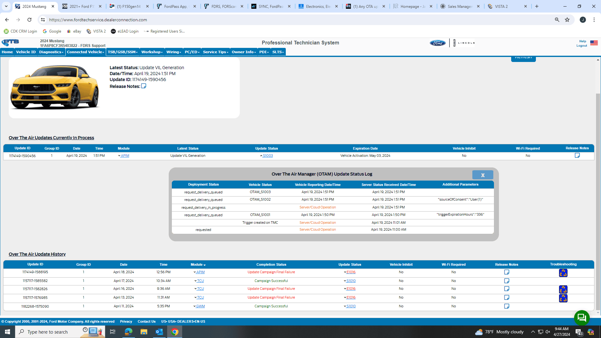

Doesn't that indicate the GWM was recently updated on 14 APR?
Challenge accepted!
No, thats the last time that particular module pinged the mothership.
Edit: I'd back up the BCM and PCM with FORScan jic.

OTA history is below. You've had a few failed OTA attempts that were resent and went through. You have OTA 6.3.2 in your queue now for the second time since 4/19. Strange, because it shows the files are ready to download, but it hasn't downloaded any of them in 8 days that the OTA trigger was activated. Do you live in an area with good cellular coverage?
Probably ok (Not sure which network they uses), but my car parked at garage all the time that might be the case.

Do you drive it regularly? You driven it around in the past week?
It's on like Donkey Kong!

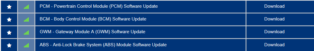

Were you showing a GWM update available?

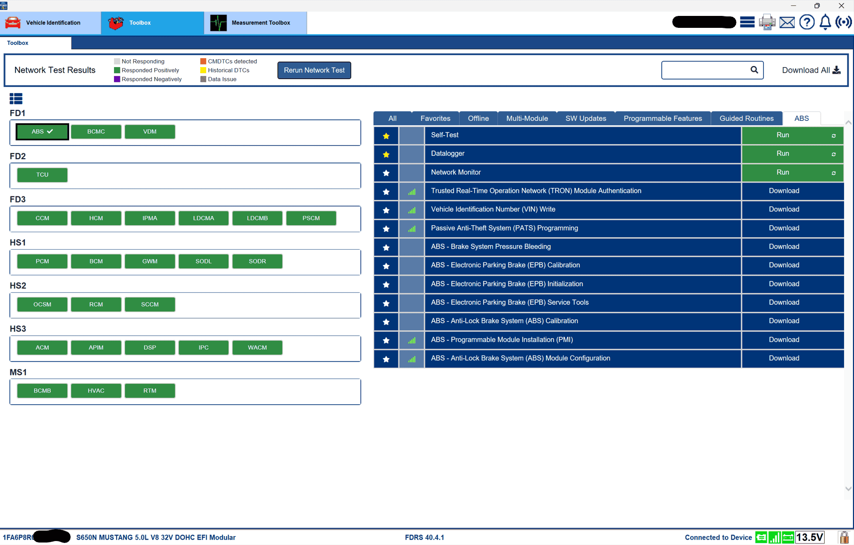

No. Just BCM and PCM. Both updated without issue.
Weird no GVM or APIM update.
Doing the truck now:

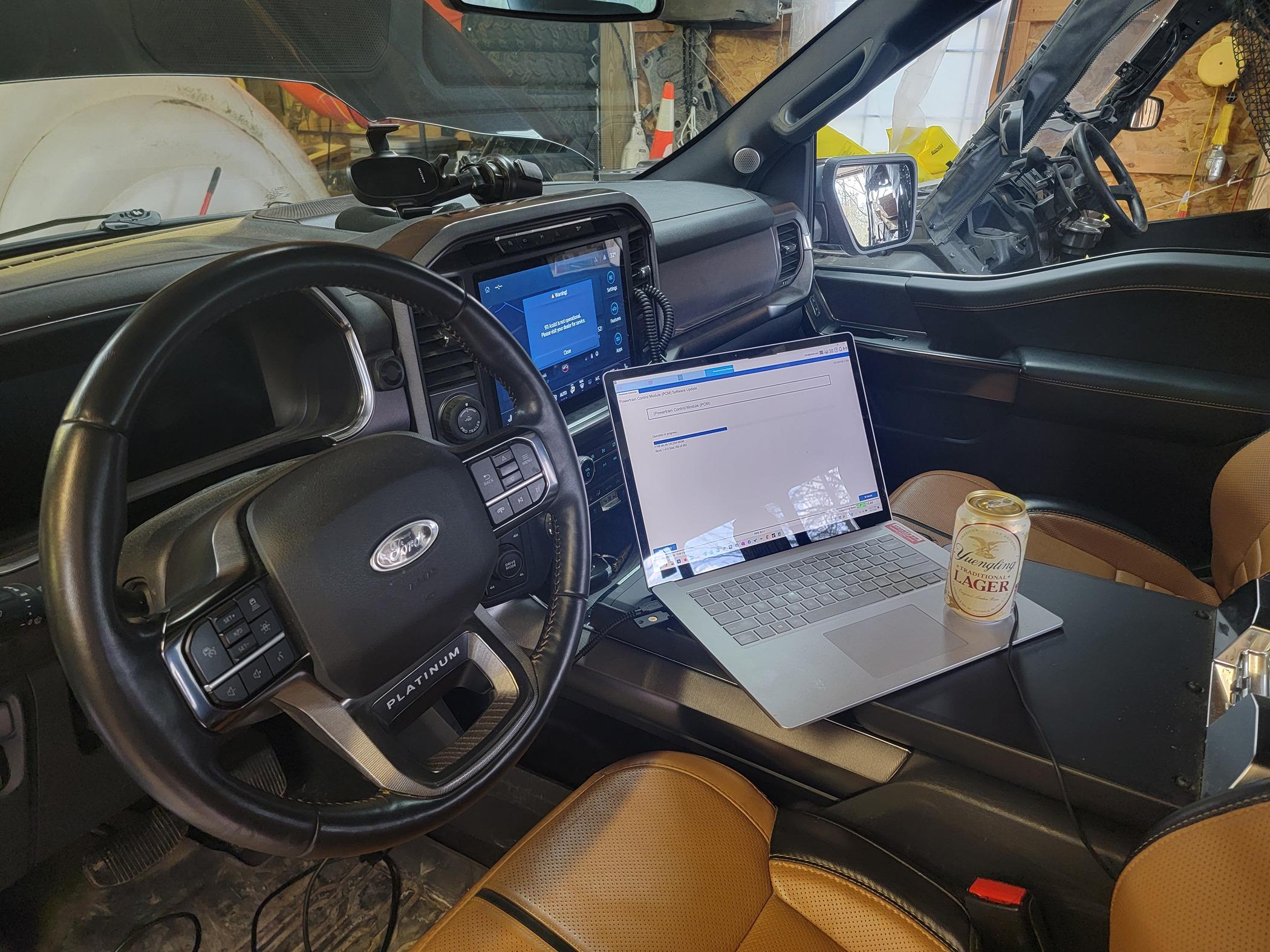

Everything has been updated in the car and truck.
Dark Horse: Had BCM and PCM firmware updates waiting. Applied both. Initially, a few modules reported DTCs after these updates (common), but clearing and retesting those, all are perfectly fine and I have no updates waiting for it in FDRS. SoC was 92% when completed (I run a Clore Pro-Logix fully-automatic smart charger in power supply mode when I'm programming).
S650 Mustang Any OTA updates yet? 1714326960028-96
I now have the '67-68 gauge cluster available for selection.

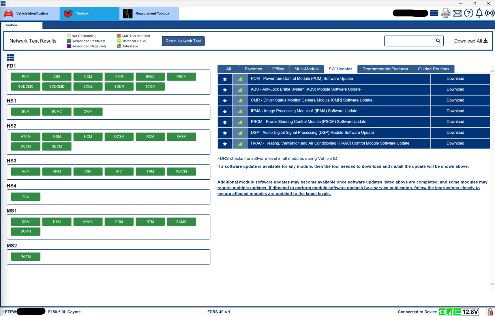

And not that anybody cares about non-Mustang content, but I also updated all the outstanding firmware waiting for my '21 F150 Platinum. There were a ton, including PCM, ABS, CMR, IPMA, PSCM, DSP, and HVAC. I don't recall, but I think the APIM had an update, too. Several of those are prep for the next gen BlueCruise 1.4 functionality, IIRC.
S650 Mustang Any OTA updates yet? 1714327714180-zq
Several of these updates actually update many more than the main module. the IMPA (Image Processing Module A) took at least an hour and a half. PCM (Powertrain Control Module) was a long one, too. I think I was programming for the better part of 4+ hours yesterday. Even though I had my smart charger in PS mode, I was programming so long that the SoC went down pretty low. It wouldn't let me clear a battery voltage DTC for the ABS module, so I called it a night, put the charger on the truck and let it sit overnight. This AM, I was able to get that DTC cleared and update the only remaining module (HVAC). Performed a reset on the BMS (Battery Management System) and it was showing 88% SoC -- not bad for a 2 year old battery (it was replaced back in 2022 when the dealership was trying to enable BlueCruise on my Job 1 truck, which was a bear).
Made a few new FORScan changes on the F150 as well. I love customizing my truck ... :)
All in all, it was a good day and a half and well worth the $53 for the 2-day FDRS subscription.
