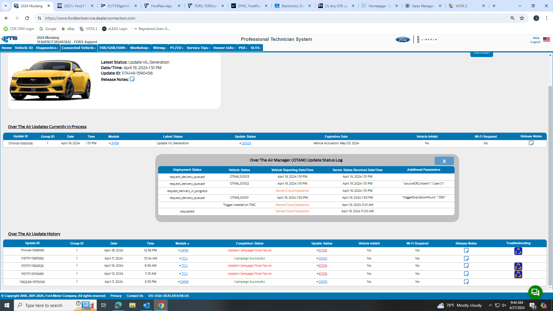

Hi @rugedraw can you check mine, once you have time 1FA6P8CF3R5403822

OTA history is below. You've had a few failed OTA attempts that were resent and went through. You have OTA 6.3.2 in your queue now for the second time since 4/19. Strange, because it shows the files are ready to download, but it hasn't downloaded any of them in 8 days that the OTA trigger was activated. Do you live in an area with good cellular coverage?

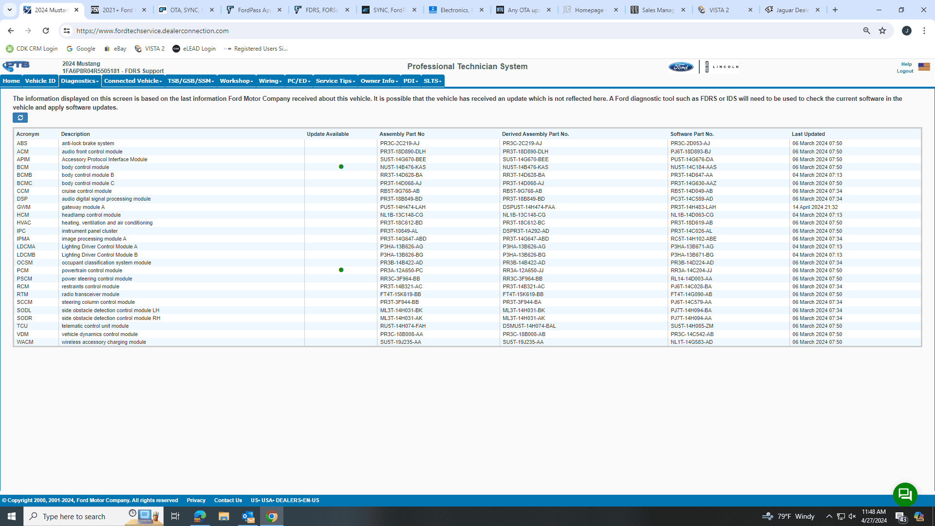

@rugedraw - Any changes for me since then? I'm
[/QUOTE]
This is what PTS is showing which I don't fully trust. It is not showing a GWM which would be 6.1.0. Remind me tonight to check FDRS to make sure it is there. Without that showing, you won't be able to go through the entire progressing on this car.
Also, please note both the BCM and the PCM have not been sent to any of these cars yet, so you'd be the guinea pig for these updates as far as I know.

Doesn't that indicate the GWM was recently updated on 14 APR?
Challenge accepted!
Challenge accepted!
Waiting to see how it goes with your FDRS session...
Challenge accepted!
No, thats the last time that particular module pinged the mothership.
Edit: I'd back up the BCM and PCM with FORScan jic.
Probably ok (Not sure which network they uses), but my car parked at garage all the time that might be the case.
Do you drive it regularly? You driven it around in the past week?

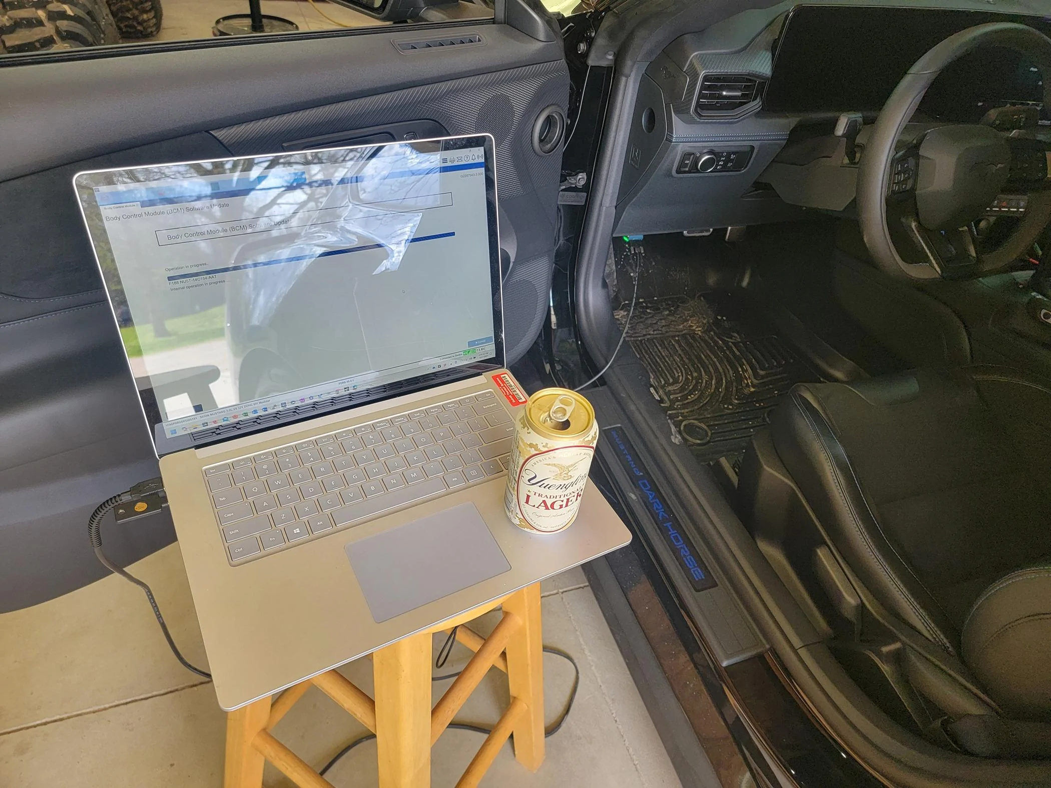

It's on like Donkey Kong!
Were you showing a GWM update available?

..and you've got good taste in beer!
