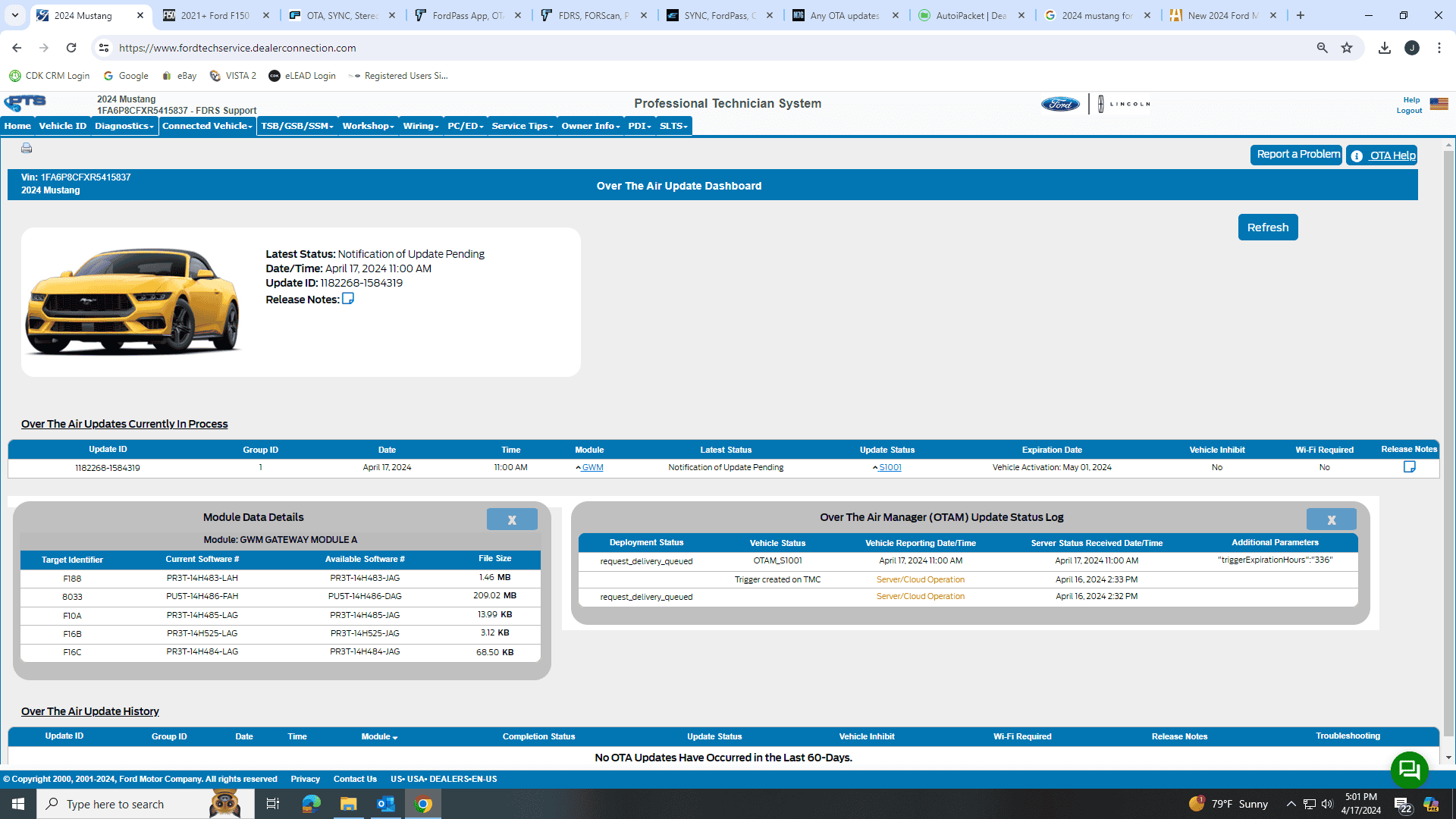

So, fun fact, and this may be just a coincidence but i think not...
I hadn't received any updates yet, but, yesterday it dawned on me...
Since this is still off-season up here, i leave it plugged on a maintenance charger which means the hood is popped and for long term i usually don't use handbrake...
Fixed all this yesterday and today getting home from work, 6.1 was ready to install...
When an non-inhibit OTA trigger is created for a vehicle on the server, the catalyst to get it to install it to turn the vehicle on or at least turn accessory mode on. You most likely had the OTA sitting in queue and when you started the car, it allowed the OTA to proceed to the next step.
Below is the OTA dashboard for a random Mustang I found for sale at a local dealer. This vehicle had an OTA trigger for 6.1.0 created for it yesterday afternoon. At 11am today, the vehicle pinged the server back letting the mothership know it got her message and the 336 hour timer started. If this vehicle is not started between now and May 1st, the OTA trigger will time out and cancel and then this car will have to wait for the server to resend the update to it.

Makes sense, but i had been driving it a few times lately or at the very least turning it on to manually check updates.
I'm just happy it's finally doing them. We'll see how fast the other 2 updates roll in now!
Then most likely the OTA trigger was created for you the same day it installed. These type of updates have a high success rate. It's the ones that require the vehicle to be parked while they install that have proven to be a PITA across all connected Ford vehicle platforms.

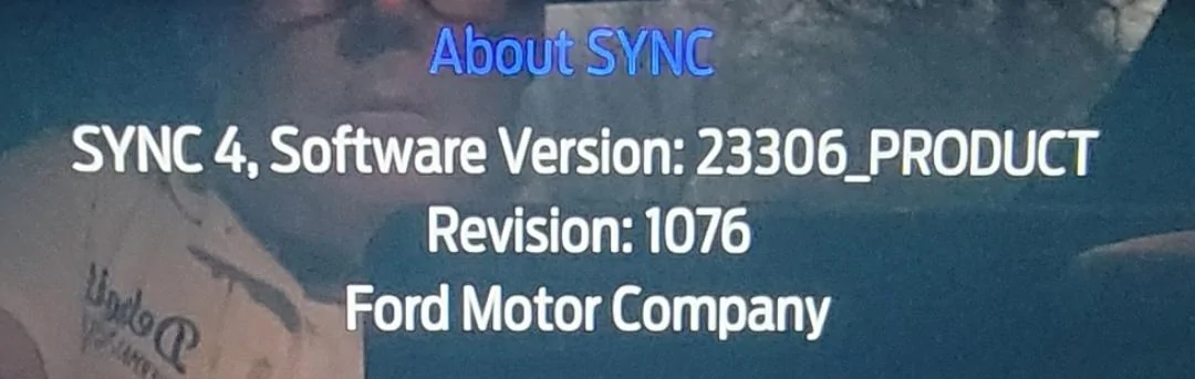

No goodies sent to you yet and nothing in queue. PTS shows you have a PCM update pending, but I don't fully trust PTS to show all pending module updates. I'll check in FDRS when I get home later. It's crazy how few modules these cars have compared to others.
@roadpilot Confirmed with FDRS. Only showing a PCM update.
3,260
3,709
Thx. Might be time to break out the Mongoose for the truck and DH. Mustang still on 23306
Unless there's something on the truck worth updating, I'd save the $50 until something shows up for the Stang worth doing. I hate PCM updates because they wipe my tune, but I guess you don't have to worry about that here.
Is your truck fully updated? Latest IPMA/PSCM updates installed?
Haven't checked in a while, but I've been getting plenty of regular updates.
