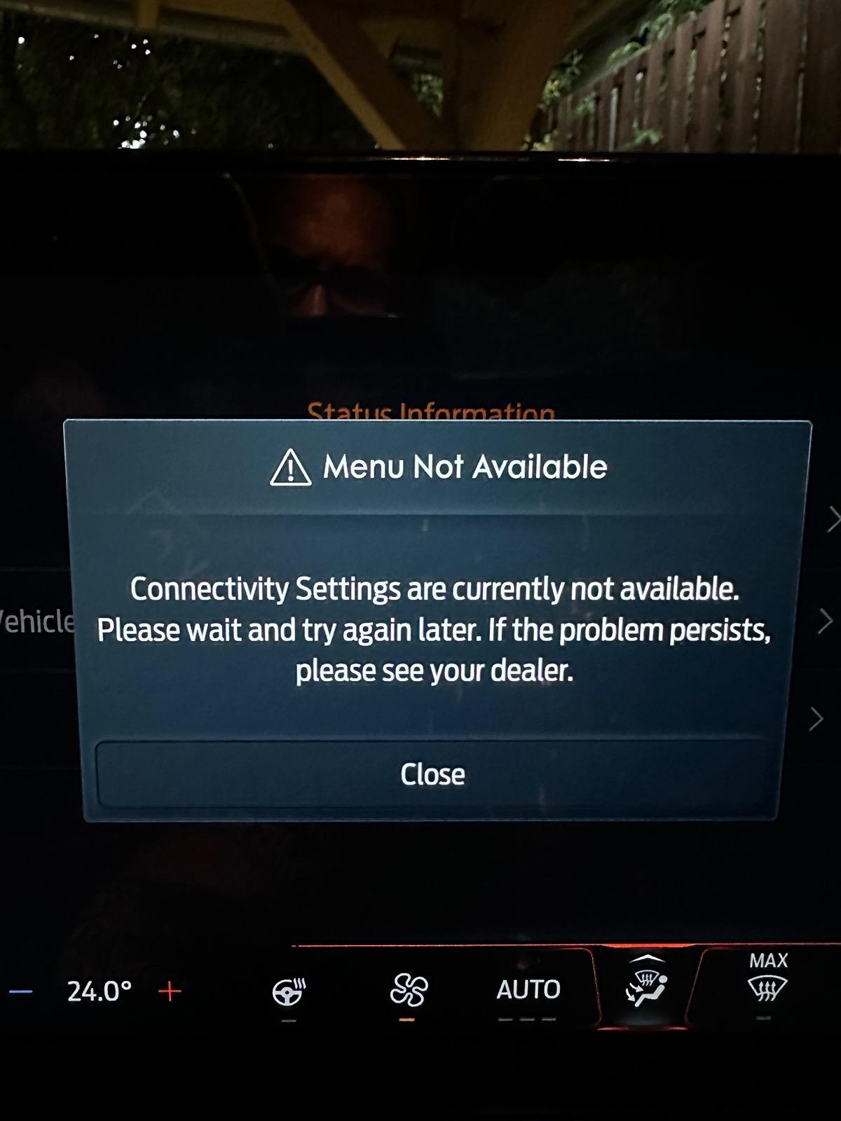

But when I check my connectivity settings, I got the spinner for a few seconds then it went back to the previous screen without showing the details. Somehow I also got managed to get this error as well (attached)

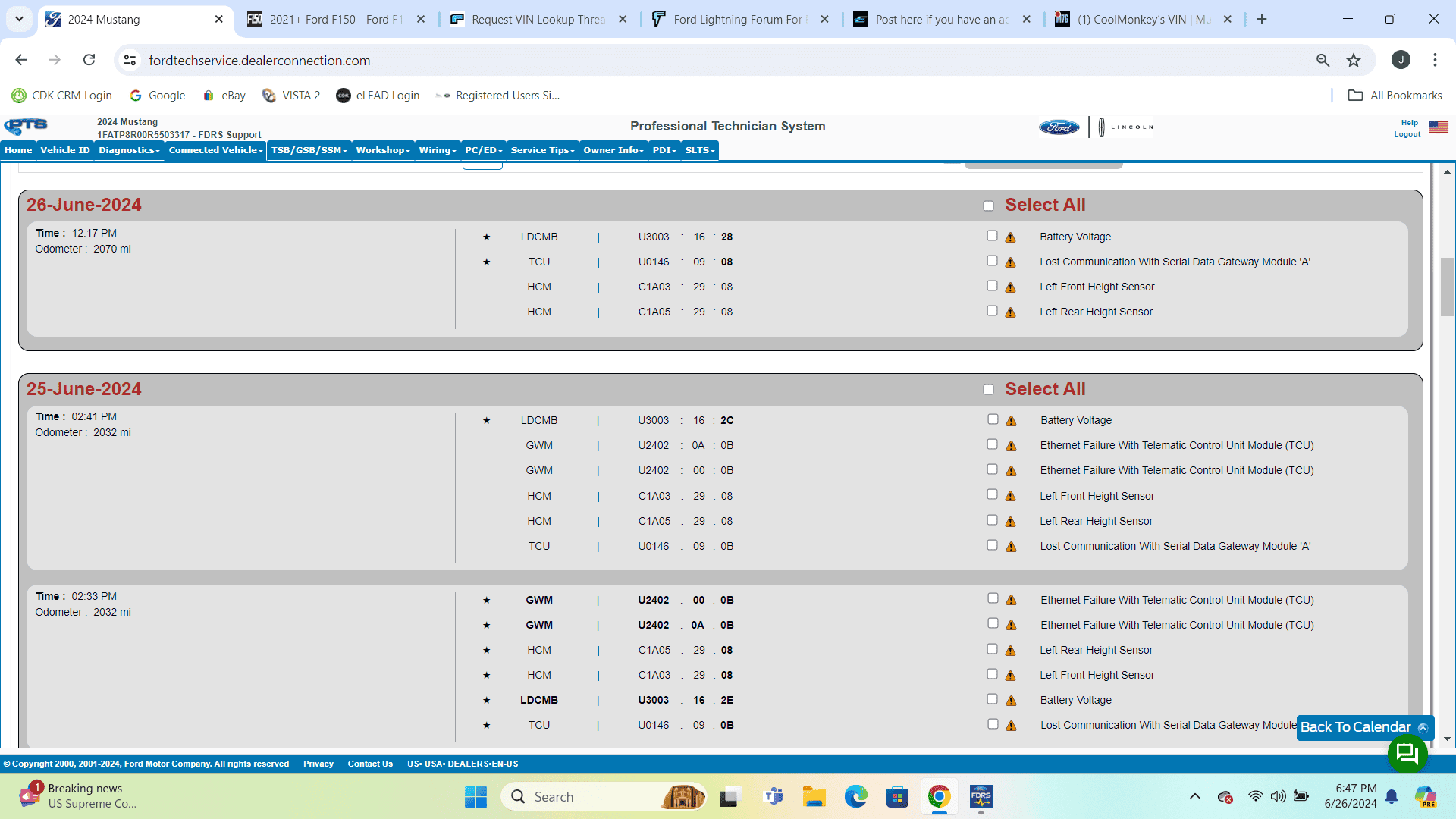

Your car is reporting some codes that coincide with possible connectivity issues. The ethernet failure and lost comms codes between the GWM and TCU modules are not normal. This could be due to a possible bad connection between the modules or a faulty module. Your dealer is going to have to look into this to figure out the cause. I was able to pull the connected data when I checked your car, so it seems the issue is intermittent. Tell your dealer that your modem works whenever it wants to. When the pull the codes, they will see this.

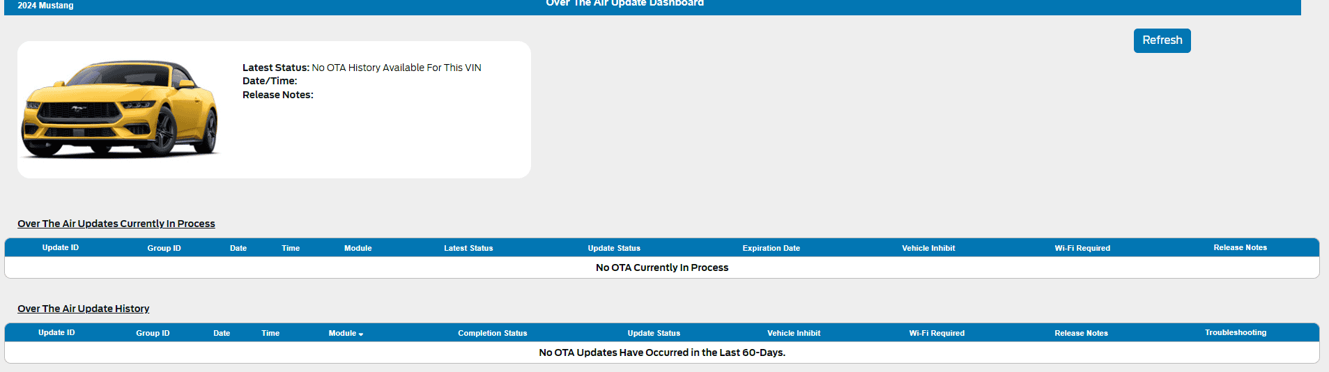

To answer your original question: You OTA dashboard is below. No updates have sent to this vehicle yet.

It first reported it on 6/15. I am not sure how invasive a dashcam install can be, but I doubt that is what caused this.
Unless you notice any issues with your left headlight, I would not worry about it. All vehicles report some kind of fault codes.

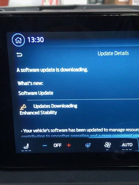

Have been seeing this for three days. It's on the internet when in the garage. I did get one update a month ago. Has this happened to anybody else ? Re-boot something maybe ...
Thanks
Thanks
If you have FORScan, reboot the GWM and TCU.
If you do not, disconnect the negative battery cable for 20 minutes and that should ne enough to cause both of those modules to reboot.
No FORscan for me (yet)
I was going to yank the neg today. 20 min should do it, thank you !!
