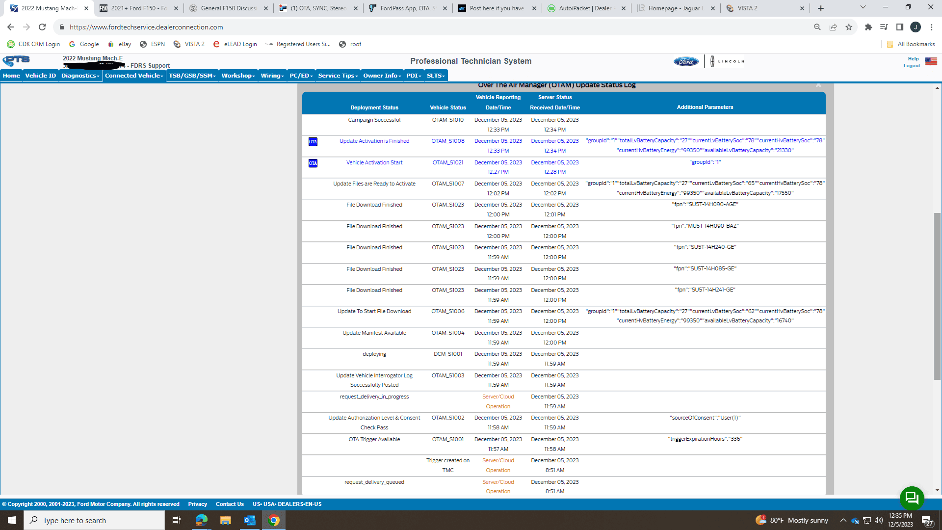

This is what a successful non-inhibit OTA looks like in PTS. After the interrogator posts the log, the file deployment commences. His car never made it to that part even though it met the prerequisites for it.

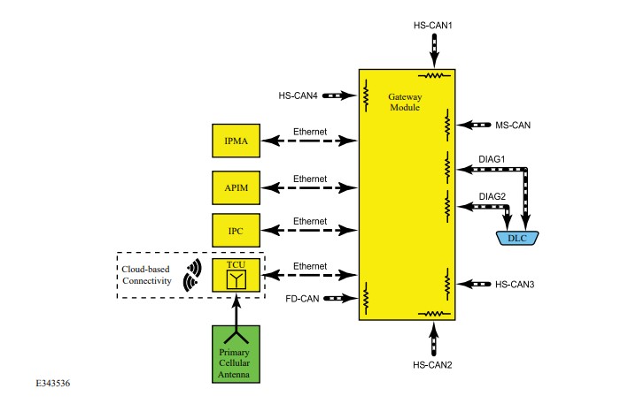

System Diagram:
4 modules use an 'ethernet' network (its a 2 wire custom bus) to communicate. Everything else communicates via CAN. There are 6 CAN networks in the MME. HS 1 to 4, FD-CAN (adjustable datarate) and MS. There are also some other FD CAN or local CAN/LIN networks to communicate direct between modules or modules that are not CAN networked but need to have a data stream for some various reason.

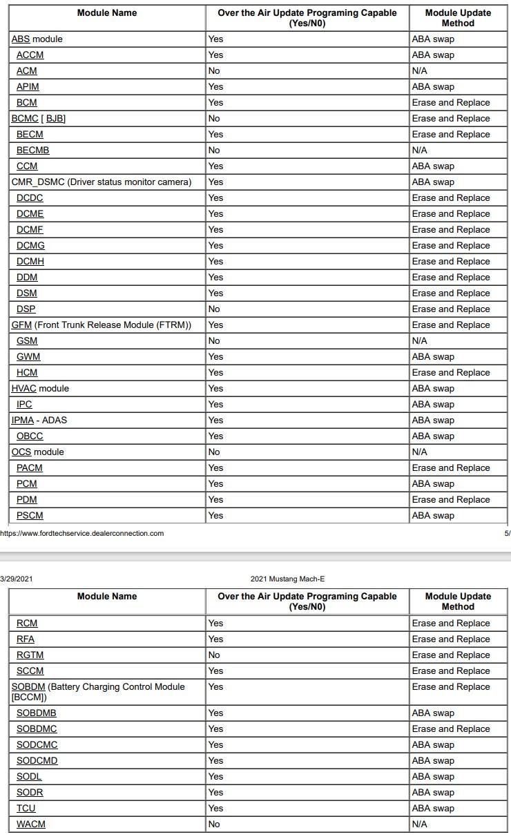

Out of the 44 possible modules in the vehicle (depends on trim/options) 37 are able to be updated over the air. Here is the list:
S650 Mustang Any OTA updates yet? mme-module-list-ota-jpg
The modules that cannot be updated are the ACM (Audio Control Module), BCMC (Body Control Module C, or battery junction box/fuse box under hood), BECMB (Battery energy control module B), DSP (B&O), GSM (Gear shift module), OCS (occupant classification system/passenger seat airbag sensor), RGTM (rear gate/trunk module), and the WACM (wireless phone charger). I think this list of modules makes sense to not require updates considering what they do. The actual audio system/sirius receiver/DSP seem like an update should be available but they didn't implement it. Things like the BCMC are just a fusebox, and the BECMB/OCS are airbag system related modules separate from the main RCM.

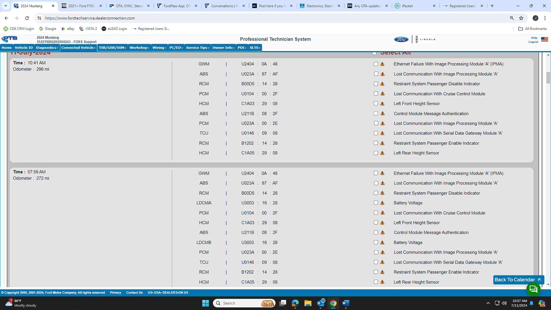

@rugedraw could you check my Mustang 1FATP8R02R5504243? Thanks in advance. I have several problems with assistance systems and I hope that maybe update will solve it.
rugedraw
Apr 17, 2024
487
618
Miami, FL
Your car is reporting some codes that coincide with your concern. Most of the time, these codes will reference a certain TSB or SSM that provides a clue to what cold be causing the issue, but that is not the case here. The first code citing ethernet failure between the IPMA and GWM indicates a possible hardware issue. Then there are the lost comms code with several modules directly related to the driver assist features like the CCM and IPMA. This is something that is very difficult to diagnose remotely. I think a dealer visited is warranted in your case.
Thank you very much for all the information, could I ask for information from when these errors started to appear? I have a suspicion that the dealer simply issued me with a faulty car. Thanks in advance.
rugedraw
Apr 17, 2024
487
618
Miami, FL
Codes are stored for 60 days at a time, so more than enough since you car is new. Looks like they've been there since day one.
However, this does not mean they sold you the car knowing this. As a dealer employee for many years, there are many catch 22's we have to deal with when it comes to sales, service and parts and dealing with manufacturers. I won't get into the details, but even if they knew, until a vehicle gets sold, the warranty is not active, so sometimes, there is not way to bill the manufacturer to fix certain things until the warranty is active.
In your case, I am able to see anything that has pulled on this vehicle, and no one had ever checked the codes this car was reporting until I did today.
Thank you very much! This will be a good bargaining chip to talk to the dealer.
No need for chips. Tell them your car is showing some driver assist problems. The car is not reporting and hard faults, so they will have to drive it to replicate the issue. If they can't duplicate the issue, they won't be able to do much. They can see these codes themselves and I am sure they will check them. This is not a "smoking gun" to use against them. I was just giving you the info you asked for.
