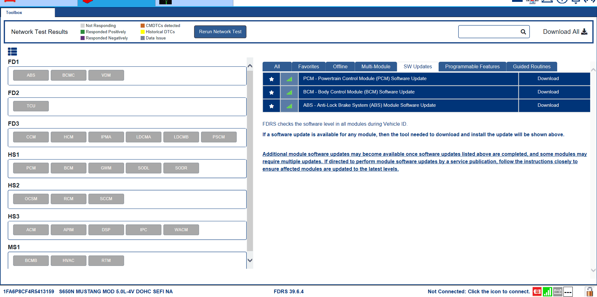

FDRS is not showing any module updates that coincide with the 6.x.x updates others are getting. Your dealer won't be able to apply those updates for you. Unless if they run a network scan with FDRS (instead of me just typing the VIN into it) and that causes another update to release that isn't on this list, you will not be able to get these updates.
Interesting outcome, Thanks for checking!
I’ll ask them if they are aware how to apply latests updates to my car, if i feel they are clueless, then i might just ignore it unless I face issues with the car.
They must have been trained or informed by ford for such cases… can’t believe they are totally unaware.

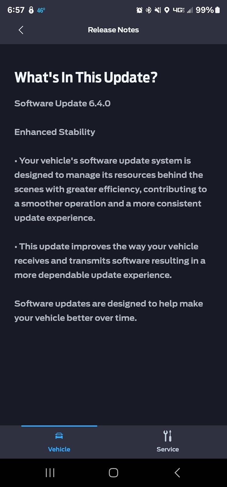

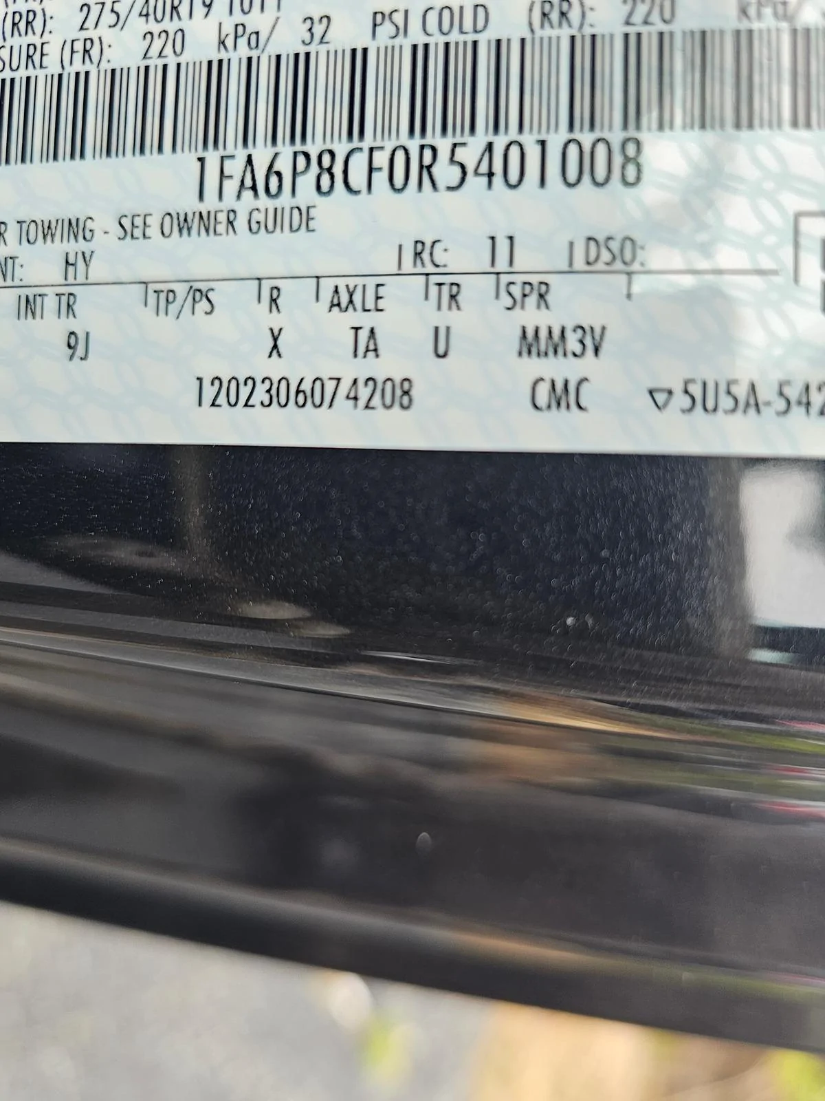

To anyone that got 6.4.0, please post or PM me the VIN so I can pull the update details and add it to the OTA history thread.
S650 Mustang Anyone else have OTA updates lagging behind? 20240424_093501

I got the new gauges but neither Ford Pass nor my car show that I got any update.

It's a GWM update; no new features added. OTA history thread has been updated.
Fordpass is known to be delayed showing these things and sometimes, no notification at all.
