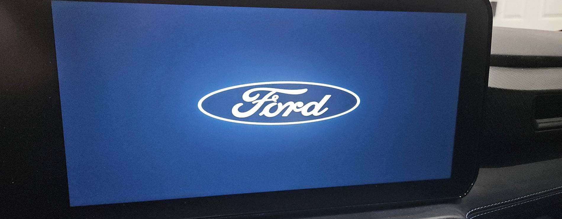

Maybe we need somebody with the balls to try the following 2B, 2C, 2E and 2F.
7D0-03-01xxxx**xxxx--
1A =SS S650 “Dark Horse” Welcome Animation (w/o B&O)
1B =SS S650 “Dark Horse” Welcome Animation (w/ B&O)
1C =SS S650 “Pony” Welcome Animation (w/ B&O)
1D =SS S650 “Pony” Welcome Animation (w/o B&O)
2D =GTD (not fully functional)
2B =????
2C =????
2E =????
2F =????
2B =????
2C =????
2E =????
2F =????
2B = Generic Ford Logo
2C = Simplified Ford Logo that pulsates. looks to be designed for one of the 12" screens of an F-150 or Bronco
2D = GTD w/ B&O Logo
2E = GTD w/o B&O Logo
2F = Generic Ford Logo
30 = Generic Ford Logo
31 = Generic Ford Logo
its likely that nothing else is assigned and they will fallback to the generic Ford logo one

i finally got a software number for a produced GTD LDCM. its P3HA-13B671-AG, which is the same as a 2024 job 2 and all 2025s. the HCM also matches a 2025. now im just getting confused here
I have a job 2 24 if you need me. Bu
Thanks for testing it out. At least we found another GTD startup, without the B&O.. maybe with less child diseases than the 2D. I don't even know if child disease translates the same as what I mean but lol..
Since we found out that the 2D value is for the center screen, we might have to do the same for the 3E value to maybe find out if we can get the cluster screen working.
7D0-03-02**xxxxxxxxxx
23 = All regular S650 Mustangs
3E = GTD
3A =
3B =
3C=
3D=
3F=
I'm just thinking easy and check what the neighbor values have to offer, since it works mostly like this.
already tried a bunch. they arent assigned to anything and end up giving SYNC a weird look with Lincoln fonts, and an F-150 in the fuel economy screen and a regular GT in the My Mustang menu. you can actually see what a bunch of those vehicles/programs are at this link: https://en.wikipedia.org/wiki/User:KA467/Ford_development_codes
