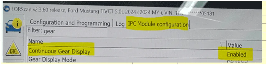

Hello guys, I'm really enjoying my new 2026 GT w/ the A10 automatic trans.
I'd like to always see the current gear I'm in while in "Drive" (not manual mode) displayed within the tachometer readout. It doesnt seem to be a selectable setting I can find. Which is odd -- my wife's Jeep Wrangler allows that.
I am aware of Forscan, and have researched it enough to understand that I am not interested in fiddling around with it.
Question: any way to get that feature activated? Can the dealership do it with their service computer? What specifically should I ask them for?
Thanks guys.

Forscan is it... dealer "usually" won't do it... you can ask them. Any tuning shops near you? They may be willing to do the forscan mod for you. Or reach out to forum members that may be in you area.
Dark Sprite
Jan 13, 2026
307
347
UAE
What you’re asking for is continuous gear display. If you don’t want to deal with it yourself, your best option is probably going to be to find a forum member who lives close to you that can do it. It’s one of the easiest mods you can make in FORScan as it is just a matter of toggling the option from disabled to enabled - less than 5-10 mins effort for someone.

Forscan is so easy to use. And it's free. I enabled my gear position indicator in all of 2 minutes.
Why would you not?

Please don't pay >$100 for this. Takes probably 1 minute, it's literally typing a single digit. You could just offer one of the techs $20 to do it for you after work. Just find a younger looking tech, they'll know how to use computers.
At address IPC 720-02-01, change the 1st digit from 0 to 4.
(There used to be a 2nd change required (720-12-01), but Ford has updated that by default)
