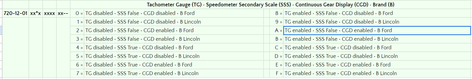

We'll wait for that answer, but I'm betting this ("A") is the correct value to use:

Yeah it’s that one. Change the digit to A. There’s also an option in forscan to view all the editable options as a list.
Current gear is always displayed in all driving modes.
With "a" selected, how does that change the "TG"? Will 2 only change CGD?

Not doubting that, but what change is made to "TG' when A is selected?
Nothing. TG is your tachometer. I guess you could turn it off but it’s enabled by default.
If you have a tachometer showing in your gauges now, then your current value for that digit is an 8. Changing it to A will change nothing except start showing the gear indicator while in drive, regardless of drive mode.
Quick question...When I got in to change my CGD today it had a "C' where I put the "A", I can confirm that it does show what gear I'm in. My question is...should I change it to an "E"? The "C" designates SSS True, "A" designates SSS false, while "E" designates SSS True*CGD Enabled. Is the Darkhorse value different than the GT for that characteristic maybe?
3,260
3,709
If the as-built is a C, then change it to an E.
Confirm. Changed to "E", CGD is displayed. Not sure what changes the SSS did but I couldn't tell anything different as far as dash display goes. CGD displayed with both parameters. Thank you for the clarification. It made sense that everything should remain AB except for the CGD. What I did notice was that each time I plugged my OBD in I had to go in and redo my MyColor, ambient light settings and the perimeter alarm sensors. There was also four DTC's, I left them alone for now as I have no check engine light on that would make me concerned. I'll look into those later when I get more familiar with FORScan. Again, thanks for the help!
