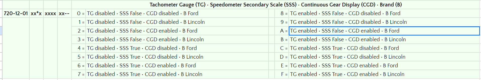

I already read that section and there is no option to display the gear while in D even though the instrument cluster drawing shows the selector in D while showing gear indicator being 3rd gear. It only shows up when I select M.
hi, I have my 2024 displaying the current gear continuously. I had to change a line in FORScan. IPC module 720-12-01
3,260
3,709

We'll wait for that answer, but I'm betting this ("A") is the correct value to use assuming the AsBuilt is 8. If the AsBuilt is C, change to an E.

We'll wait for that answer, but I'm betting this ("A") is the correct value to use:
Yeah it’s that one. Change the digit to A. There’s also an option in forscan to view all the editable options as a list.
Current gear is always displayed in all driving modes.

Which version of FORScan are you using? 2.3.59 or 2.3.60, I presume?
I was using 2.3.60. Now I’m using the latest beta. just a note, the gear isn’t displayed in park, neutral and reverse. Only drive and manual.
