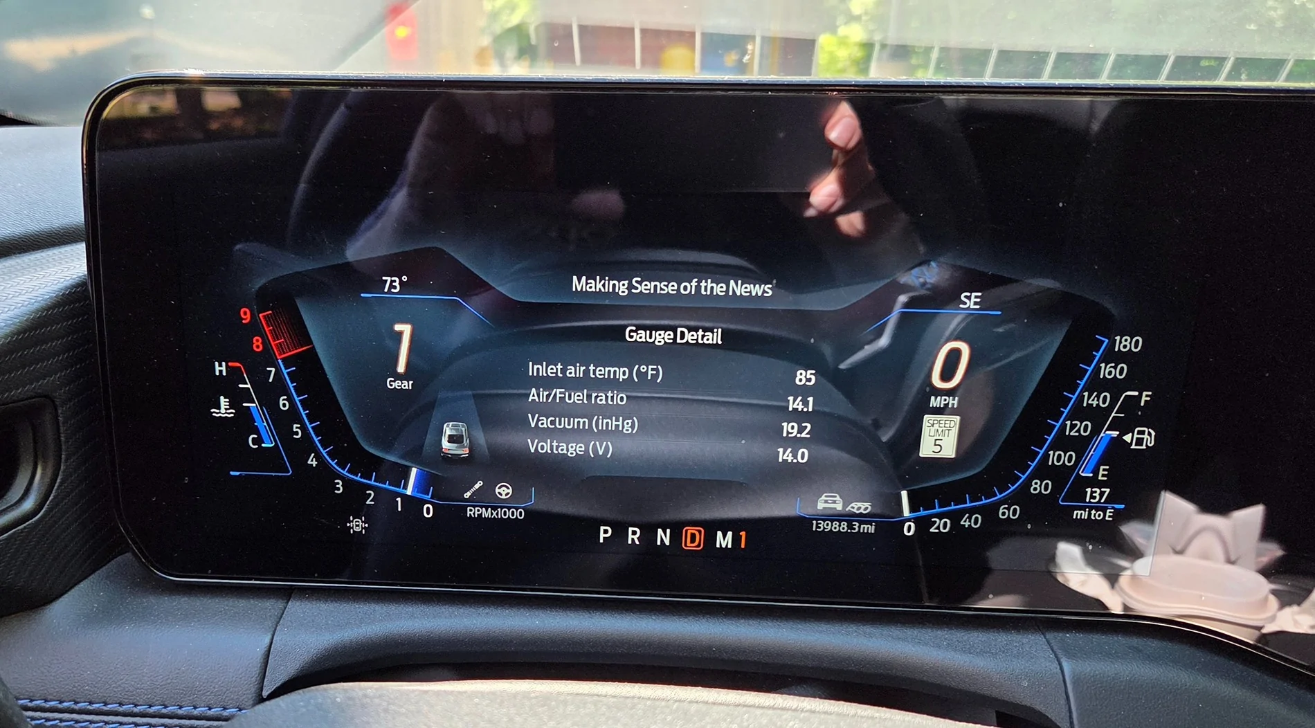

Please don't pay >$100 for this. Takes probably 1 minute, it's literally typing a single digit. You could just offer one of the techs $20 to do it for you after work. Just find a younger looking tech, they'll know how to use computers.
At address IPC 720-02-01, change the 1st digit from 0 to 4.
(There used to be a 2nd change required (720-12-01), but Ford has updated that by default)
It’s even simpler than that, as it’s available to change in easy mode - disabled to enabled.

Is there any downside to doing this?
It seems like Ford would have had it this way from the factory.
It is not terribly important information, but it would be kind of neat to see the gear number displayed when not in manual mode.
Only downside, if you can call it that, is that it will not be displayed twice on the dash. Once in large format in the speedometer somewhere, depending on your dash choice and to the right of the "M" on the PRNDM display. No other issues otherwise. I have had mine enabled now for about 6 months.
