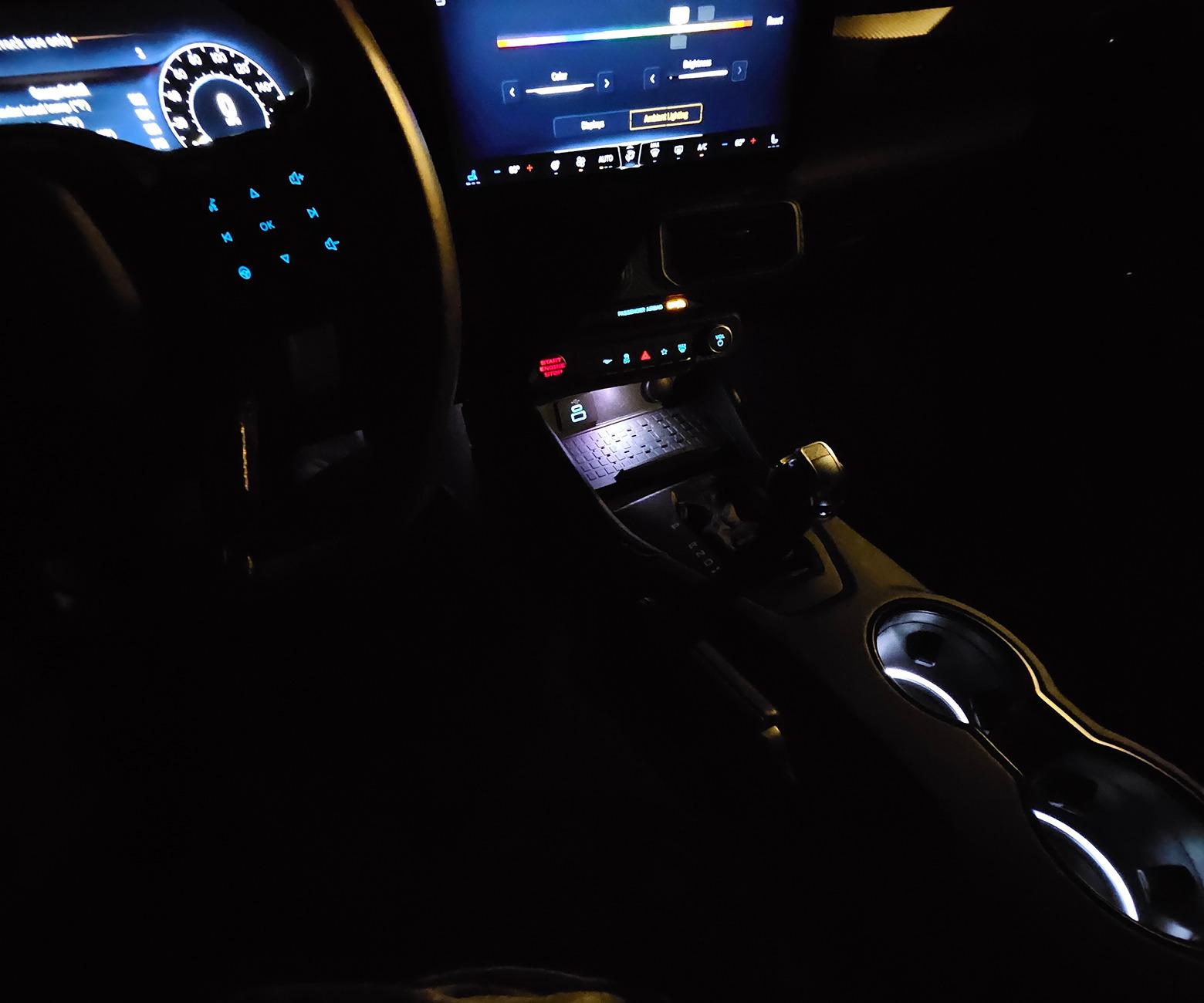

that might have been me. i went to a junkyard and salvaged 6 MyColor LEDs from some wrecked Mustangs, then modified one, drilled a 1/2 inch hole in the plastic above the wireless charger pad and hot glued it in place. this is the result, combined with the cupholder lighting

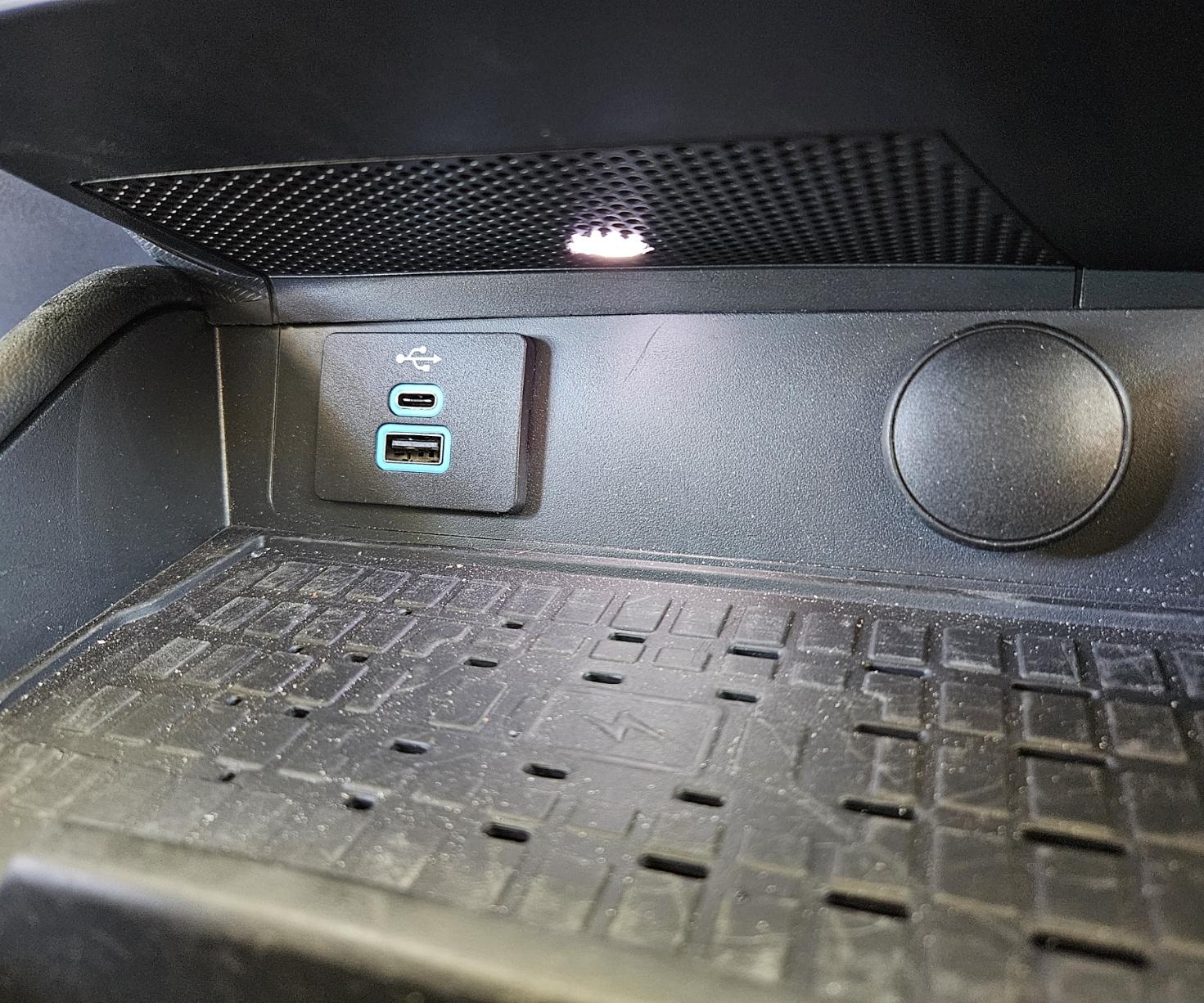

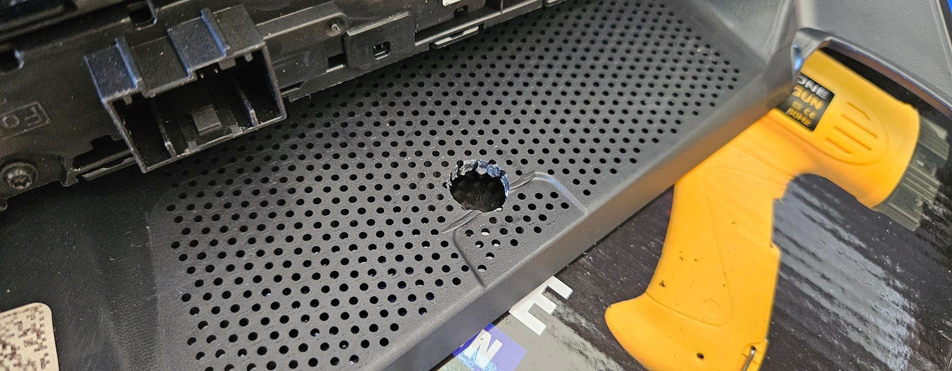

here is where i drilled the hole, centered on some little indent. worth noting that the indent itself is not centered on the plastic piece, so if an off-center light will bother you, find the center point and drill there
