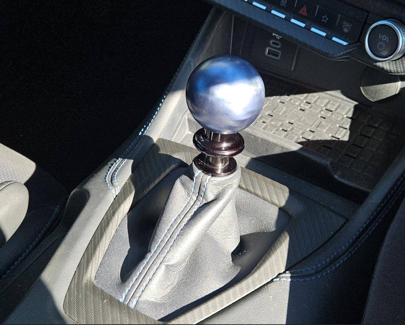

i forgot to share it here, but i got the Billetworkz titanium shift knob and the manual shift boot and installed them, also anodizing the shift knob. here is the final result
S650 Mustang Automatic Shift Knobs 1738224461946-et

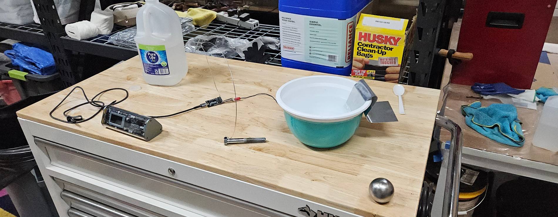

and here was my anodizing setup
S650 Mustang Automatic Shift Knobs 1738224554427-7f
power bank going into a USB-C PD board set to 20V, positive on the bolt the shift knob was threaded onto via aluminum wire, negative on the aluminum sheet that goes into a baking soda and distilled water solution. i used a rotary tool with an abrasive buffing end to remove the shift knob's protective coating first, because otherwise it was just turning an ugly yellow-green

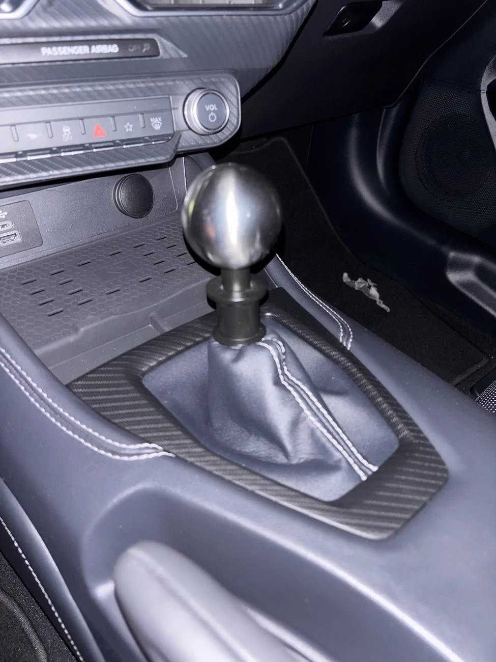

White Madness Garage short shifter and a $35 eBay knob.. worked great on my ‘19 for 60k and removed it before selling… installed on my ‘24 with manual trim.
S650 Mustang Automatic Shift Knobs IMG_2677
