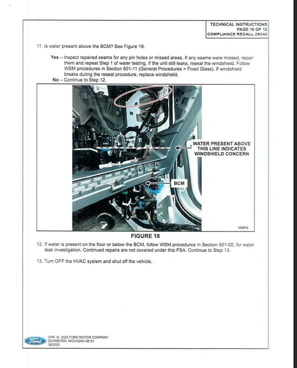

You'd have to remove the right kick panel and do the visible inspection as shown above. If its corroded, there are no BCMS, and the recall info is vague on availability. Based on past experience with Ford, I'd say there are no BCM's available, new car production gets first dibs.

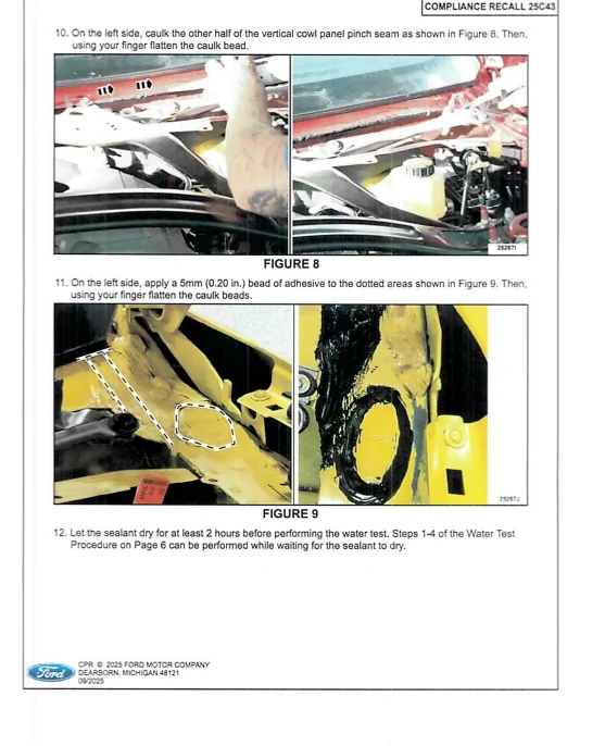

I'm sorry, but it seems that steps 11-13 are missing. I'm just doing screenshots for my dealer, because I'm waiting for delivery. Thank you!
Sorry I cut it off wrong, here's the whole page
S650 Mustang 25C43 Water Intrusion Recall image_2025-09-29_111113661

Jesus. That is quite the process. Why can they not check for leak evidence before doing all that sealer?
I wonder if we could stuff some of those panty shields up there that turn blue when they get wet? You know, like on TV commercials...
If they stay dry, no need to go through all of this. That bit about prying up the windshield kinda bothers me.

The first 2 steps look to be about 2 hours. AS to the visibility, I won't know til we do a few and I can go look at one. Probably Monday, several salespeople have interested buyers and the were calling them yesterday!
I will post the entire procedure on Monday when I get back to work.

i got the recall done today, 100% pass. most of the time was waiting 2 hours for the silicone to cure enough to put the wiper cowl back on. the likely reason why the recall came out early and is a bunch of sealing off the seams is because Ford couldn't quite figure out where water was coming in, or that it was coming in from everywhere
