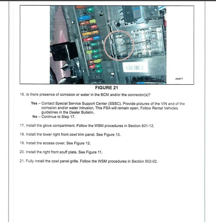

Wow , so if they find BCM damage , as of now you lose your car and they give you a rental until they figure out the next step.
Am I reading this correctly ?
Abe09
Feb 12, 2025
59
Naples
2024 Mustang Ecoboost
Same thing I was thinking... I called my dealership to ask about it just now and she just said they don't have much info on it, if it's something light they'd fix it really quick but if its more than light they'd have to order parts but not sure how long it would take

is there any way to check if it has corrosion/leak before dropping it off at the dealership?
SSuperDave
Nov 5, 2023
532
729
Friendswood TX
You'd have to remove the right kick panel and do the visible inspection as shown above. If its corroded, there are no BCMS, and the recall info is vague on availability. Based on past experience with Ford, I'd say there are no BCM's available, new car production gets first dibs.

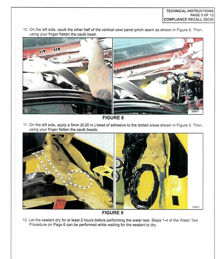

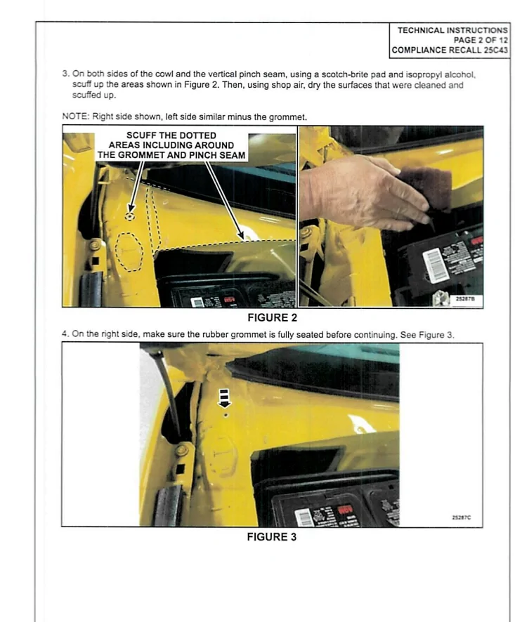

Is this a good solution with the sealing? It looks really not professional. Is it maybe a cheap solution for Ford to keep the costs for this recall down?
