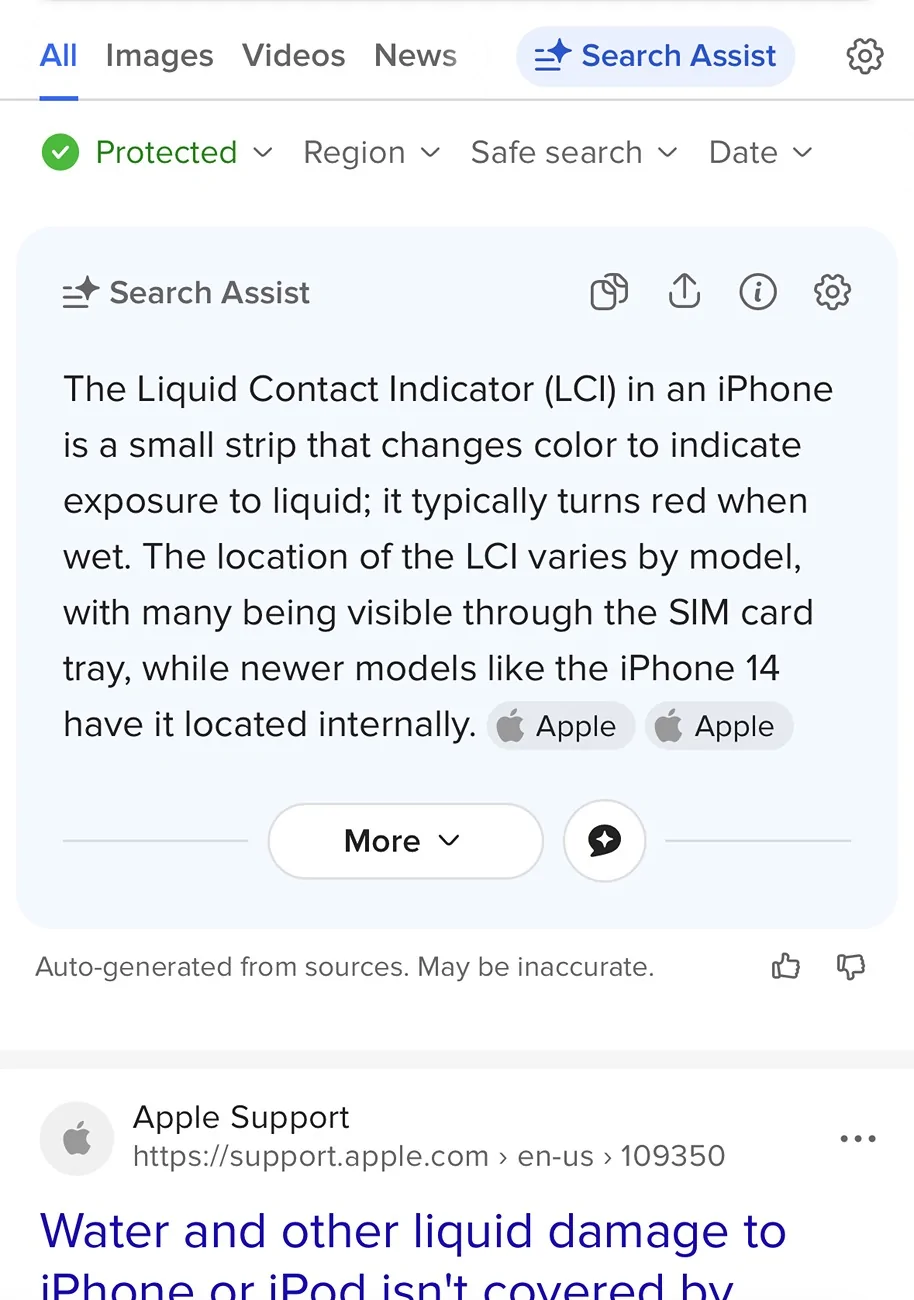

Here in Germany we have THIS at the place where the sealing should be- u know what this is?
S650 Mustang 25C43 Water Intrusion Recall Screenshot 2025-09-30 170744
