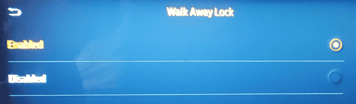

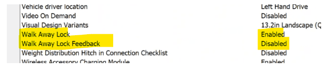

Yes, you can enable the Audible Walk Away Lock Feedback (AWALF). You'll get a single horn chirp when the WAL locks the vehicle.

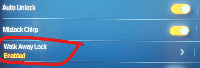

There is a change in the APIM (not the one you quoted) that will add WAL to the Sync screen under Vehicle /Lock / Walk Away Lock. BUT ... it is not operational.

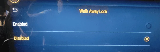

If you enable it, you can disable WAL using the Sync screen:

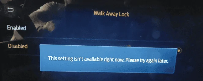

But if you attempt to (re) enable it on the screen, it throws an error:
At this point, the only way to re-enable it is to use FORScan. That's why we didn't include this on the spreadsheet.
There are two BCM changes that enable AWALF and one APIM change that (supposedly) adds it to the touchscreen. I have successfully tested the AWALF itself, but I don't recall checking Sync screen after the APIM update to see if there was a new slider there for AWALF.
Being that it becomes available on the screen after enabling it in Forscan, I wonder if the mothership will add it as a selectable feature in a future update.

They can always do anything they want, but the fact that they did NOT enable it to begin with would lead me to believe they probably won't.
Beyond that, if you read what I wrote, something else is missing. Once WAL is displayed, you can disable it on the screen, but if you try to re-enable it on the screen, you can't. It errors out. The only way to re-enable it is to use FORScan (again), which is why I told @rugedraw that we should NOT include the toggle display for WAL on the spreadsheet.

Well, I can testify that the Forscan change to enable the WAL and AWLAF worked flawlessly on my car. It even shows on the screen. Obviously, I did not try to disable and re-enable on the screen.
3,260
3,709
Yes, I was the one who confirmed all that long ago.
Unless you want to break out FORScan again ... don't do this. :like:
