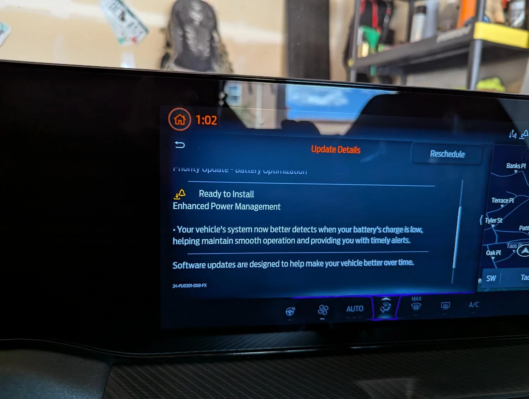

Just a note, but the latest update (24-PU0201-DGB-FX) reset my walk away lock function (and horn chirp) back to the as-built-data defaults. However, my approach lighting edits remained as did turning off auto relock.
3,242
3,587
How long ago did you make the WAL/WALF changes compared to the approach lighting and auto relock changes?
One thing to keep in mind is that, if you make a change, that change will eventually BECOME your AsBuilt data (as stored @ the Ford mothership). There is no set time period that determines WHEN this happens, but the car eventually reports those changes back up and they are what gets stored as your As-Built.
So ... if you made the one changes months ago, but only make the others recently, that can explain why some persisted and others did not.
I finalized WAL/WALF on ~31 July. I had to reedit all relevant addresses save 7D0-09-05--the "C" value in the second group of the address remained resident.
I finalized Approach Lighting on ~31 Jul--all relevant addresses values remained resident.
I disabled Auto Relock on 3 Aug--that setting remained resident.
Again, this just highlights my padawan status and lack of street cred :) But, glad I saved the original ABD prior to making any changes.
Ford mothership...yikes, is that like an Imperial Star Destroyer kind of mothership, I wonder...
