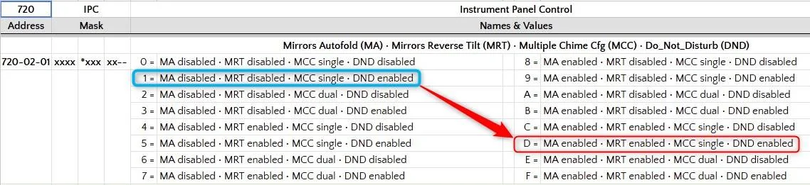

Hello people. Anyway we can update the “common” tab to show how to change the Premium approach lighting to the DH Style? Everything past the Common tab looks like gibberish to me, have no clue how to read it. I have a Job 2 stang, unsure if that changes the lighting numbers.

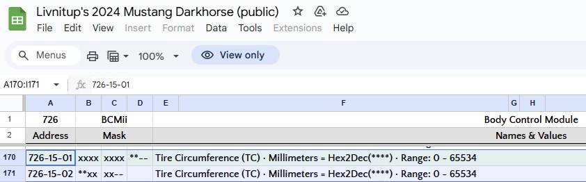

Also, was looking at updating the tire size so it's accurate, and found this in the BCM module. Was trying to understand if -01 is the front, and -02 is the rear (just making assumption here).

those are for the rear tires only. they are the hexadecimal version of the circumference of the rear tires in mm, and the first two digits go in -01, the last two go in -02.
or, if you dont want to do any guessing, you can use a tool i made at this link. you just input your rear tire size and it does all the work for you

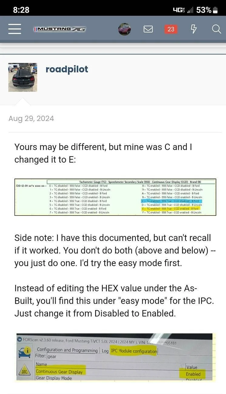

Hey, question. By constant gear display, do you mean you managed to show what gear you’re in at all times with the 10 speed auto? If so, how??? I’ve been dying to figure that out.
TXGT29
Aug 31, 2023
165
72
TX
Yes, follow this:

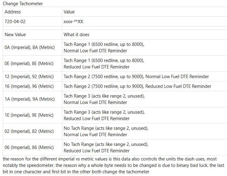

That said, was reading through this thread again.....could someone explain a little more the changes to the tachometer and the different benefits of each of the options?

there really is no benefit to changing that value unless your vehicle has somehow swapped engines. i think the reduced low fuel DTE reminder makes it so that the vehicle will tell you sooner than 50 miles to E that fuel is low

Ok, that's what I figured. Just thought since it was noted at start of this thread there may be more benefit.
