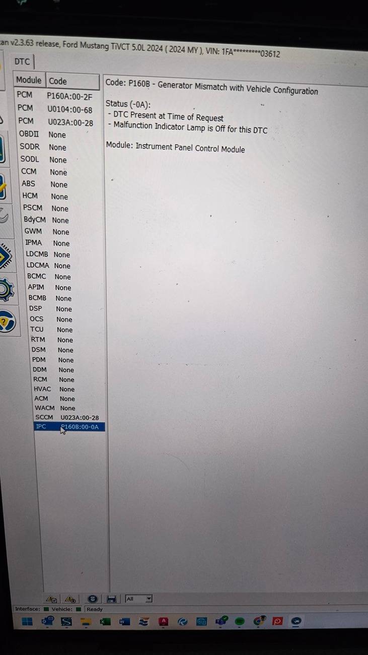

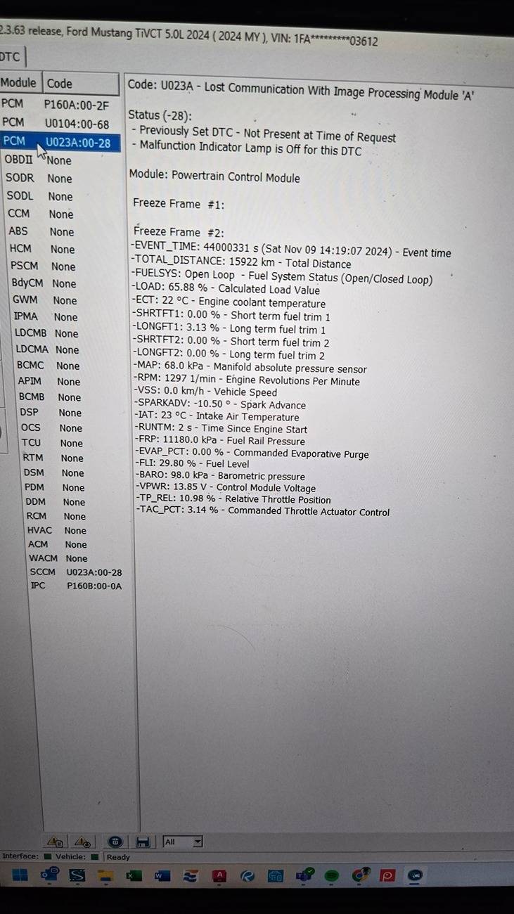

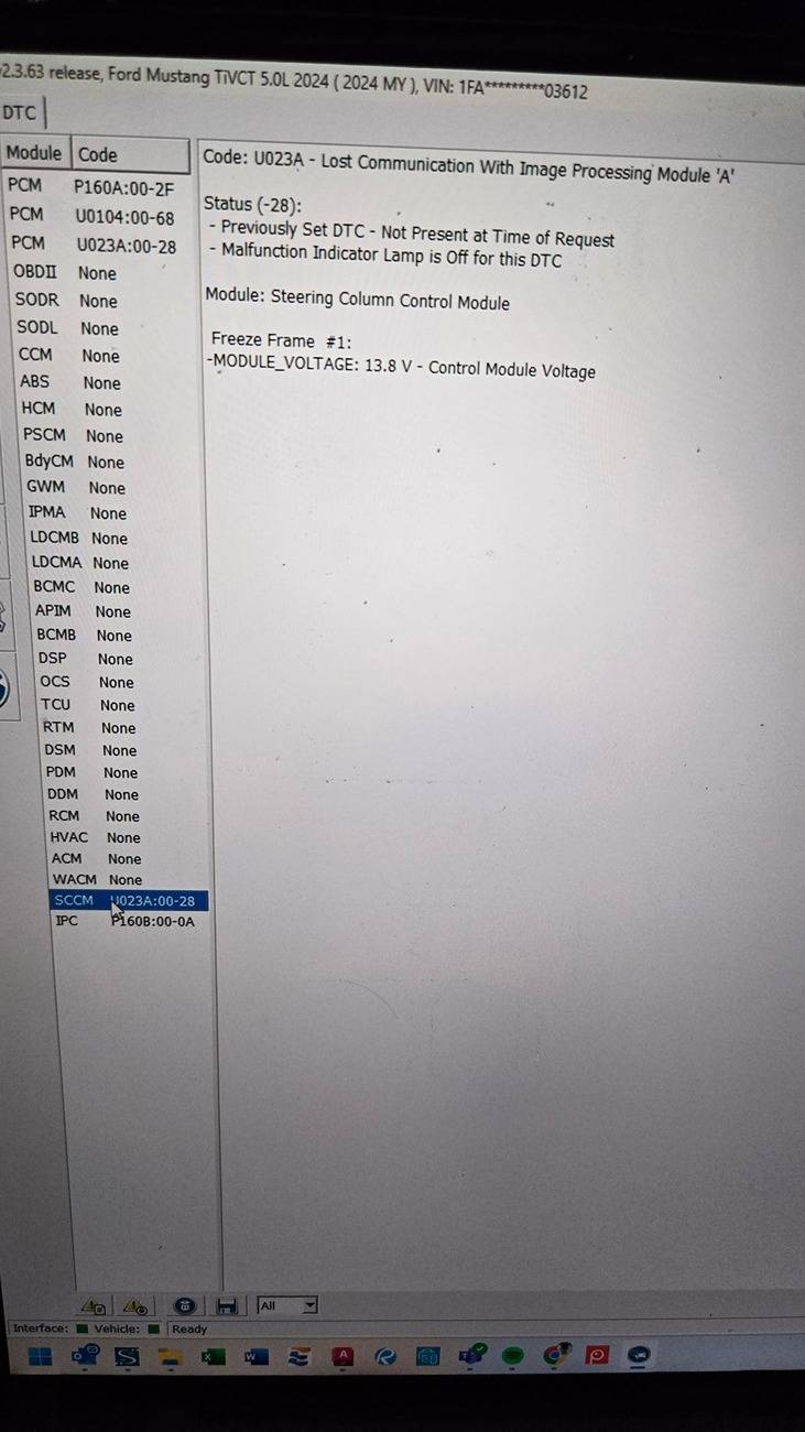

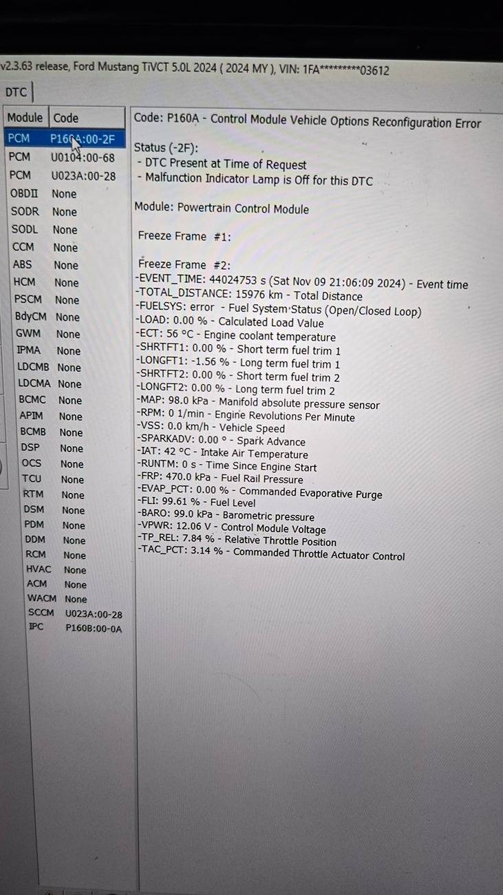

Lastly, since I'm new to this, is it normal to get DTC's after making modifications in Forscan? I've only made minor modifications thus far (DH welcome lighting, WAL, etc.); however, I noticed in Forscan I'm getting some DTC's although they don't necessarily seem related......

finally, that P160A code indicates that the PCM and BCM disagree on something. there should be something in FORScan for the PCM about relearning data, and run that. the rest of those codes are just kinda nonsense and can be cleared and ignored with no issues

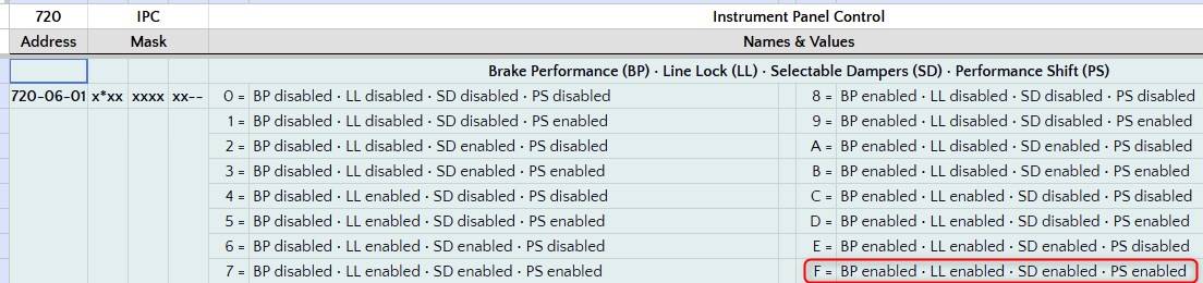

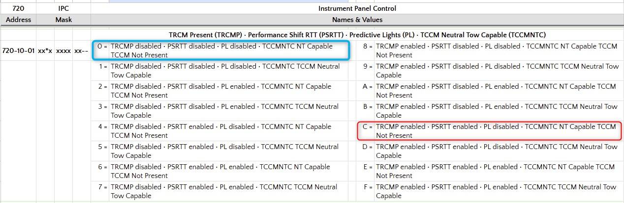

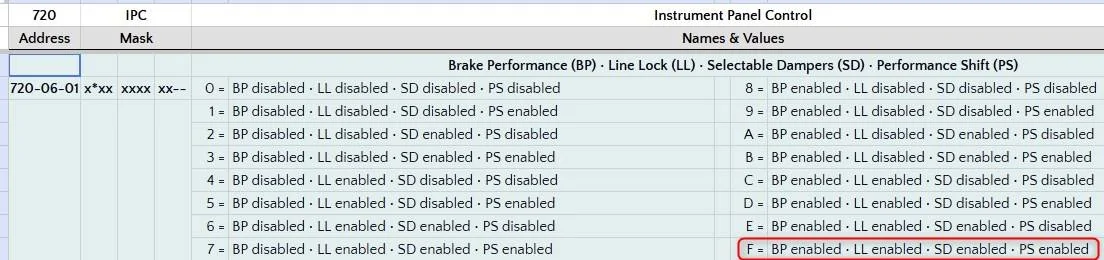

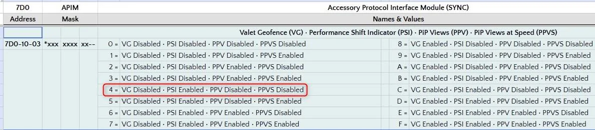

So I was reviewing post #83 in this thread showing As-Built codes from 401a (which I have) and comparing to the IPC 720-06-01 and APIM 7D0-10-03, and it seems like both the performance shift and performance shift indicator are already enabled in both when I was reviewing, unless I"m missing something:
yeah, sure looks like they're already enabled

So just reporting back.....the IPC was set correctly already at "D".....the APIM needed to be revised to "4". Now it shows in track settings.
As far as the PCM, I tried to go in that module and it took a little more time and had me cycle the ignition off and back on, so seemed like that reset it hopefully, but not entirely sure.

no, the PCM thing isnt in the PCM itself, it's in one of the sidebar menus. click the wrench icon to go to service procedures and it should be in there

Ah, ok. It did say something like service procedure complete when it had me cycle ignition off then on. I'll go back into that settings to check again. Thanks.
