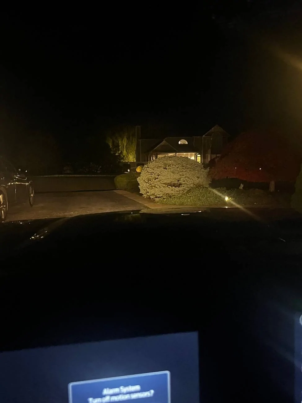

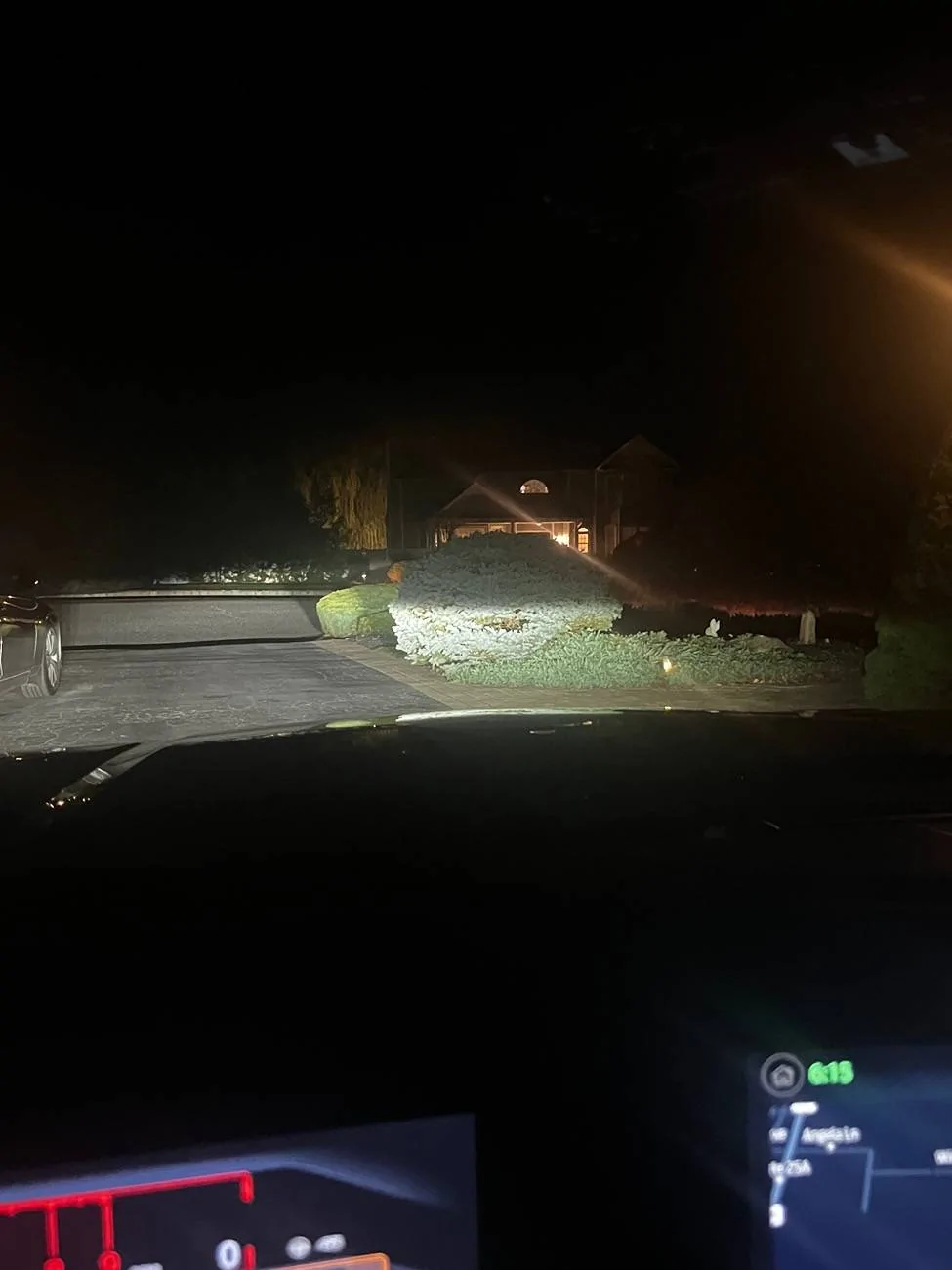

Hey. So I just wanted to show you regarding the amber I was saying. I restored back to factory and redid it, the last line replace second digit with a 2, and the line before it, put a 2 somewhere (forgot it right now). These are pictures of what it looks like. First picture is with the car on, so it’s white. Second, is when I shut it off and the lights stayed on temporarily (the drl’s more so, not headlights). You can see it’s orange ish in color.
gonna be honest, i dont know whats going on
