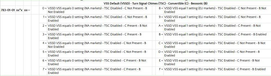

Not sure if anyone tried it. I don't have one of these cars to tinker with myself, but if you want to give it a go:
DSP 783-01-01 xx1x xx--
APIM 7D0-01-01 xxx9 xxxx xx--
Just document whatever is there before you change anything so you can revery back if it doesn't work.

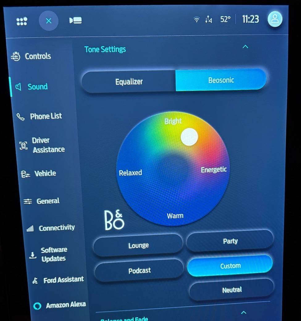

It gives you different ways to set up your EQ int he DSP. Looks like this.
Interesting. Don’t get why this gen doesn’t have any of these sick features other cars do. Walk away lock as standard, etc.

This in particular may very well be there hidden for your guys. Beosonic is mentioned in Livnitup's spreadsheet for these vehicles:
I’d say it’s probably possible.
Just document whatever is there before you change anything so you can revert back if it doesn't work.
So in essence try the same as described in the Mach E forum.. Will try to gather the courage :shock:

looks like this has been a thing for a while
70
2,319
3,434
it works
70
2,319
3,434
Guess I found something else I need to do lmfao. What did you replace it with again? What forscan line / module / correct digits?
go into the dsp and search for Beosonic. then in FORScan, go into the easy mode. APIM and also search for Beosonic
Dsp?
— disregard. Just realized those are 2 modules within forscan, non as built —
