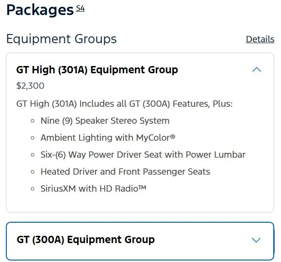

We now know that the non Premium guys don't have acces to this. But now I'm curious if the Premium guys without the 401A, can enable the 401A features. Let me know if you are a Premium without the 401A.
