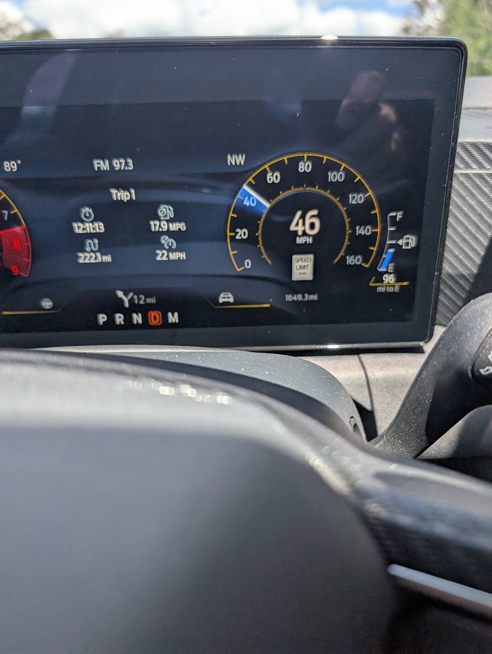

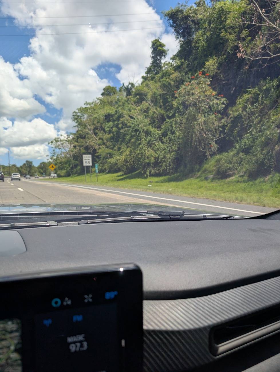

Frustrated beyond words, still the same, not a single speed sign recognition in over a dozen on Rural, City and highway. Double checked, again, every single value before they were changed, but nothing so far.
Is it possible for you to show the Monroney Label where shows all packages that your 300A group included? Mine is a 300A with A10 transmission, Performance and Nite Pony Packages.
