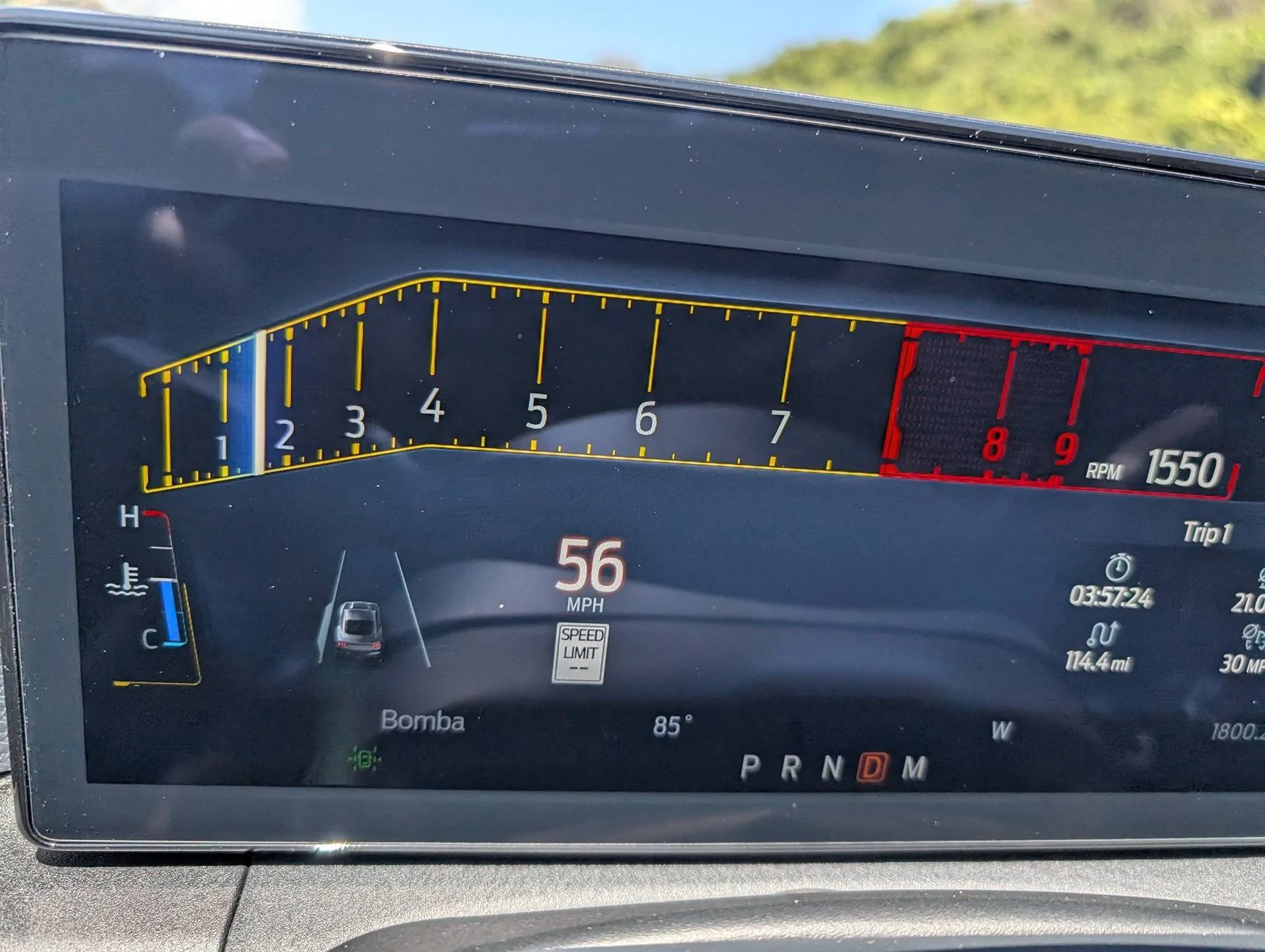

Well, then it makes less sense that mine doesn't work. The only difference is that my signs are in Spanish, but it was told here that making those code changes has worked reading Arabic signs. I'm really frustrated. Thank you.
Try printing out the american sign and see if that would be recognized by your car. If so, the spanish sign might still be the issue.
Definitely is something else and not because of the camera or sensor because they seem to be working with the Lane Keep Assistant aid, it detects when I'm moving from the center of the Lane and adjust it.
So with everything else being equal and even with other 300A group owners having this working the only difference so far that I can see is that my local speed signs with NA forms are in Spanish while most or all of you have them in English.

I knew it was a long shot but I changed my Language Settings to Spanish thinking that will tell something in the code to read the signs in Spanish, but it doesn't help either, so the only other thing I could think of is changing the region somewhere using ForScan.
I'm thinking that by maybe having USA specs and Region by default it's expecting to read signs in English, unless the code allows to read in both English or Spanish but I highly doubt that, all official sugns in US are in English. Maybe by changing Region it may force this to read in the language default in that Region, so basically changing to Mexico or if by any chance Puerto Rico appears there.
I'm not a guy who gives up easily but this has challenged me to keep finding the solution but after so many tries and everybody else having this working changing the same lines of code, are beginning to take its toll on me.
Changing region for Traffic Signs only knows 2.
NA and Rest of World.
I was thinking changing Region in General not just for Traffic Signs. I know for sure changing Regions affects Apps and Sirius XM and things like that, but I don't use or need any other app other Android Auto and don't have Satellite Radio so for me it worth the shot, worst case scenario I can always revert back to default.

I was thinking changing Region in General not just for Traffic Signs. I know for sure changing Regions affects Apps and Sirius XM and things like that, but I don't use it need any other app other Android Auto and don't have Satellite Radio so for me it worth the shot, worst case scenario I can always revert back to default.
Yes, you can change regions in general, but it will not make your traffic sign to work.
What is your theory about me being the only one who haven't put this to work?
At first I thought it was the non premium card didn't have the hardware for it, then I thought that maybe just the 301A group models at least have the hardware connected, but then it was confirmed that another 300A group model by changing the same code lines was able to put it to work and I basically don't have another answer than just maybe it's the traffic signs language, hence why by following that logic I thought that it may force the camera to read Spanish words, this knowing that as you mentioned already, other people have used the same code changes and read Arabic signs.
Like I posted earlier, I'm beginning to question myself if this really worth the hassle, trouble and time that I've dedicated to make it to work, the only think that keeps me trying is the challenge of it.
