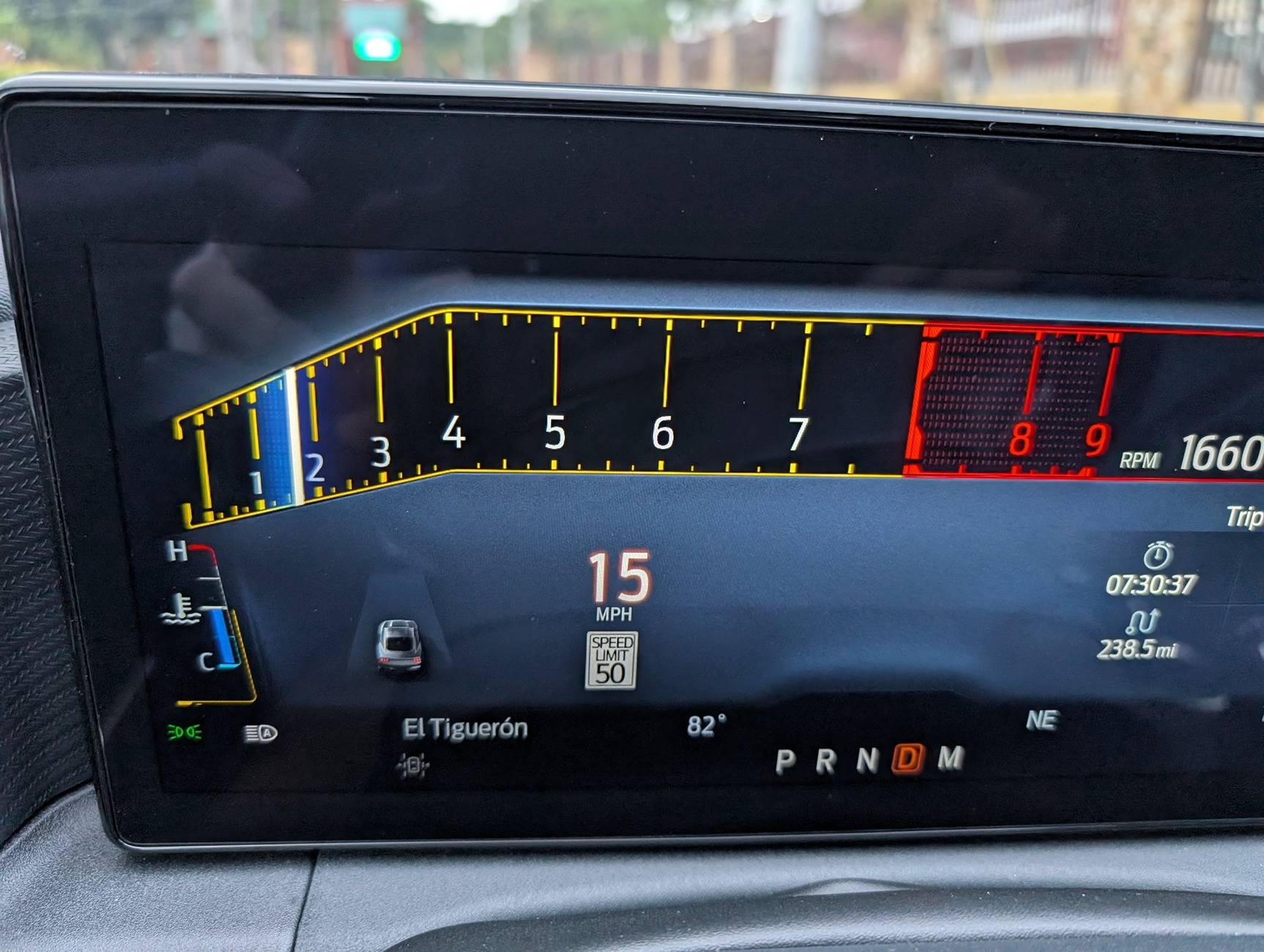

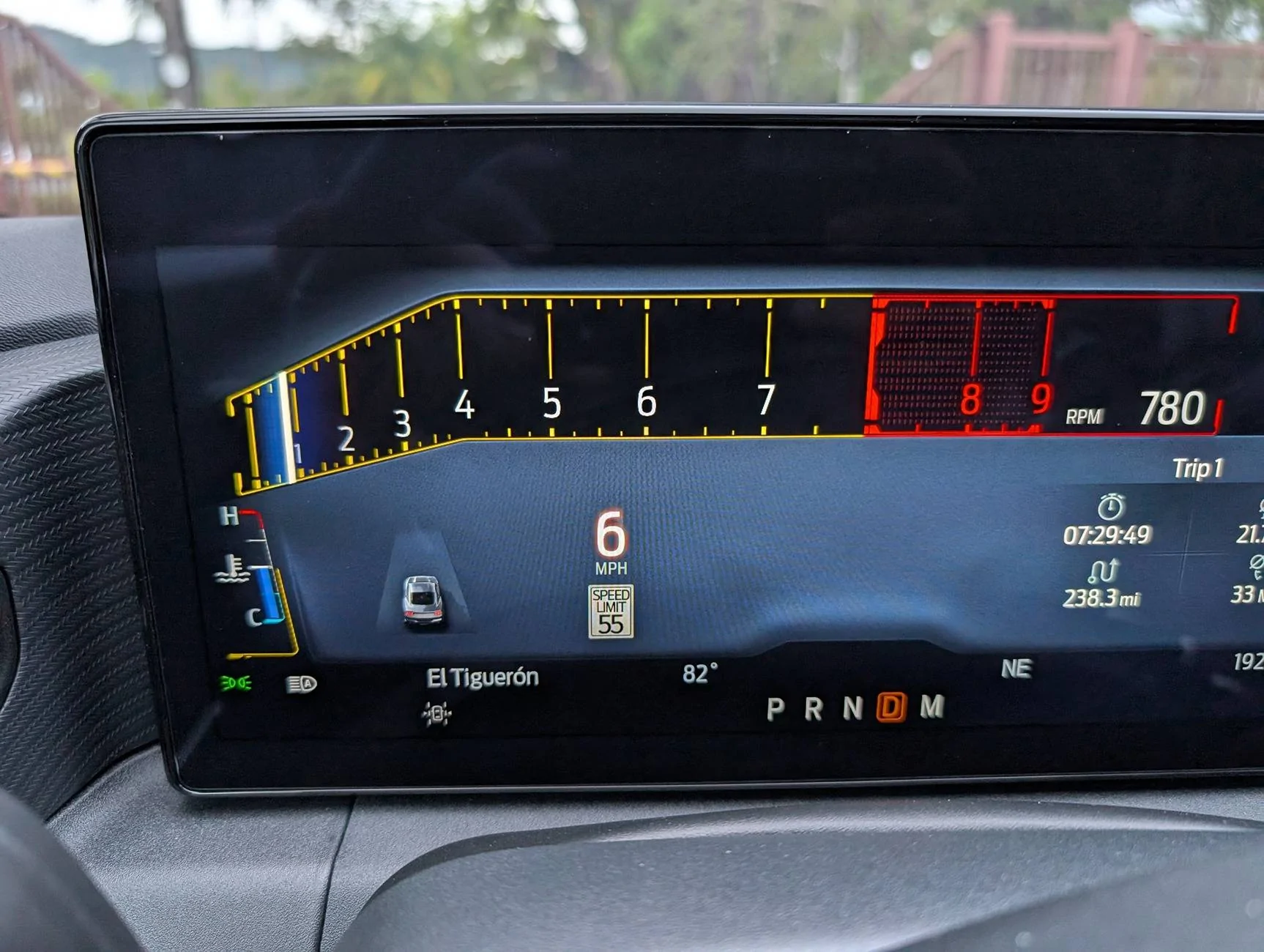

Try this:
706-04-01 xxx* xxxx xx--
Set it to (3)
This is the only thing that is not alligned with your settings. It is now set to ROW while your signs are not from ROW but from NA. It's also a line that the others did not had to change because they already had this value on 3.
If this doesn't work I need to look way deeper and will do that on a day where I have more time.
Thank you , thank you , thank you.
That was it, it was looking for the Non NA signs all along, just by changing that code it immediately began reading the Speed signs.
