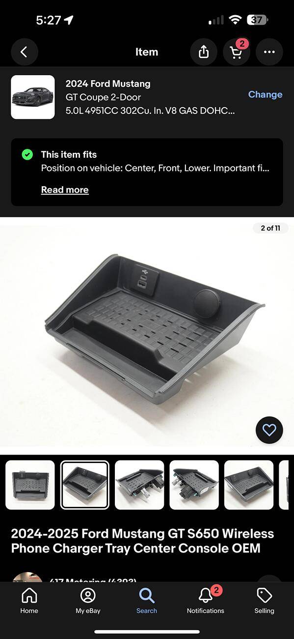

He won’t have that module, once you get the full kit (must have the wireless charging module) take the interior apart, plug up the existing harness (should be there already) and then you need to figure out how to get forscan to recognize the new module. They should be able to help with this. @erasat - I was considering doing this but have heard bad things about the oem wireless charger. Found one take off that was $90 for the whole set. Just minus programming

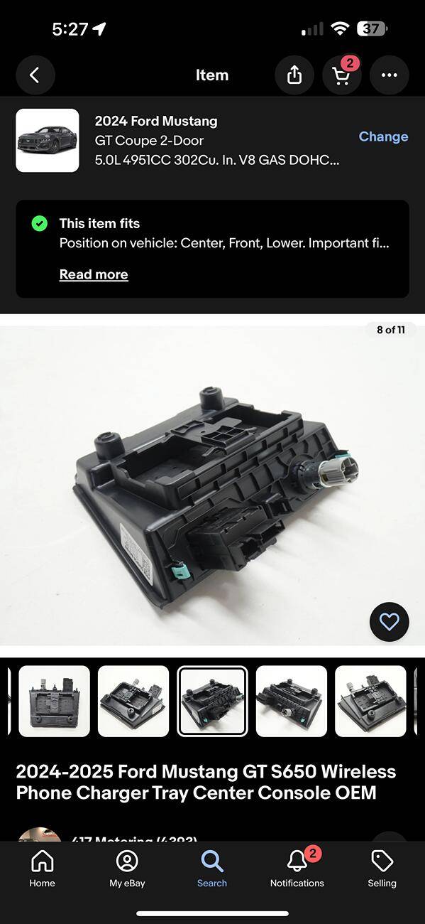

Yeah, the module is what's included with this replacement and it connects to a pre-existing wiring, and yes, you're right, what I'll need is the ForScan code changes for it to recognize it.
That's why I'm trying to figure it out before I order this as I'm really sure I won't pay $400 for the Infotainment one even when they include everything as a plug and play kit, but for me and my little use for it, I can pay the $100 for the one I found but not $400.

Once he plugs in an OEM take off from a premium, he will need to know how to unhide the WACM module in forscan. As the part has not been installed yet however the harness is installed (almost positive) on all base cars.

Ok, I didn't explain well before, it's an OEM take off from another S650 2024 Ford Mustang, It's not an aftermarket piece.
So besides replacing that part with the one that includes the Wireless charger module, the only thing I won't have is the programming tool. So that's why I asked for your help again finding those changes needed comparing my As Built with any other model that comes with this Wireless charger module from factory.

Anyways, if you have the WACM module, this is what the lines are.
725-01-0115074A
725-02-0100F8020029
725-03-01070102003A
725-04-0180C071
725-05-01010303013A
Also you need to enable it in BCM
726-59-01xxxxxxxxx1--
