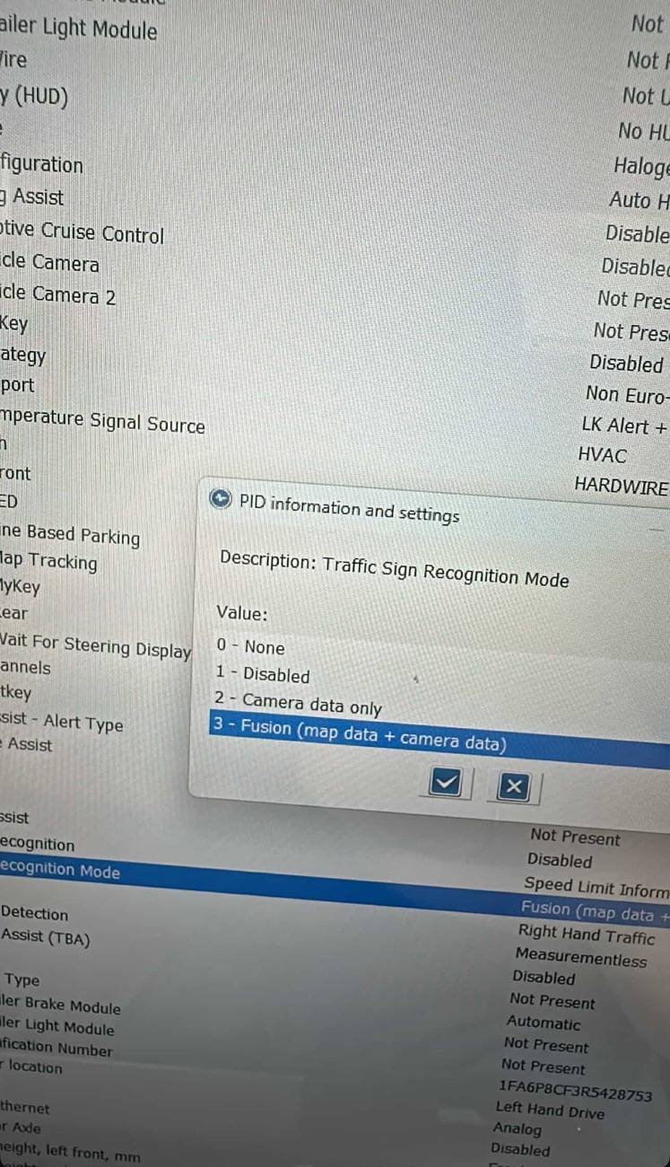

Side note, TSR may be throwing an indefinite DTC in the background for IPMA since we do not have navigation, go into easy mode in IPMA locate “Traffic Sign Recognition Mode” you’ll probably have “3 - Fusion (map data + camera data)” enabled. If so it’s trying to pull
Map data from something that doesn’t exist, swap it to “2 - Camera Data Only” and this will resolve the DTC in IPMA.
Great, I'll check it later, thank you

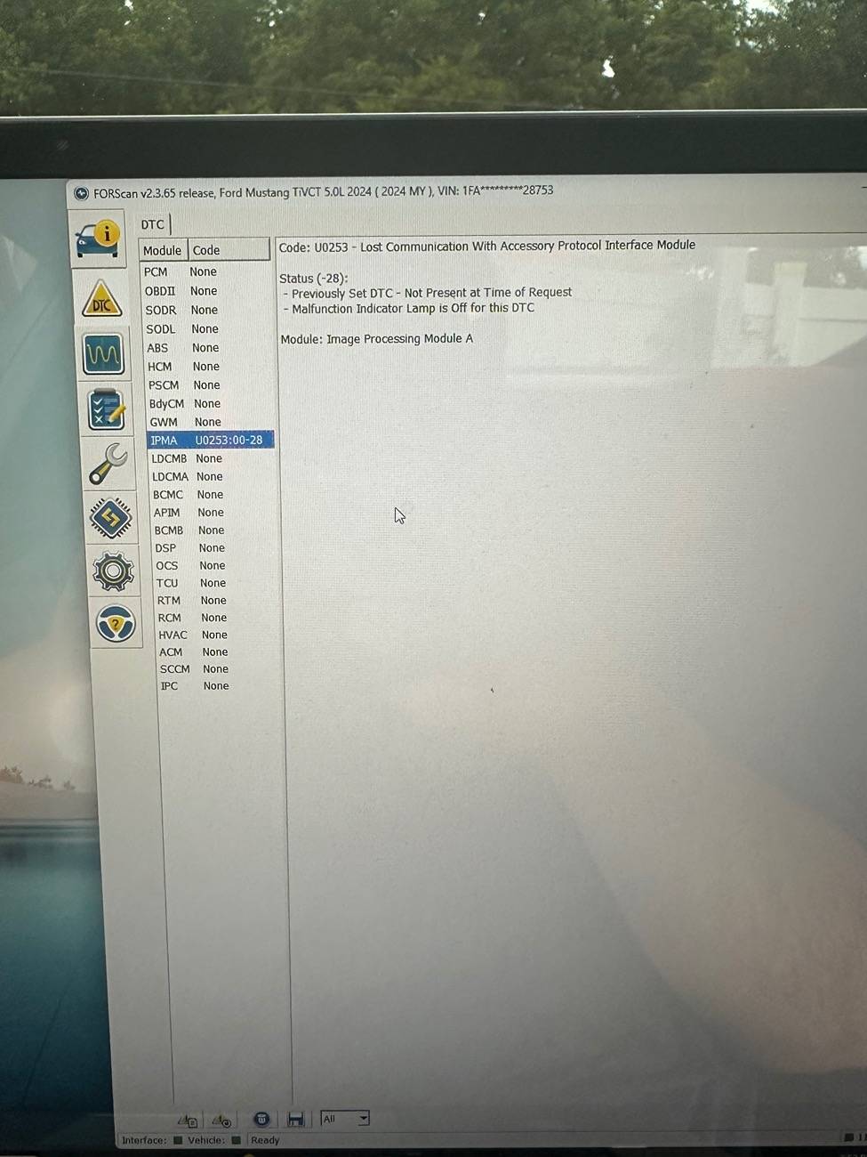

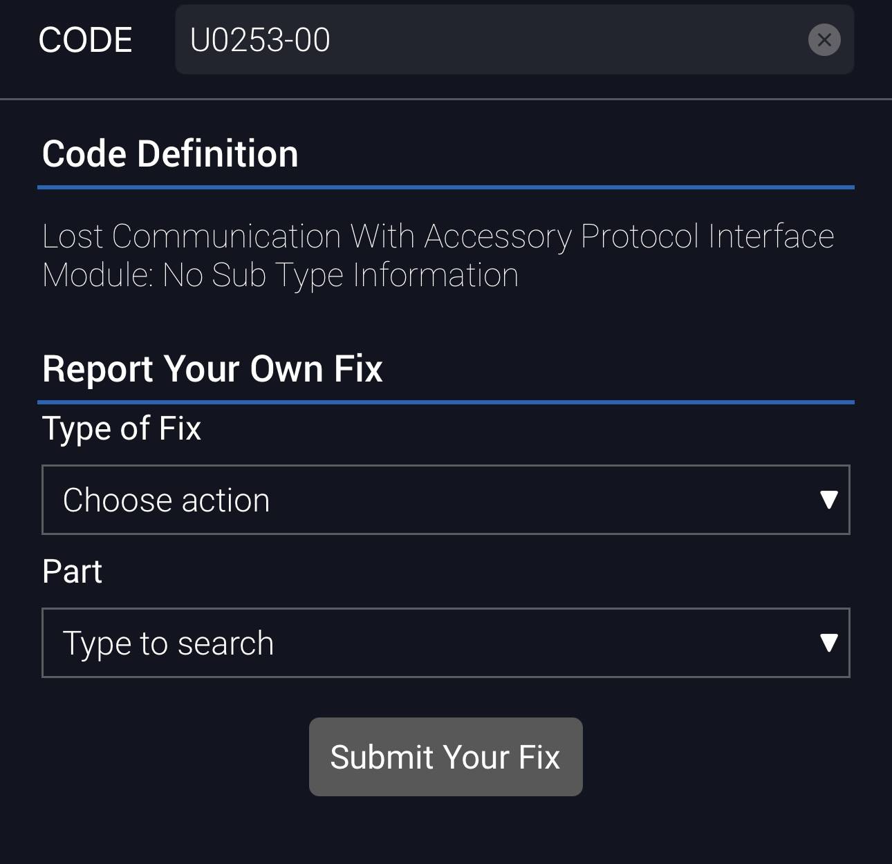

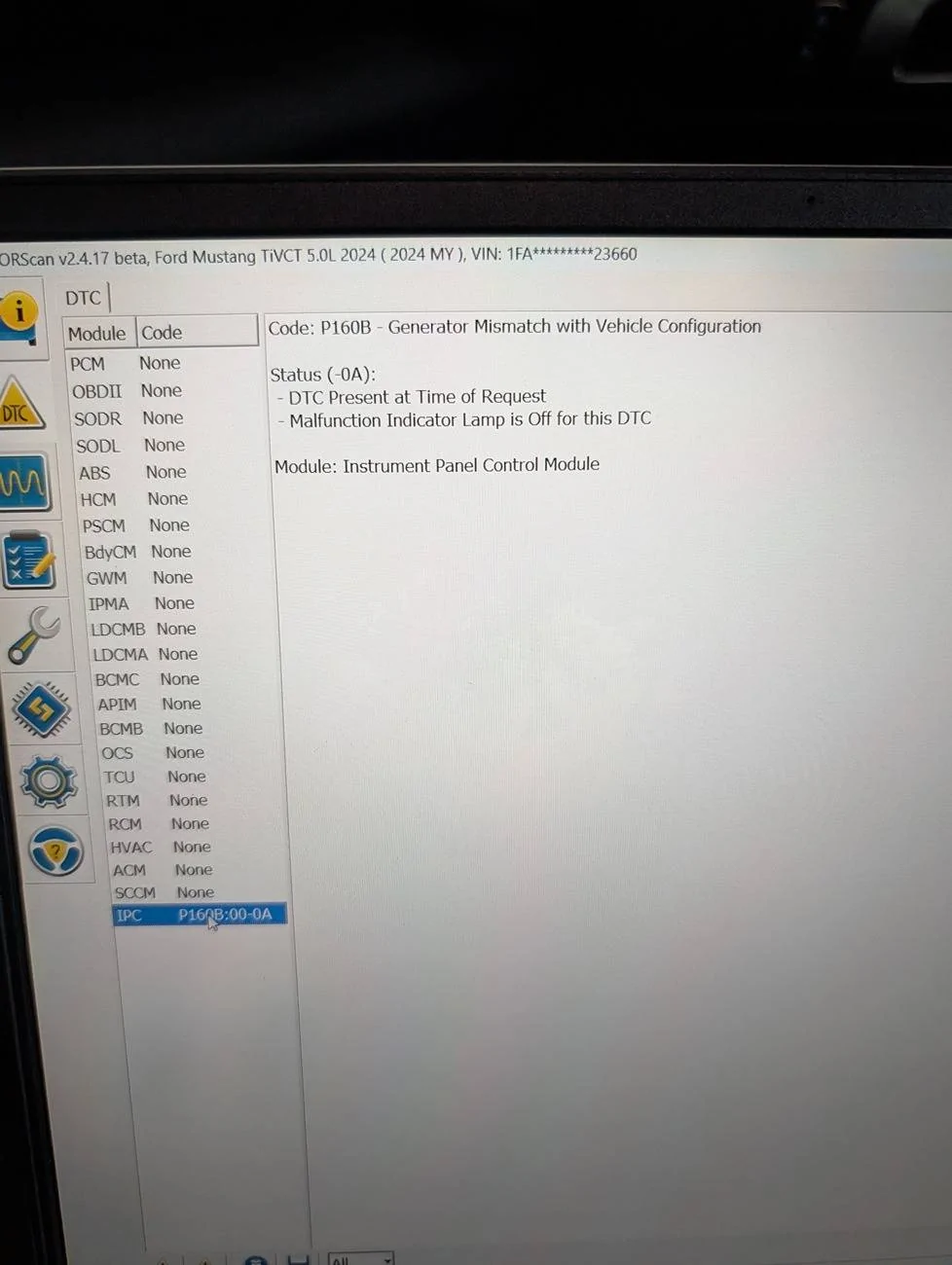

Yes, I had the exact same DTC, so I proceeded to change the value, reset the DTC code and see again and now I just see the other one that I had and didn't see or paid attention to it before. Do you have an idea what to look for for this other one? Latest changes I did for IPC module was to enable TSR.
I just read on another thread about the same IPC DTC code someone else having the same after disabling the Seat Belt Warnings, that was the first thing I did when I got ForScan, not the warnings but the startup seatbelt screen. Just wondering if somebody else might have another theory. Thank you.
