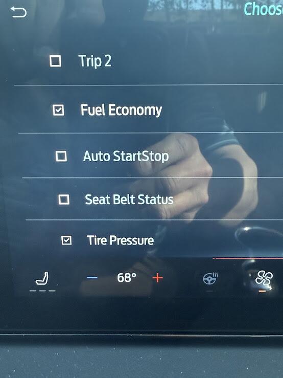

I had the same. Splash screen still there.
I don't even mind the chime because I have my seatbelt on all the time I just hate that if I'm stopped and removed my seatbelt I will get that splash screen which I can't skip or remove until I open the door or put the seatbelt on again:facepalm:

I have that off but when you are in the car put your seatbelt on then off and you will get seatbelt splash screen that you can't skip or remove until you open the door or put the seatbelt on again
Did your change do anything different except canceling the chime?
I changed mine as well, but I don't remember if anything changed since I didn't really pay attention on how that splash screen works.
But yeah, just like your description, that's how mine works after the change.
