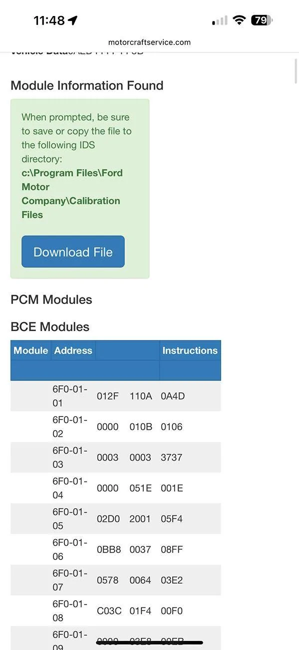

@erasat it gives you all the ASBUILT data on https://www.motorcraftservice.com/AsBuilt
Without needing your computer or even needing to be at a dealership you just gotta grab the vin from their website and download it and convert to a text file to upload on here (at least from what I’ve read previously you have to convert it idk for certain) and I’ll include an example photo of me using my vin
Here are 2 Txt files from my car, the one that says Formatted is to be able to read it easier, the other one was just changing the Name Extension from AB to TXT.

And here are the 2 Txt files from the Premium Car from the dealership. The one that says Formatted is to be able to read it easier, the other one was just changing the Name Extension from AB to TXT.
Mine is a 300 Group with Performance Package and Nite Pony Package, the one from the dealership I wasn't given the Group number but it's a Premium Package with no Performance or Nite Pony Packages.

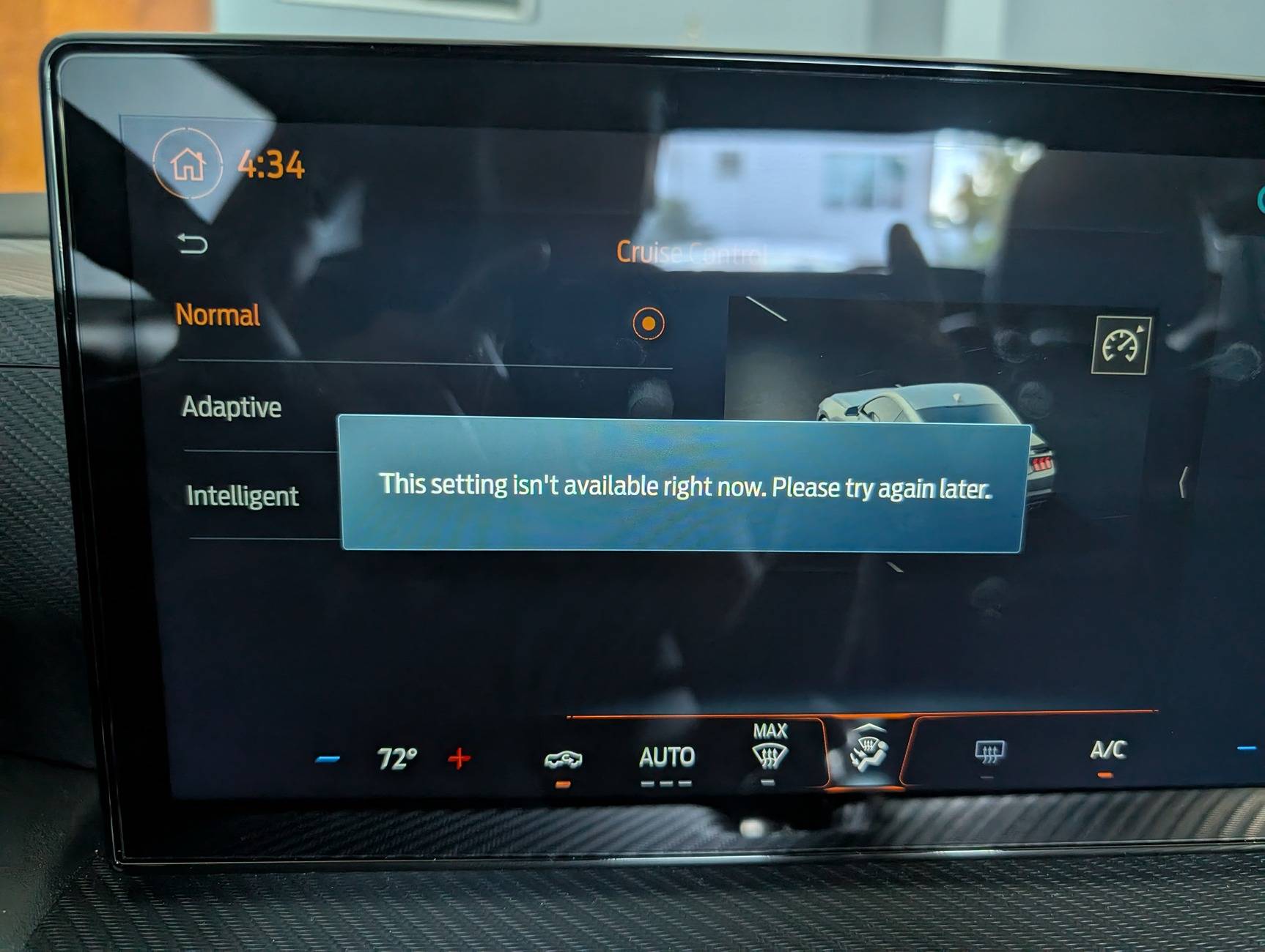

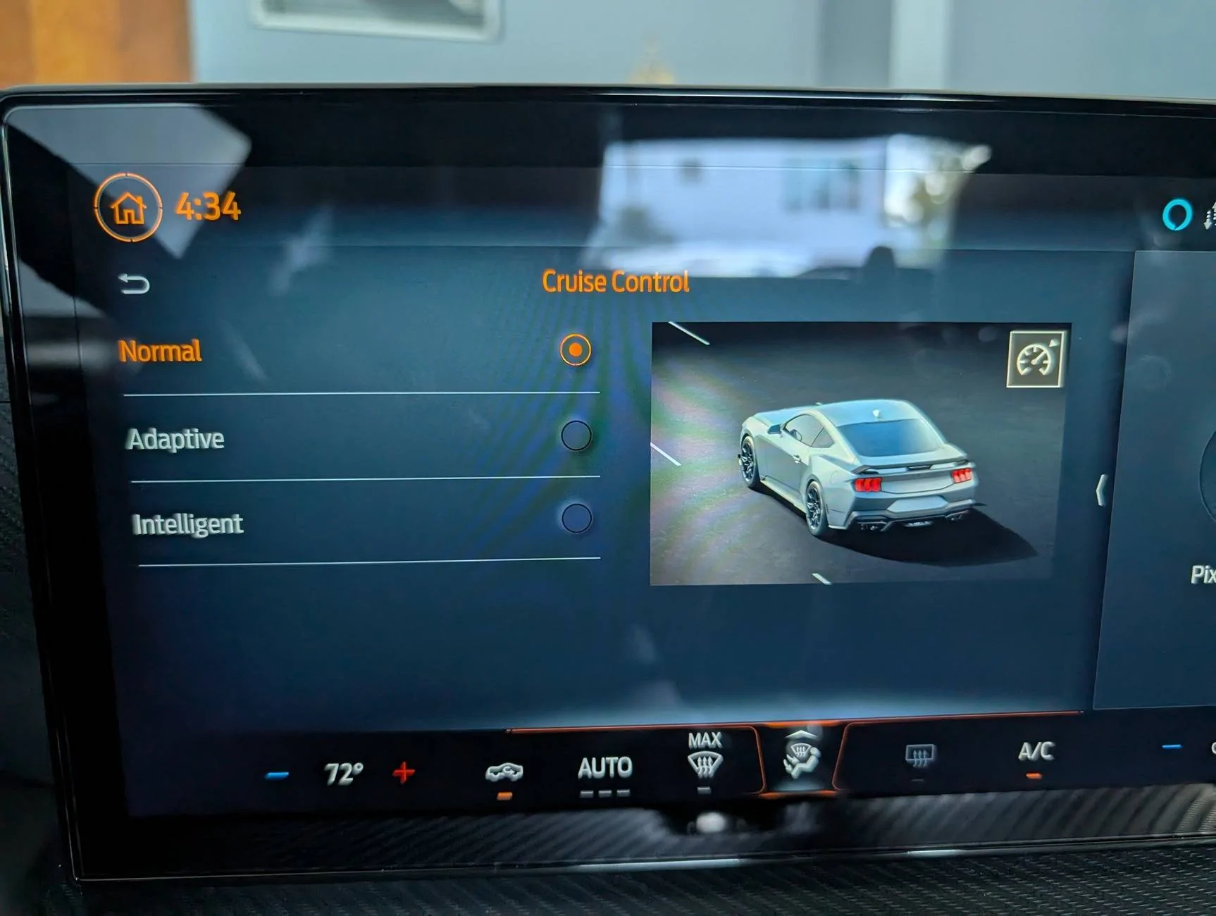

Well, I just tried all changes and still no Speed sign Recognition and I went through 3 of them and the ACC seems to appears on the menu but it can't be activated there and obviously it doesn't work, just regular Cruise Control.
I'm leaving in about an hour until Sunday afternoon, but I'll keep monitoring this thread to see if this works for sky and any other that may want to try, at least none of this is working on my 300 group Performance & Non Premium even with it seems to have a sensor or camera behind the mirror and has the plastic division on the grill where it supposed to be located the radar.

@erasat @sky5oh
I'm sorry guys, I can't find your CCM module in your as-built. If I look at mine, I have this module.
This module is needed for ACC.
Either you don't have this module because the hardware is missing, or it needs to be activated somehow but that goes beyond my knowledge at the moment.
But I found one last resort to find out if you have a CCM. Just give me time to find out today.
To be continued..
