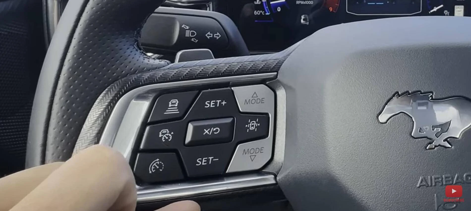

I haven't researched the ACC yet since I only looked at TSR since I needed it to change from NA to EU.
But if you ware interested I can check tomorrow.
Honestly I don’t think that one will work just because I think there’s gotta be more advanced tech in it. But who knows. I wonder what would happen with just using the cruise control button with default advanced enabled?
I'd also love to have it and looking at that which bottoms are missing in our steering wheels, one of them I'd never use and that's the Speed Limit Assist, so there's just 1 that may be needed and that's the Car distance adjuster and if I take in consideration that in all my current cars and the ones that I've had before with Adaptive Cruise Control, it's something I set once and never have to go back to adjust, I think I could also live with using current buttons to activate Adaptive Cruise Control instead of the normal CC and we would have the most useful ones that are the speed up and down and to restart it after breaking it stopping it for a moment.
@GrabThatBlue, wherever you are looking for this information that we don't, if you could help us trying to put ACC to work, we would really appreciate it. Thank you.

I'd also love to have it and looking at that which bottoms are missing in our wheels one of them I'd never used and that's the Speed Limit Assist, so there's just 1 that may be needed and that's the Car distance adjuster and if I take in consideration that I'm all my current cars and the ones that I've had before with Adaptive Cruise Control, I'm that's something I set once and never have to go back to adjust, I think I could also live with using current buttons to activate Adaptive Cruise Control instead of the normal CC and we would have the most useful ones that are the speed up and down and to restart it after breaking it stopping it for a moment.
Well, I can try and find the exact values for your car to enable ACC, but I can't help you with missing buttons or other hardware. I'll go look at the values after I finish my day at the beach and come back to ask you again what lines I need to see from you.
Maybe it's better to send me your AS built data, so I don't have to ask for specific lines.

Yeah I’m in the same boat as erasat, I’m just interested in the improved cruise control if it’s even possible. Personally I doubt it’ll do anything. However if there’s a small chance that it improves it I’d love to test it out. Isn’t lane keep assist even improved with the adaptive cruise control? I know my buddy says it basically drives the car for him and he only has to nudge it every 30 seconds with cruise control.

Yes, as you can see in my previous post, I think that from the 2 missing buttons one I'm sure I won't use it anyway, and the other one about the car distance may be manageable without it.
But I'm leaving at around 6pm EST to our Beach retreat until Sunday and it won't be with the Mustang, so in case we can't coordinate before I must leave, I can try it after I combe back home Sunday afternoon. Thank you, and enjoy you too.
