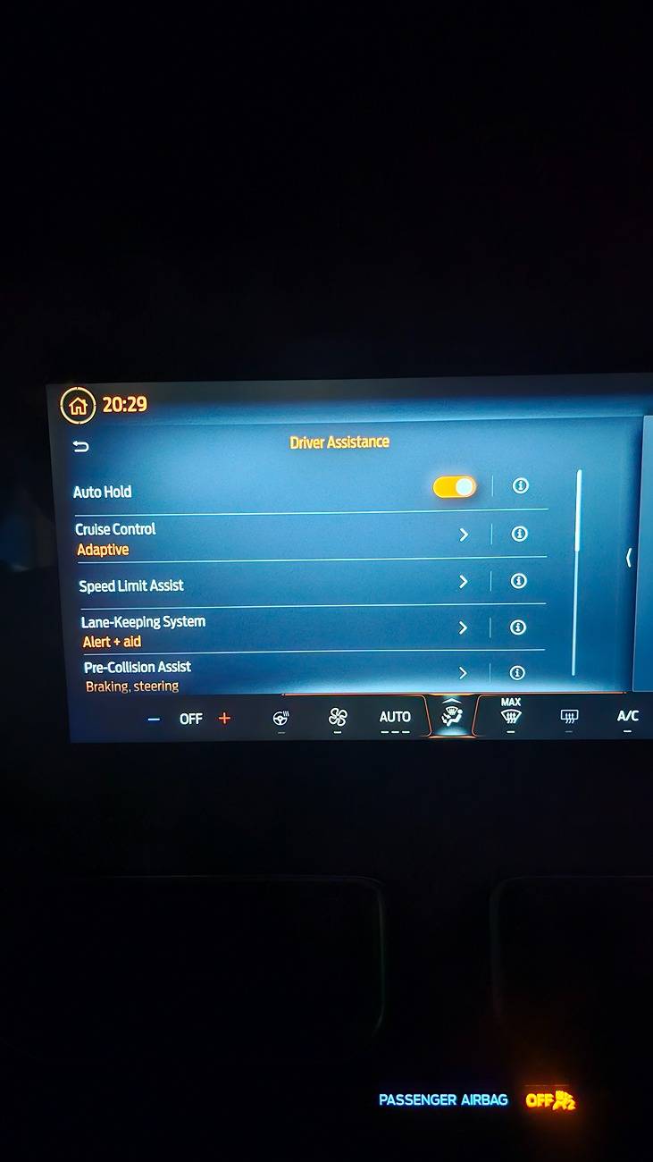

Honestly I don’t think that one will work just because I think there’s gotta be more advanced tech in it. But who knows. I wonder what would happen with just using the cruise control button with default advanced enabled?

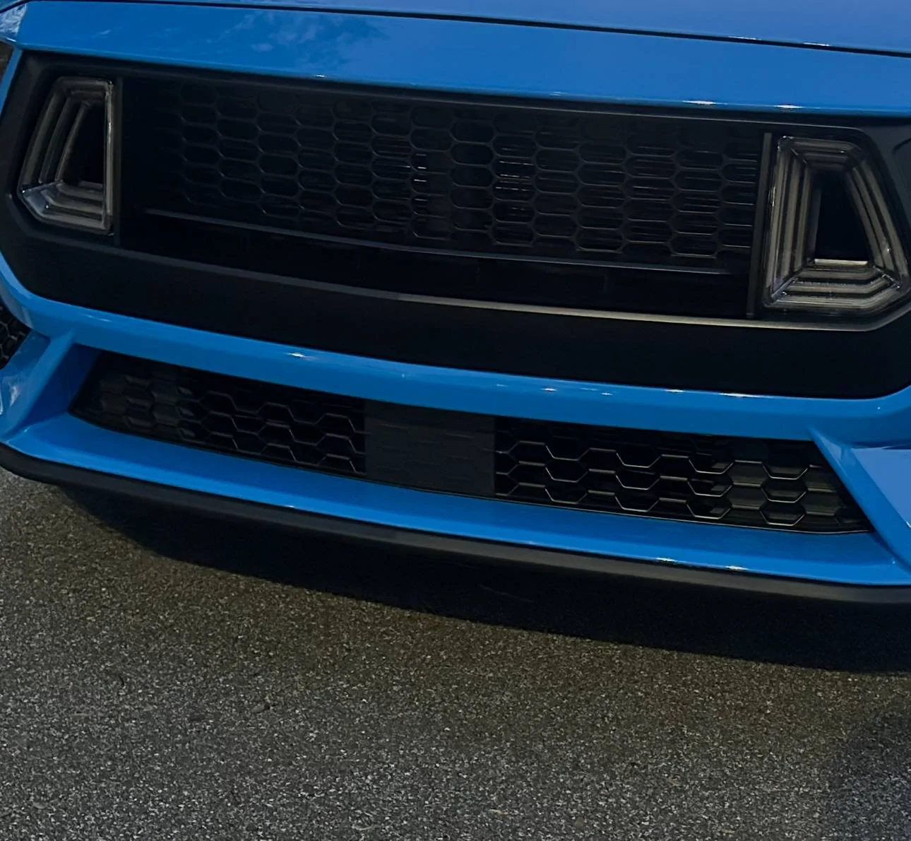

Do you have that square black box in the middle of your lower grill?

Speed sign recognition is working with the front camera. But yes, it can also work with navigation data, but that is not accurate.
Well, I just realized that mine is not a 301 group but a 300 group instead, again, I hope that mine also works because I think the difference between the 300 and 301 is related to the Sirius XM Radio and Dual Zone Climate, none of that should affect the Speed Signs Recognition, I'll know soon.
Do you have Navigation with your 301 group?

Yeah it’s there
So you have that and you also have the camera in your windshield. I don't know what else you need to make that work. Only problem is you don't have the button to try it out after enabling with Forscan.

You copied all the lines I gave to erasat to make yours work? He has a slitghly different trim and the numbers I gave him are for his specific car. Most of the time it works but there could be some options you might have disabled or enabled by doing that. Best is to adjust your values based on your own car to avoid errors.
Yeah I copied the ones you gave him and backed up my originals just in case. Everything seems to be working good.
With that being said, I wonder if it’ll enhance the current cruise control any without the buttons. Wanna try it?
