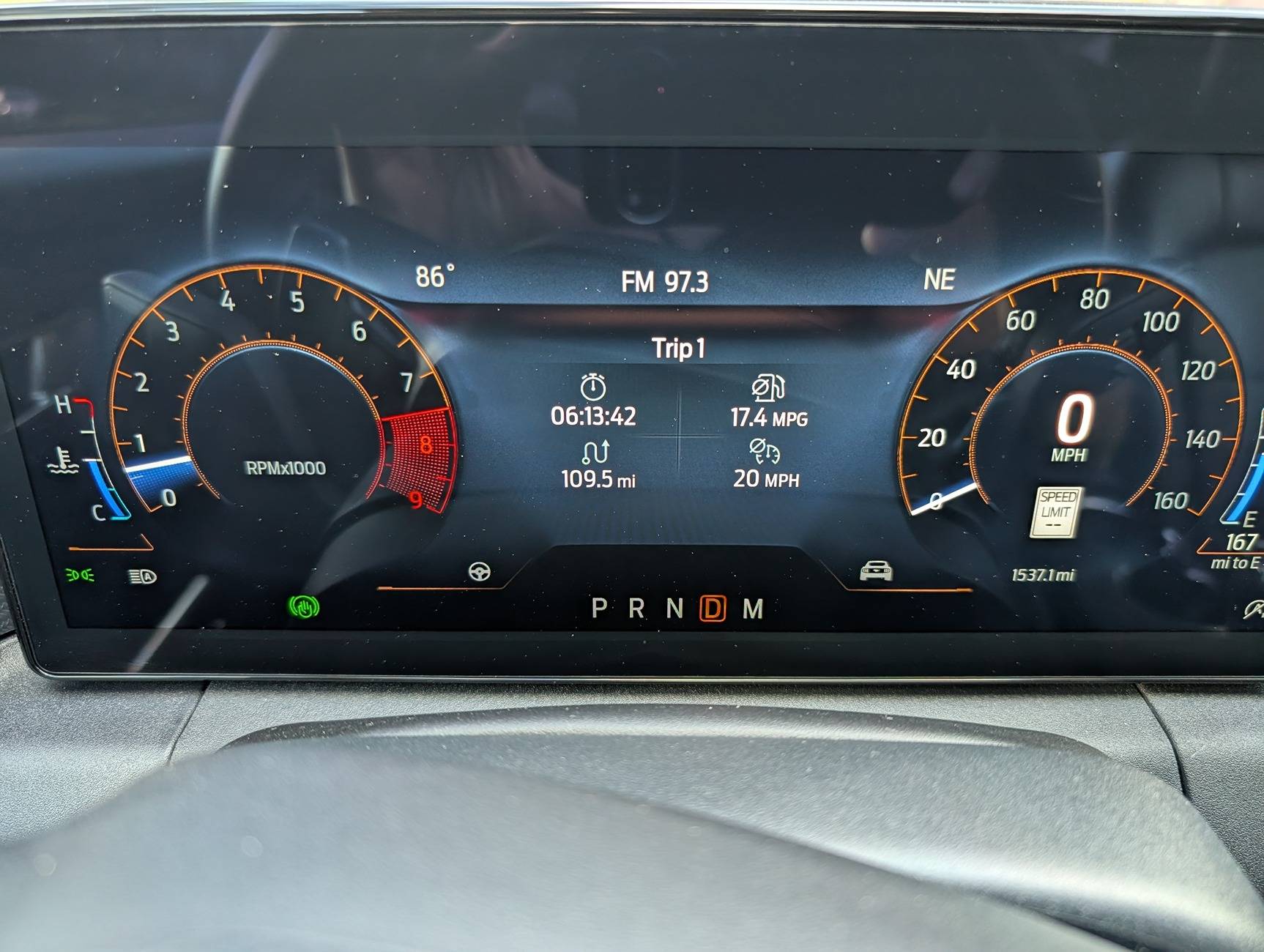

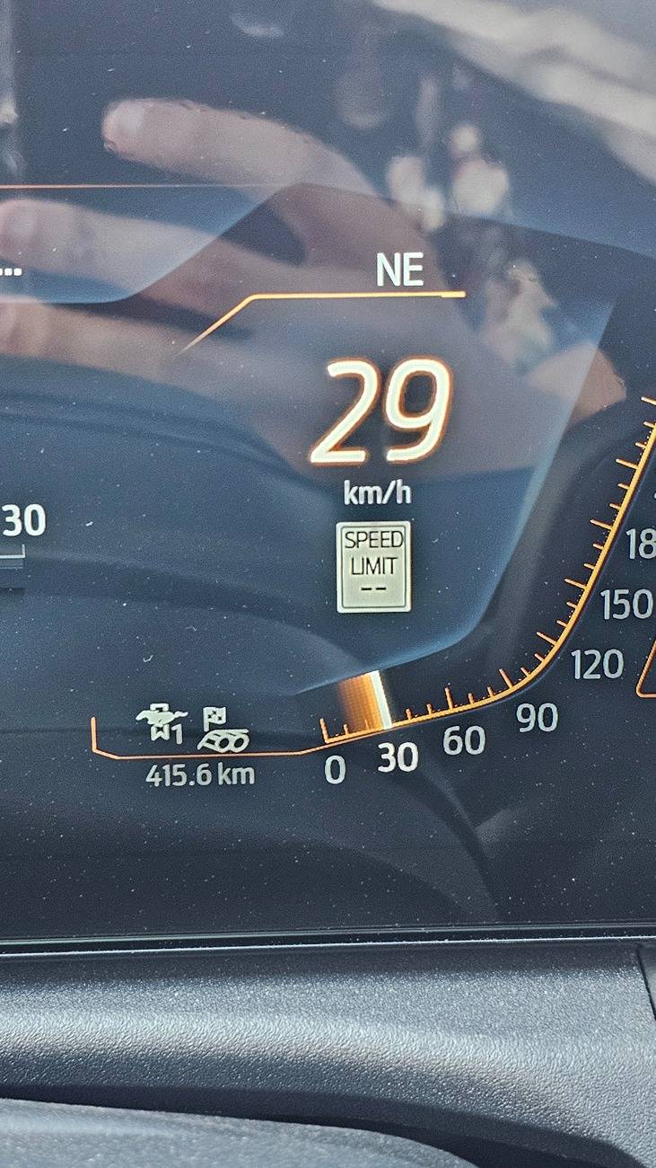

Okay cool, let's hope your car has the hardware for it to read the sign.
Yeah, your speed limit sign looks a bit to the left. No idea why.
Keep us updated.
Ok so I assume yours and the others with this working from factory is centered under the Speedometer? Well, let's see if it works with a regular sign, I hope so. But in case it doesn't, what do you recommend me, to put everything back as it was or maybe just one of those changes is the one that can turn it on and off?

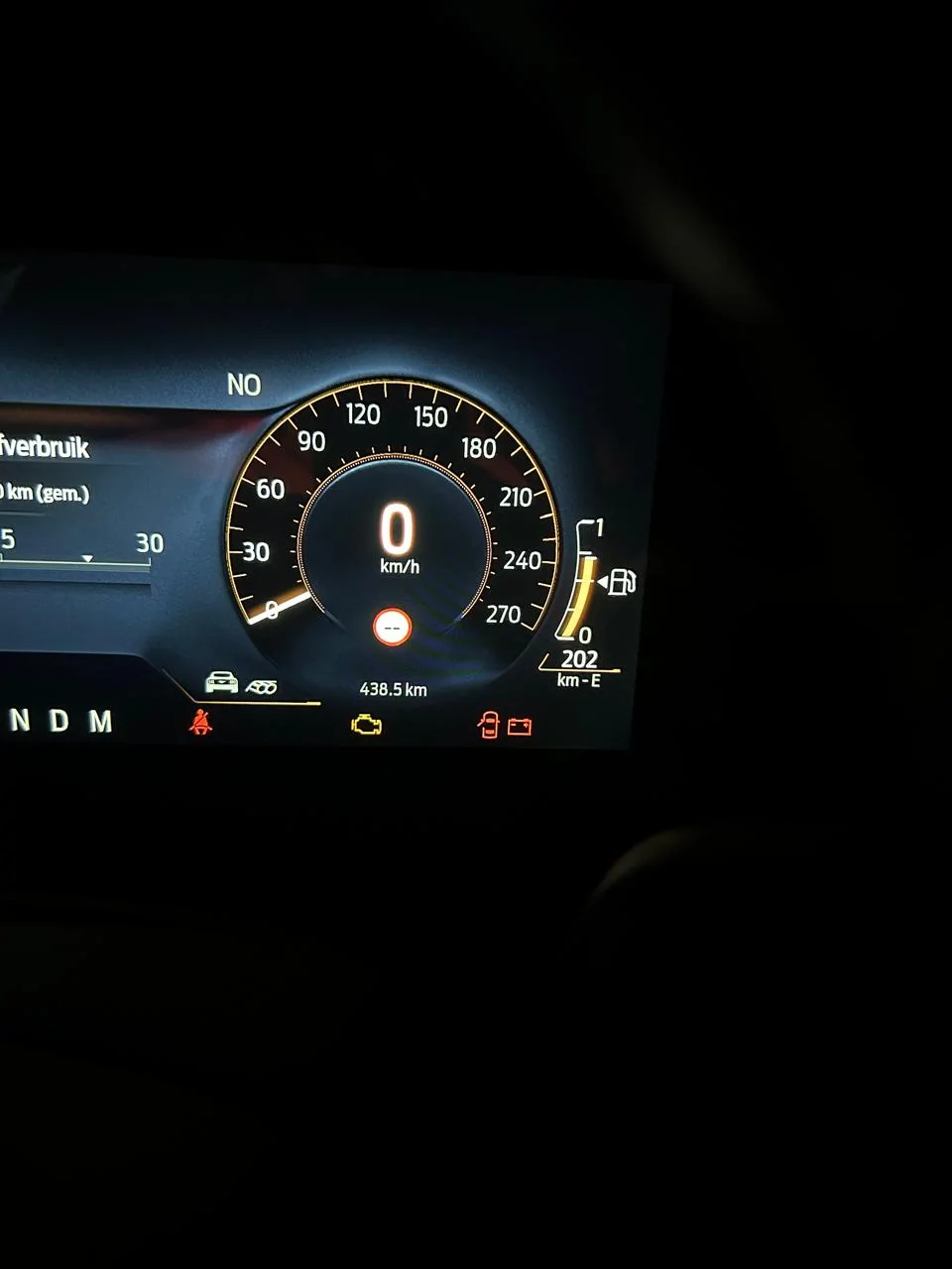

Yes, put everything back to the values you had.
That's the best to keep your car clear from mistakes.

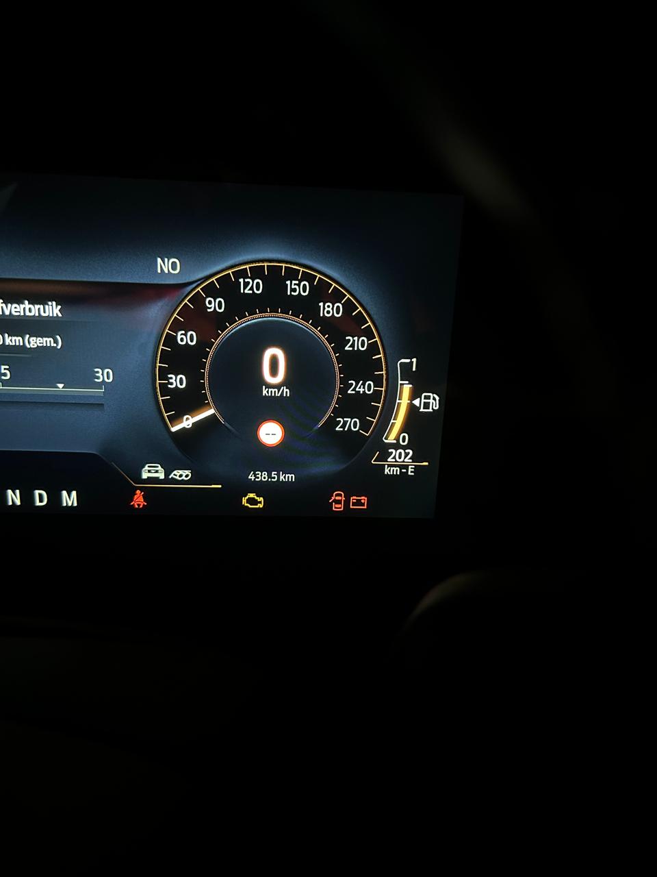

This is how mine was. It was centered.
But I changed my sign to Europe now.
Yes, it looked centered before and now in your Europe signs I can also see it a little bit to the left also, so it seems that's the way it works after a work is done with the lines of codes
The Europe sign is normal like that. It's on all Mustangs.

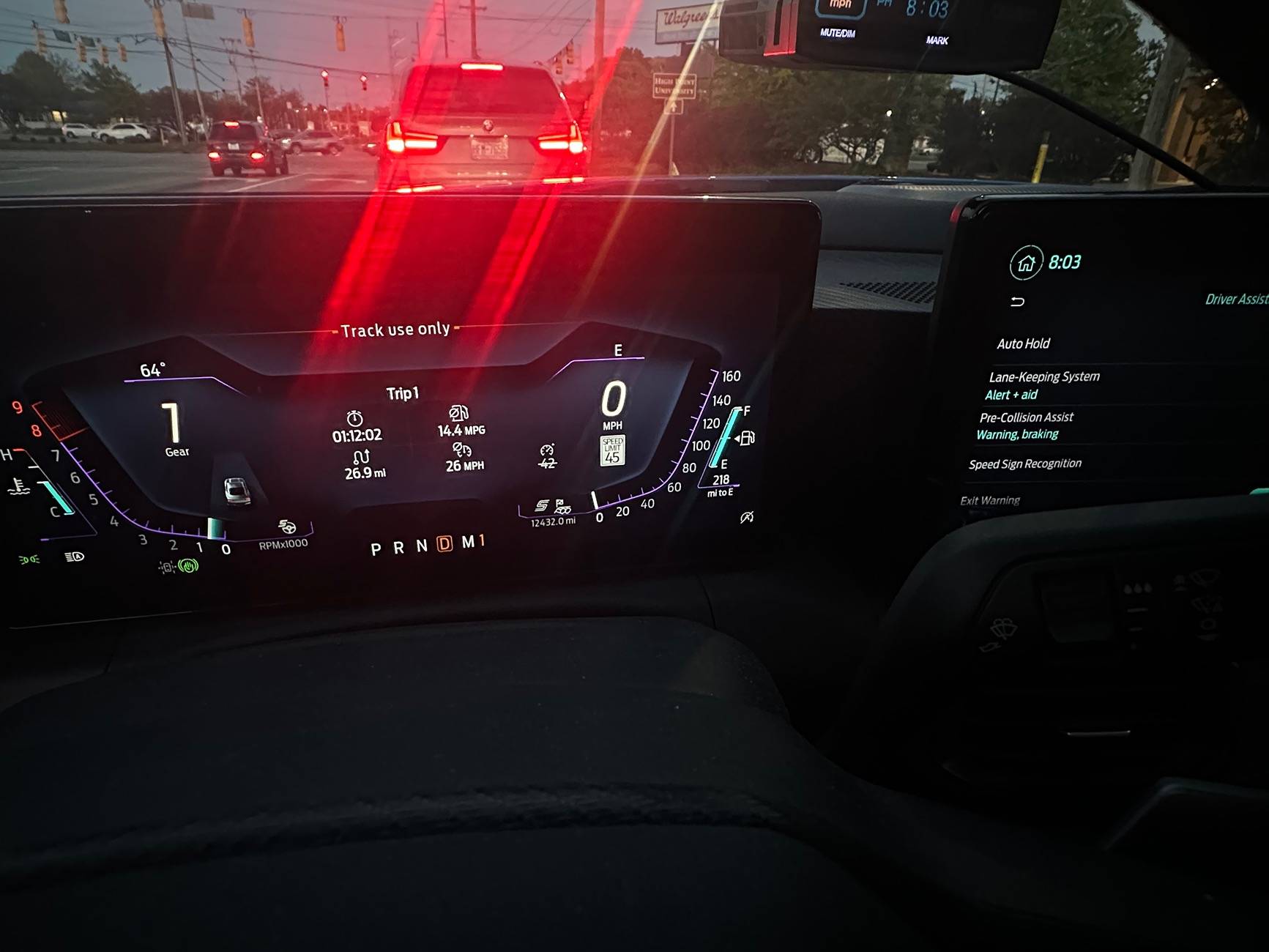

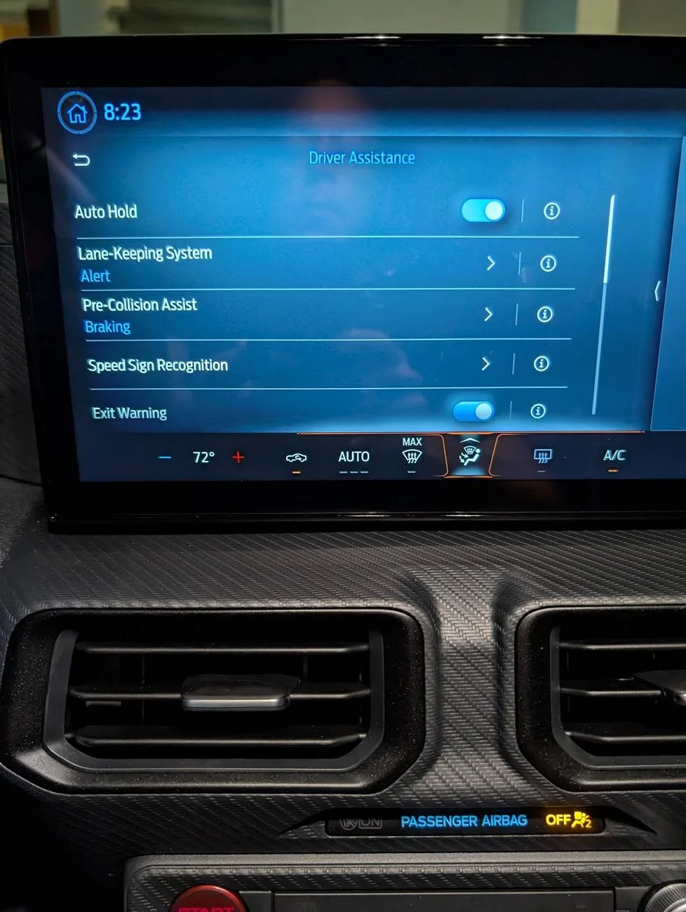

It is under Features- Driver Assistance and there I can see Speed Sign Recognition.
Okay thanks. I'm going to check again but I don't think I have that lol. But it's nothing that special in the menu. Have to find out what happened to give that menu. Cause mine works, just don't have the menu.

sky5oh
Apr 3, 2025
84
54
North Carolina
APIM
7D0-05-01 2186 xxxx xx--
7D0-09-02 xxxx x500 xD--
IPC
720-03-01 x1xx xxxx xx--
720-09-01 xxxx xxxx 9x--
IPMA
706-01-01 xx4x xxxx xx--
706-02-01 6xxx xxxx xx--
After changing all the lines in the 3 modules, go to the wrench icon and reboot the modules one by one IPC - IPMA - APIM.
Good luck and let me know if it works. If not, than probably there is no hardware in your car that can make this work.

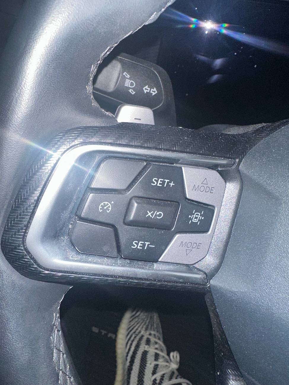

It worked thank you!! It’s absolutely wild that ford locked that way 🙄, now I highly doubt my last question is possible, but are we able to enable the advance lane keep assist even with us not having the buttons?
I' happy that I could help.
Without buttons enabling that I don't know. You might have to buy a new wheel.

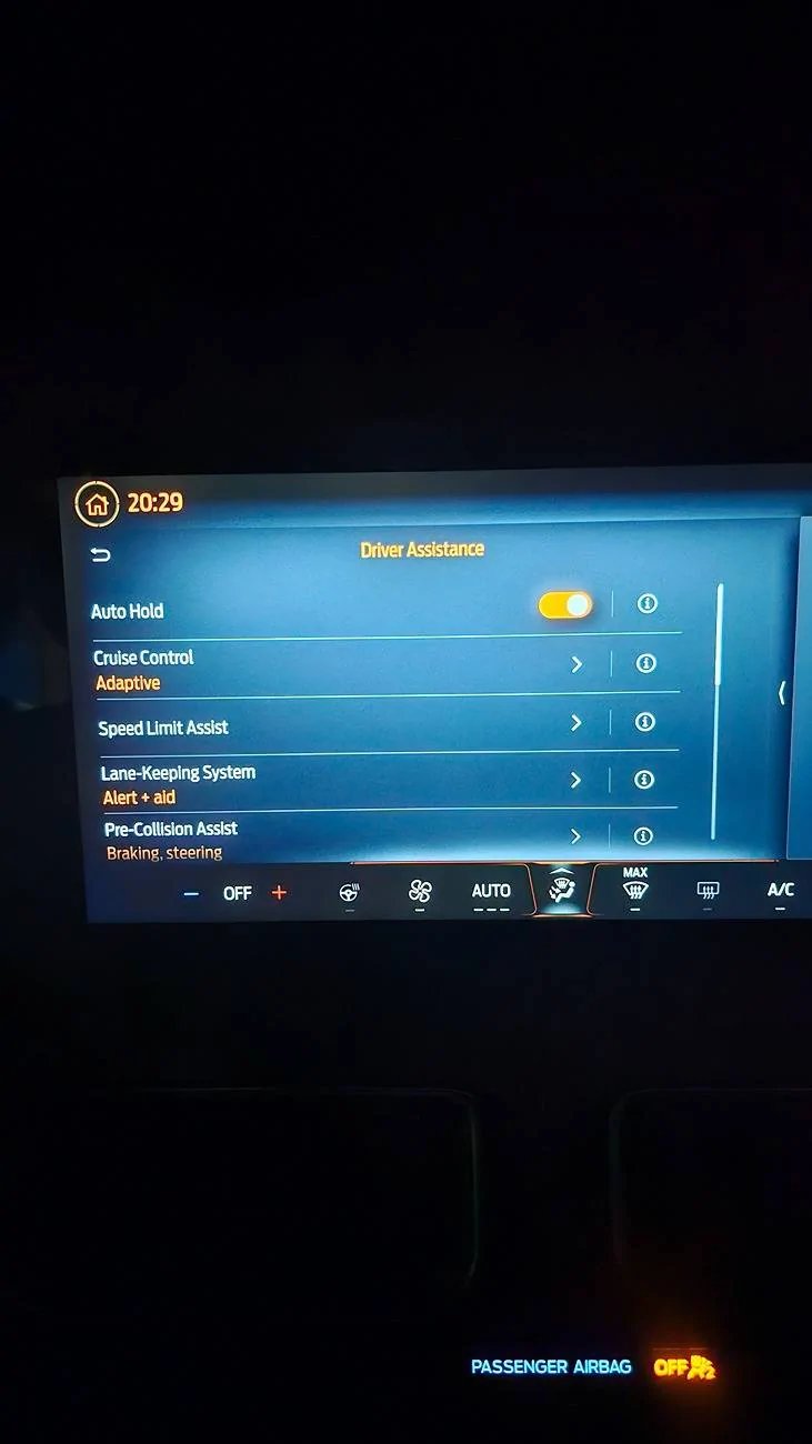

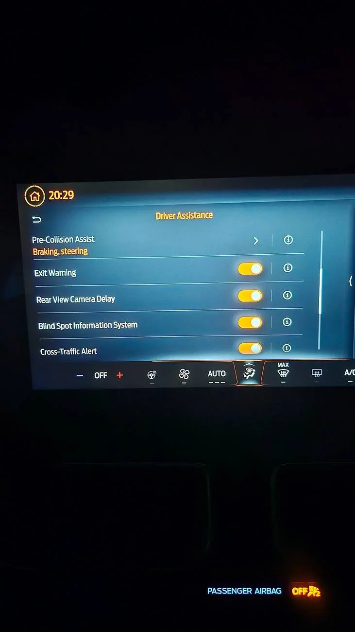

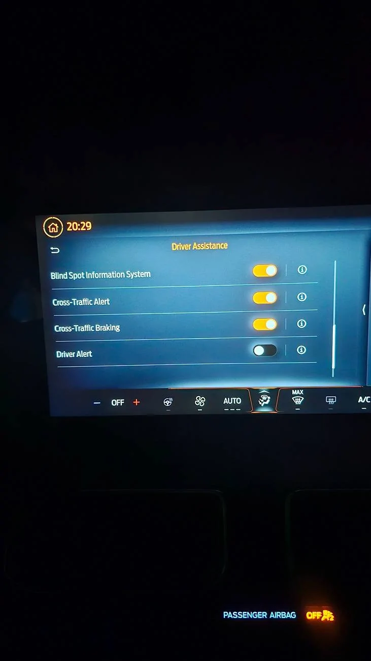

These are my options in that menu, no speed sign recognition, but I actually don't need that anyways since it doesn't give you anything extra. Only curious why yours showed up and not on mine since I have this option from the factory.
Honestly I don’t think that one will work just because I think there’s gotta be more advanced tech in it. But who knows. I wonder what would happen with just using the cruise control button with default advanced enabled?
