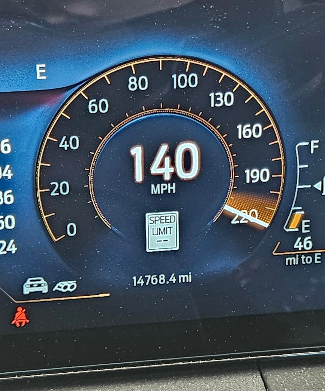

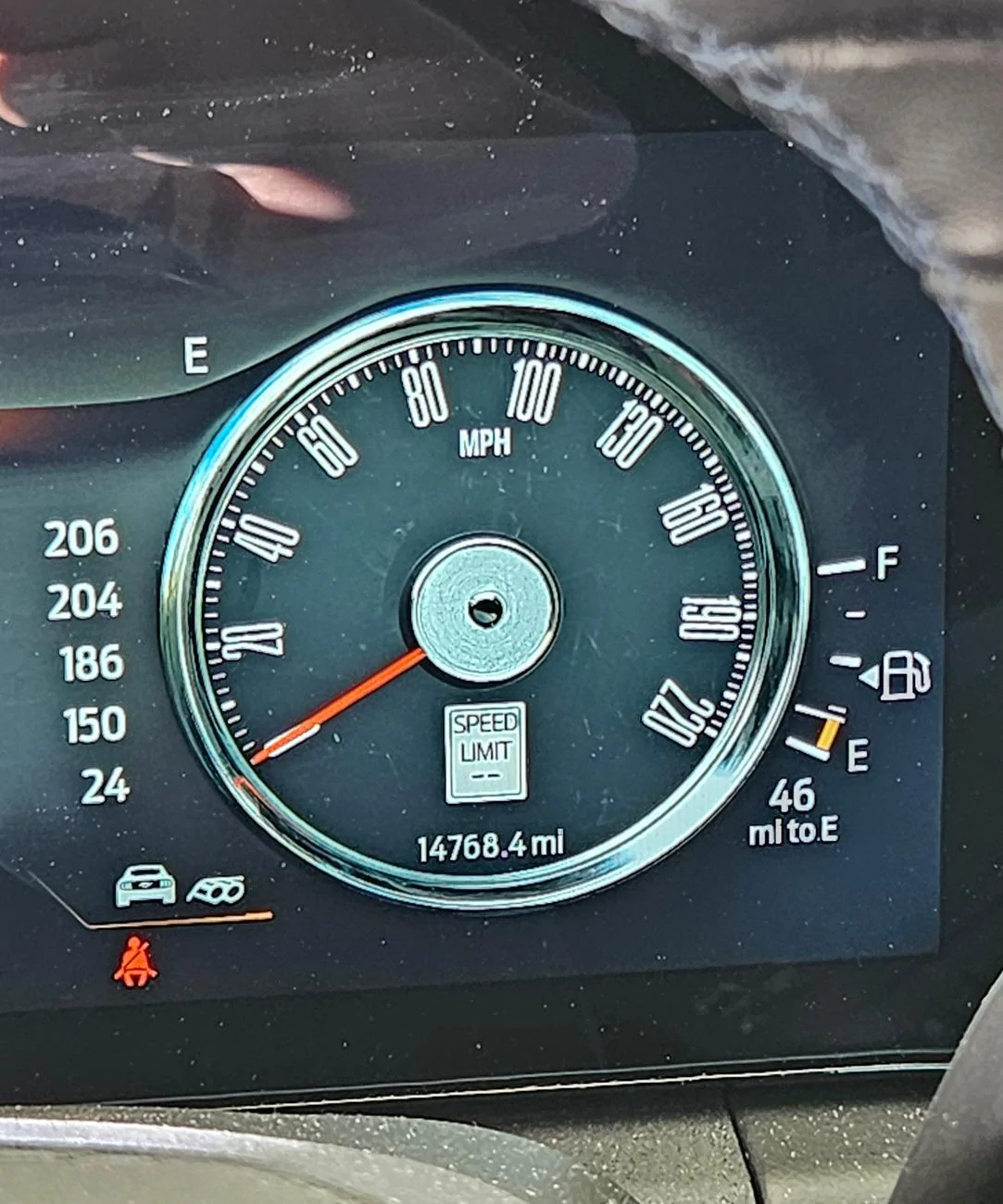

i did some experimenting today and found out 2 things
1. the "Classic" gauge cluster works with the 220mph speedometer
2. the 220mph speedometer is still broken and behaves like the 140mph (test done by controlling a parameter in the IPC) and does not work with the speedometer set to kmh
