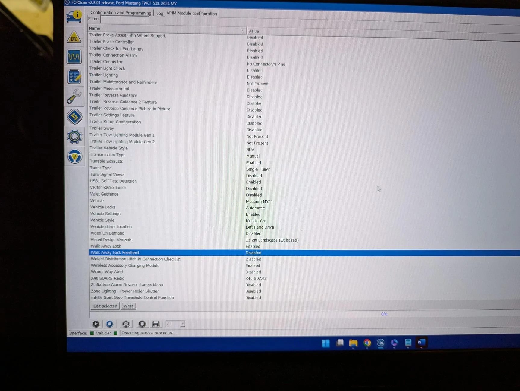

With the release of FORScan 2.3.61, I decided to do more than look around--which is all I did with previous versions. One note up front, FORScan recognized my DH automatically--didn't have to enter (or fake) a strategy code to get in.
To be certain, I'm a FORScan novice but wanted to enable the Walk Away Lock feature (not sure why this wasn't a default or even available setting when I bought my DH). But, no matter.
I also wanted to see what happened if I enable approach detection, which I did (I think?), but to no avail I'm afraid.
Attached is just a cursory look at what I found.

Certain changes should be done manually and not in "easy mode". It seems like FORScan is trying to enable the APIM toggle which don't currently work and there is no need for since WAL works whether that toggle switch is on there or not. As a matter of fact. it brakes WAL preventing it from working when you try to toggle the feature on and off.
Additionally, have you verified your BCM software is at the level it needs to be for this to work? If not, send me your VIN and I can check.

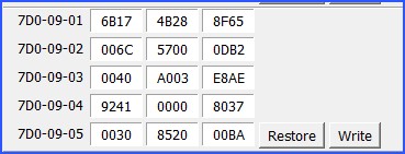

You do have the right software. Change this:
7D0-09-05
xxxx 0xxx xxxx
This will remove the toggle from the APIM.
@roadpilot When you did this to remove the APIM toggle for WAL, was that enough to get the feature to start working again? Read his posts above for context.

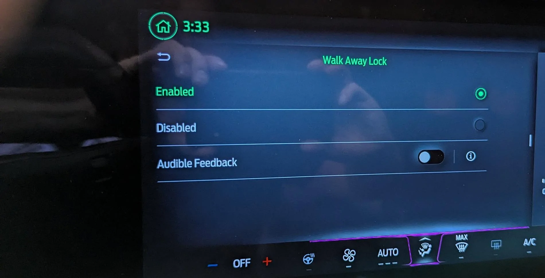

Success...WAL works. However, I had already edited APIM in "easy mode" and disabled "Walk Away Lock Feedback" Once I did, WAL was Enabled (tested, works perfectly) and the slide-button option in APIM display to enable "audible feedback" was gone.
Wondering if I should still edit " 7D0-09-05?"
Sadly, still attemping to get approach detection working.

I would do the edit. If you turn it off on the touchscreen, you won't be able to turn it back on.
As far as the approach detection, I am not sure if this can be done on these cars. They are still very new to me and I'm learning.
Edit: I would wait for roadpilot to respond as he tinkered with it himself and I am just going by the convo I had with him.

Just a note, I made the edit to "7D0-09-05" and it broke WAL--setting disappeared from display and lock function stopped working. To remedy, I repeated my steps in "easy mode" and restored the display and function (it locks as I decrease proximity but no audible honk). Going to quit for the day. Again, thanks a bunch.
