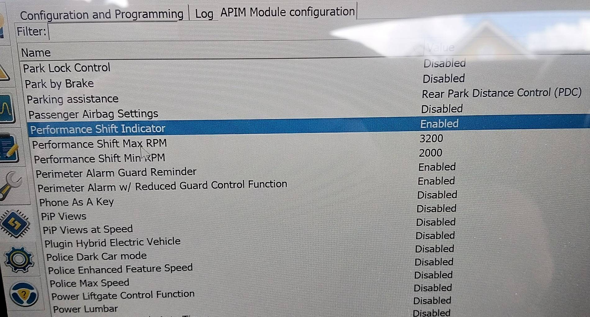

Hey @So0_NaSTy and @roket could you share how you got the performance shift indicator to work? I used easy mode to enable the Performance Shift Indicator in the IPC and APIM modules but got the same error as So0_Nasty did.
See pic of APIM config for ref.

in the IPC there is both "Performance Shift" and "Performance Shift Indicator". its one of those that needs to be enabled, but enabling both doesnt do anything bad

That could be the issue I didn't enable "Performace Shift" in the IPC, just the "Performance Shift Indicator"
Do you know what function the Performance shift Max and Min RPMs settings perform? They were set at 3200 and 2000 from the factory and I wasn't sure if it was wise to change them.
2,689
4,076
you dont need to edit those, but if you do, those are better off edited using the as-built data. just know that, even if you get the slider to go past redline, the actual shift indicator itself will not render past redline no matter what. i changed mine to max out at 7800 RPM for when i eventually get the Whipple stage 2 kit, but it doesnt go past 7500

Thanks again to @roket that did the trick! In case anyone in the future has the same issue easy mode in Forscan did work.
You need to select in the IPC module "Performance Shift Indicator Enabled" and
"Performance Shift Enabled"
In the APIM module you would select:
I didn't change the Max and Min RPM values (APIM) and had no issues just like roket said.
